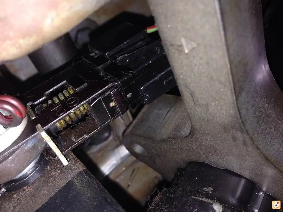

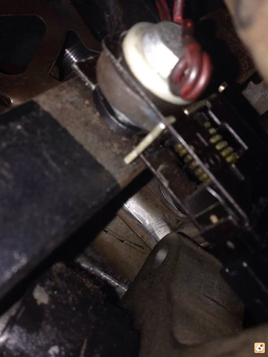

yesir I am taking the car to work today so I an get it for yaHey jeff when you get a chance could you crawl under your dash and snap some pic of how your brake switch is oriented mine gets wedged if i press the brales to hard and it will lock the brakes if i press it to hard @TOOLOW91
they were all pretty shots of the bracketwheres the other 39?

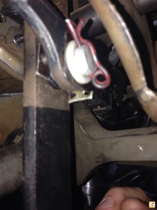

yup , if the pin isn't in it right and half moon isn't oriented right it will do what you are having happened I had the same issue when I first did my stick conversion and no brake lights cuz it kept fallingOne last question how is yours oriented on the plug side just do a straight on shot like that which shows the backside of the plug
you sure your not missing the white Teflon spacer that's there to keep the pressure on the whole assemblyyeah well the brake lights come on but if you push the brakes hard enough the switch will start to fall down between the pedal and the steering column. oh so if the red pin isnt placed like you have yours it will stay still
