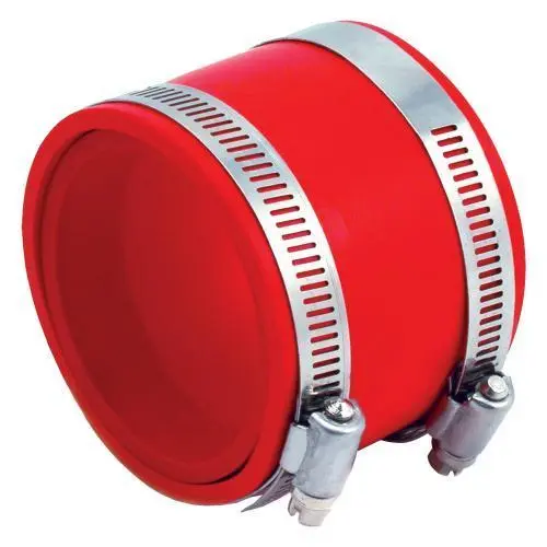

  5. maybe @84Ttop may no . does anyone no where I can get black couplers for the discharge pipe on my blower to replace the blue that doesn't match in my engine bay ?
  6. or even red ?
  7. Correct me if i'm wrong... are they 2 3/4" id?
  8. I think so but I am not sure I am gonna have to measure . the blue has to go though my
    OCD is kicking in .
