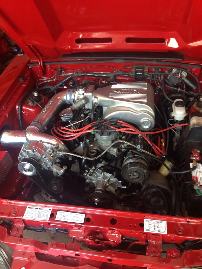

  2. So today's run down is I pulled the intake cleaned the heads and intake spotless
    Flipped a hose a had backward , installed a u shaped hose for the bypass instead of the ghetto cut hose I had back there .
    put it all back together , went and picked up the rad , tomorrow I'll install that and the hoses and burp this baby . also gives the permatex time to cure like a rock before fluids get to it
  3. oh and I need to vent the pcv completely because I am already getting in oil in the intake . yee haw . I may just leave it like this for now to not have it all over the engine bay until I do a catch can setup

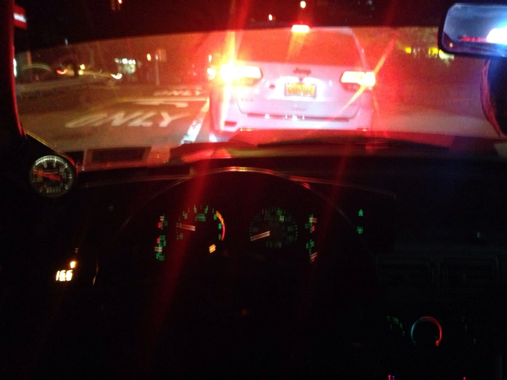

    This with a 160 outta help it cool a bit

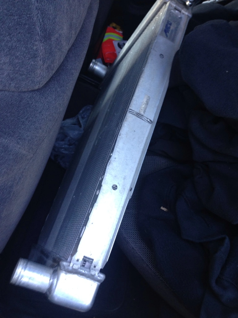

  5. So the afco didn't work out being that it is more of a universal radiator . the upper hose won't clear the blower and the fan shroud won't fit right so my buddy is gonna take it back no issue . I just re ordered the mishi moto

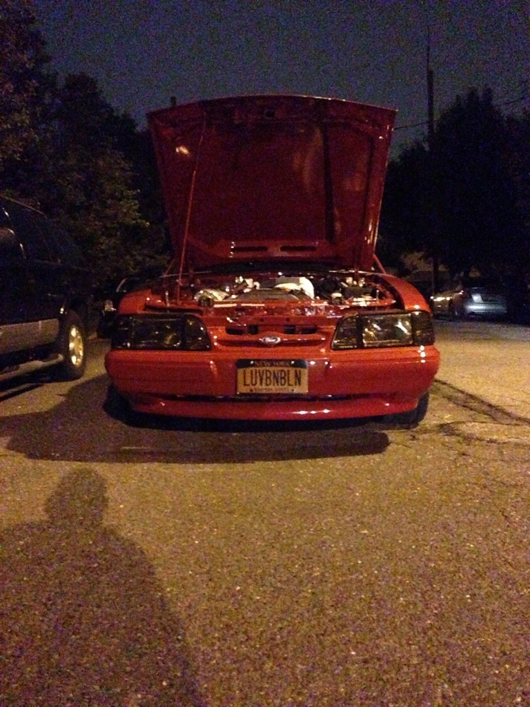

  6. ImageUploadedByTapatalk1402468241.406610.jpg Out for a ride tonight

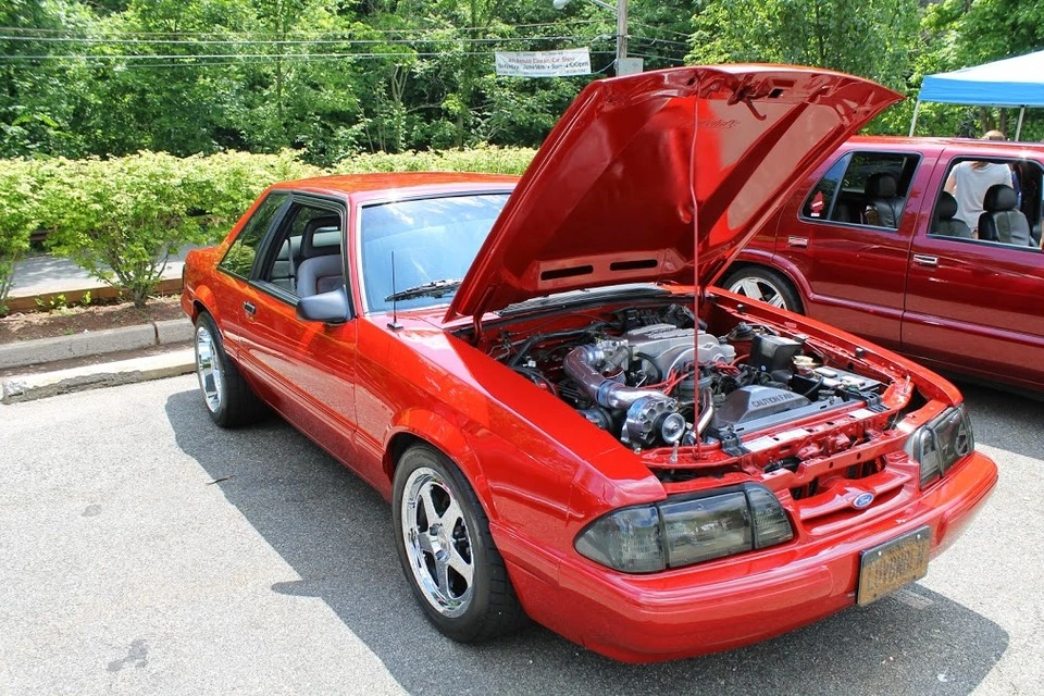

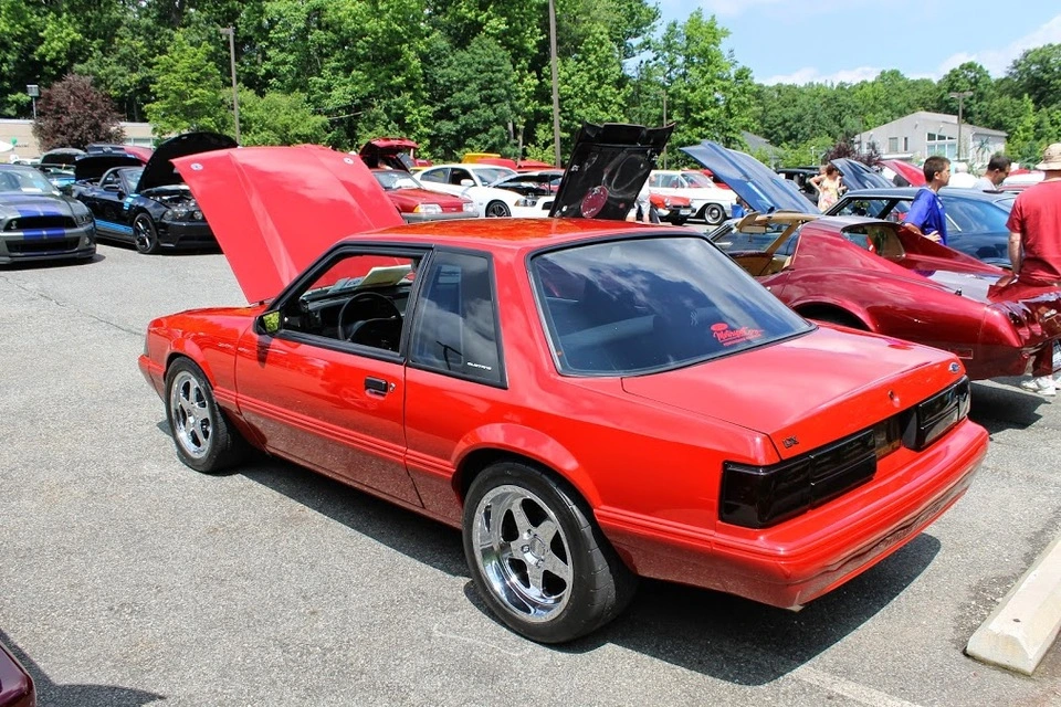

  16. Thank you so much boys . Cruised to a local show today good 50 cars about 20 mustangs took second place ImageUploadedByTapatalk1402778955.437824.jpg
  17. Congrats! 1st place must've been something to beat your car.
  18. Those are some HQ shots.
