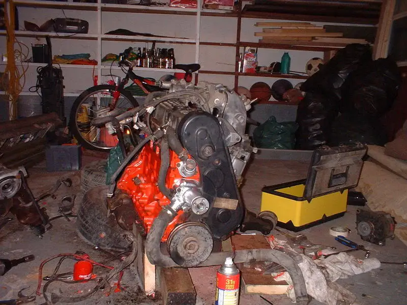

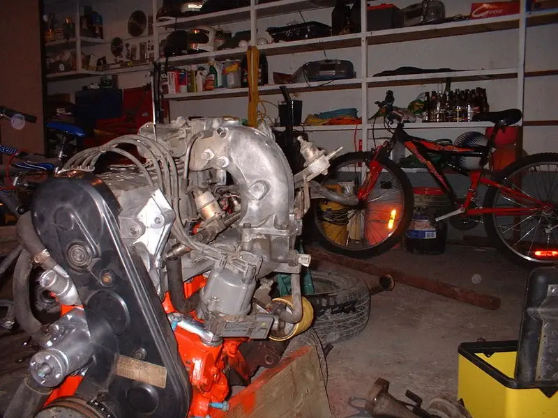

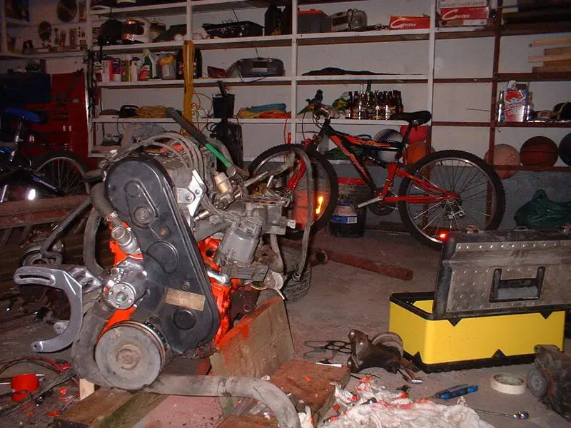

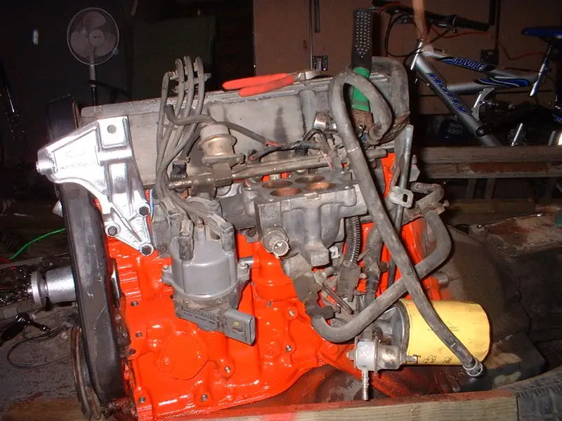

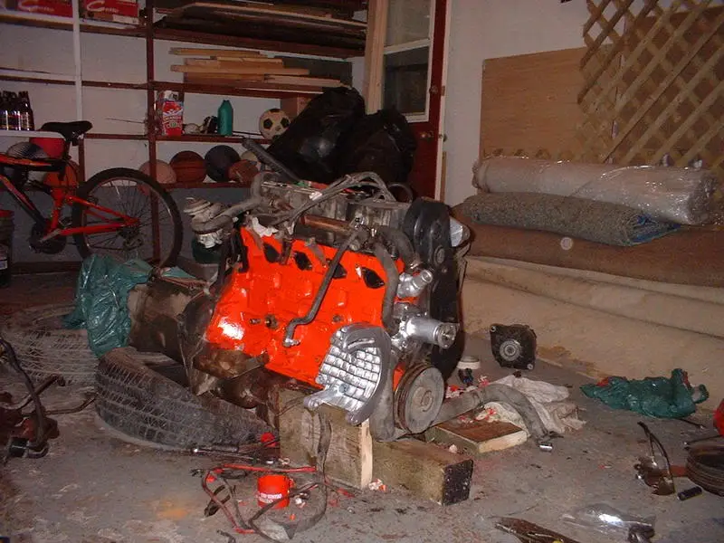

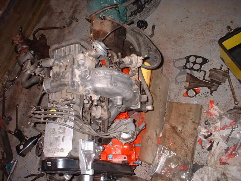

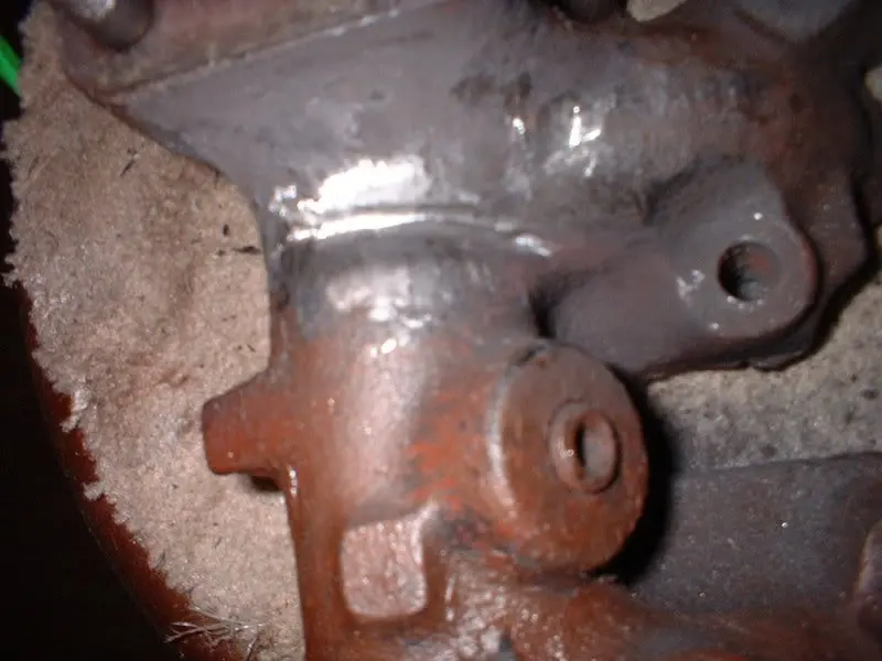

    This is as far as the engine is now, just have to remove the turbo from the manifold, drill holes at the end of the crack and cut a V grove in it, get it welded put it on and its ready for the swap

    this brings me back to when i did my merkur swap. mine wasnt that dirty though LOL be prepared to fork out to rebuild it. i spent about a grand rebuilding mine. i picked up a complete merkur (not running, needed a little time, and smarts)
    its lookin good! keep us updated on it!
    jeff
    PS i have an E6 manifoldyou just pay $30 plus shipping (i assume about 15 bucks) and its yours.

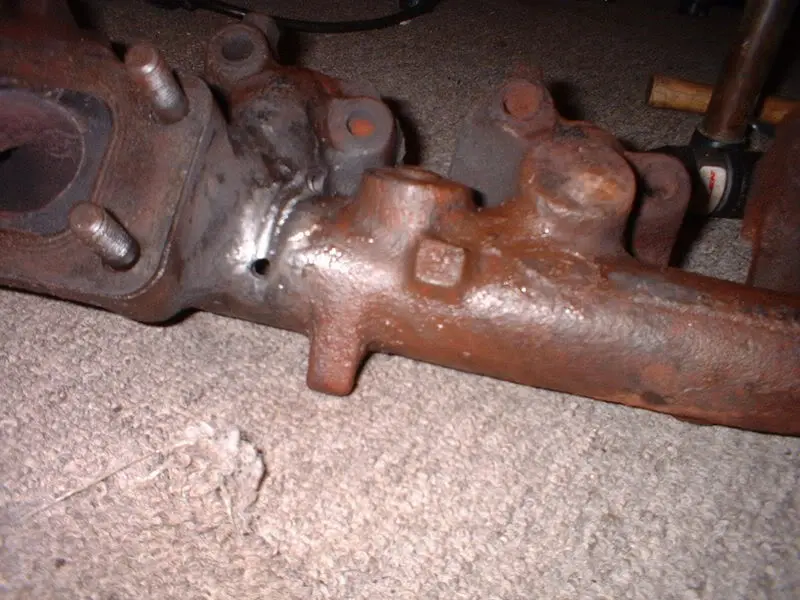

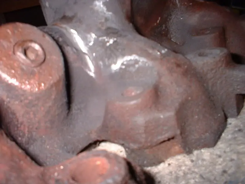

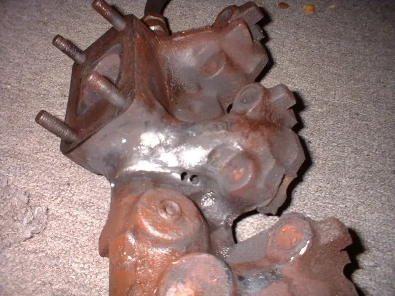

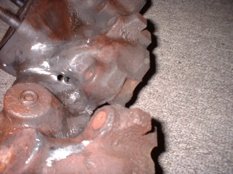

    ****!!!!!!!!!!!!!!!!! I guess that crack in my manifold is bigger than I though. Its ****ing HUGE!!!! I had to redrill a hole (as you can see) because it just kept going...

    Now are you sure thats an E6 manifold?

    Its an E3, I went on stingers site and he called his an E6 and it looked the exact same as mine so... my bad lol

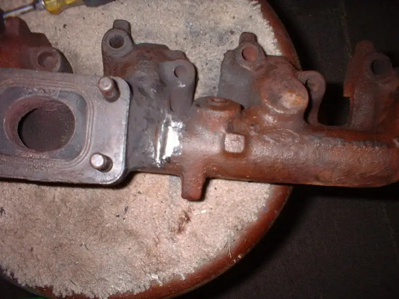

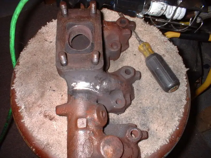

    Ya, the E6 has a little more meet around the area where your manifold is cracked. Just get ready for it to crack again...probaly sooner than later. I would take up hyperse7en on his E6 before I tried using a welded up E3.

    I would take him up but I'll be upgrading to a bedder one this upcoming summer so I'll just wait for now, plus the engine will be stock for now as well because snow + power = ditch
