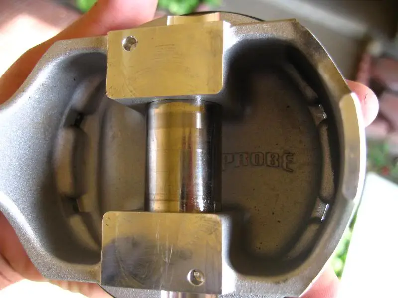

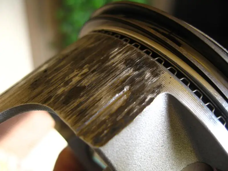

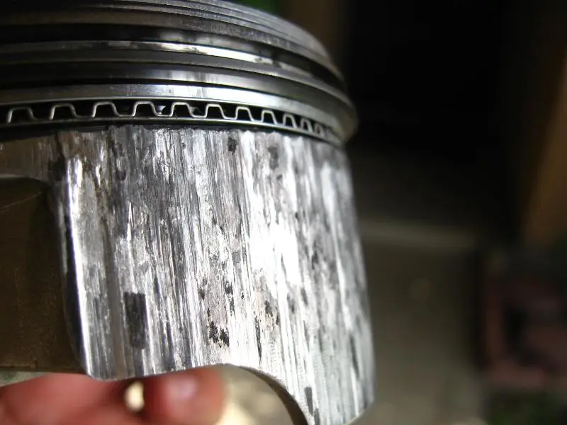

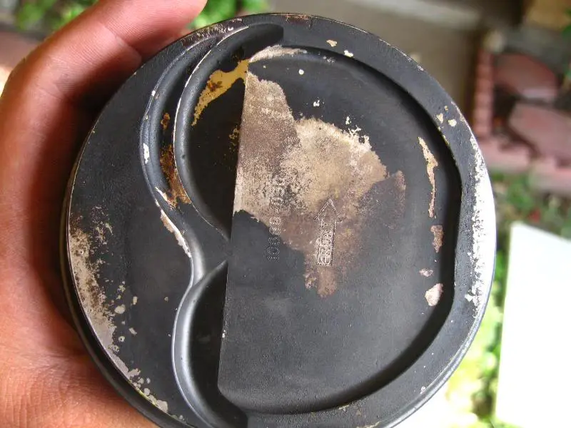

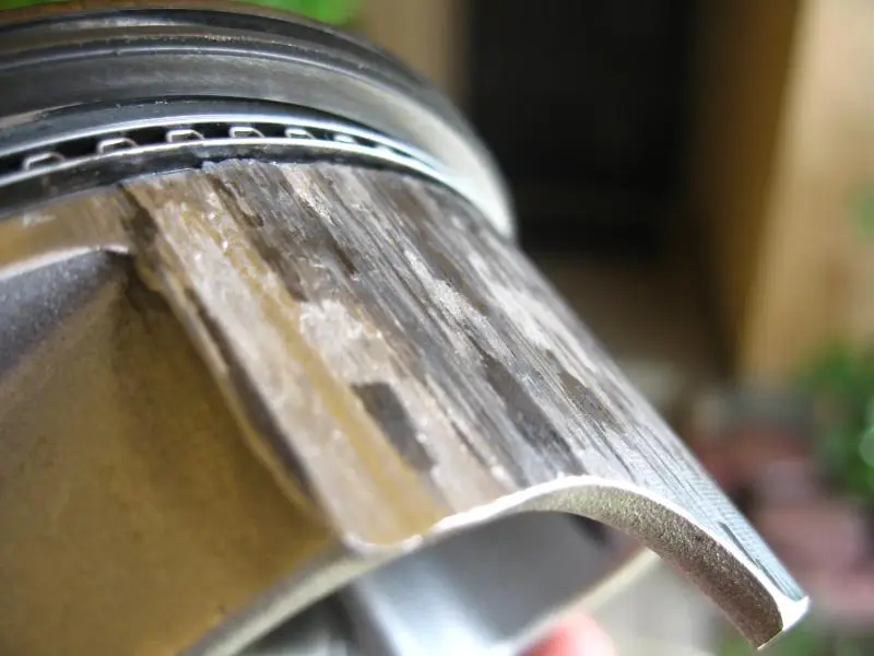

  5. Ok I pick up my motor on monday, it had two blown pistons and one scared cylinder wall which L&R Automotive in santa fe springs said it would hone out, they replaced two pistons I got new rings and bearings with a re-balanced rotating assembly for $900.00 he promissed it would be fine now and to have it re-tuned because he said that it didnt seem to be a build issue with the motor, Steve powertrain dynamics had tuned it so im going to have him look at it, he has too good of a reputation around here so I think im going to let him re-tune it unless there is somebody better that anybody knows about here in southern california... While it has been down I had the headers ceramic coated, PS and ALT brackets powder coated in xtereme chrome along with my C&L inlet tube and changed my hyperblack saleens for chrome saleens, Im hoping to be rolling again in two weeks.

  11. He thinks it was a problem from the day I started it because I had 2 dead injectors and drove it about 80 miles that way which would mean it ran lean I suppose, Hes changing out one other piston that isnt scored up but didn't mic out to his specs so we'll change it now to avoid future problems.

  12. wow that piston is jacked up !!!!!! Im glad you finally figured out what it was though.
  13. boy i hate seeing carange like that
  14. That doesnt look like detonaton to me...I had motor lean out and it made holes in the TOP of the pistons, not tear up the skirts...There was no oiling problem was there? What about junk on the walls/in the oil? The ring lands are not even FUBAR...I think there may h ave been something else going on in there...Did it overheat or get real hot?
  15. Wow man, that sucks. I'm siding with squeeze here, that doesnt look like leaning damage, if the top of your piston was white or melted. that looks like an oiling issue or possibly a tolerance issue (piston too tight or too loose) . Thats really odd damage.
  16. My thoughts exactly! Oiling or tolerances...
  17. i second the last 2 motions! lol
  18. yeah that looks more like sand in the oil or no oil at all or something like that.
    pretty weird
