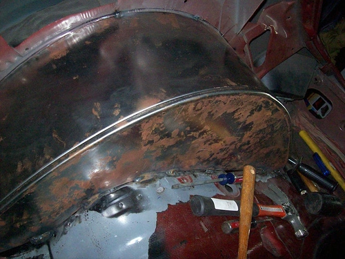

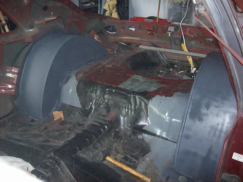

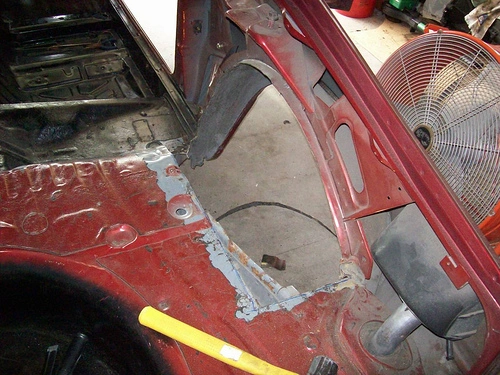

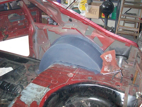

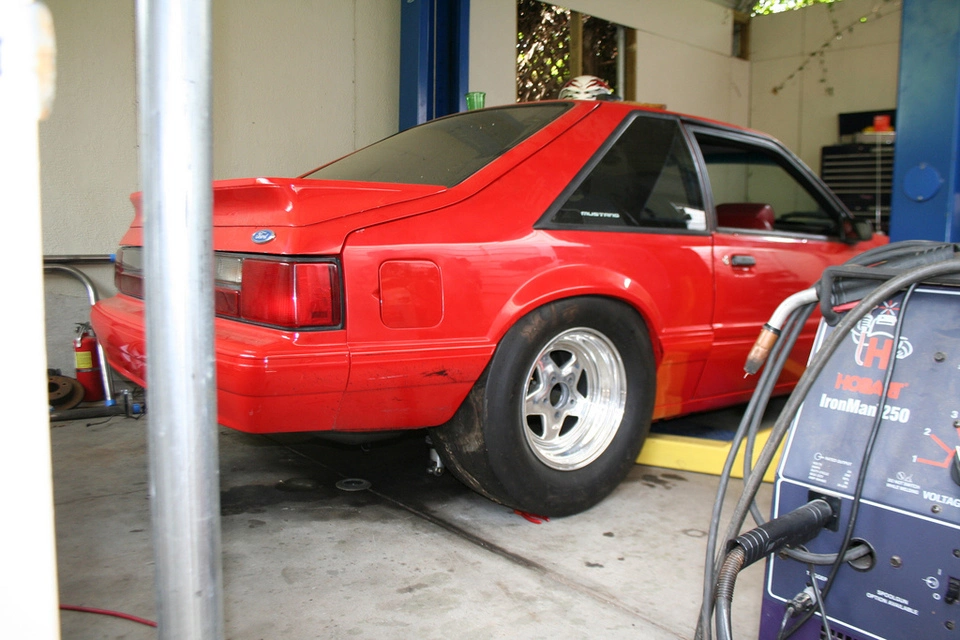

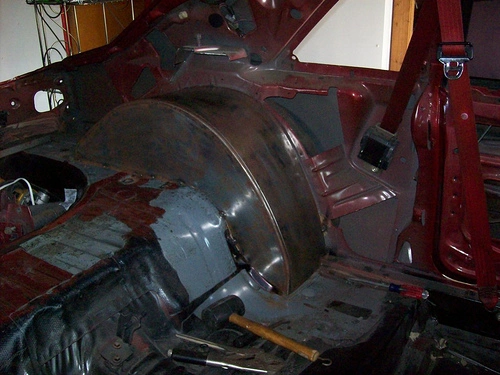

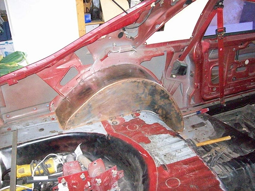

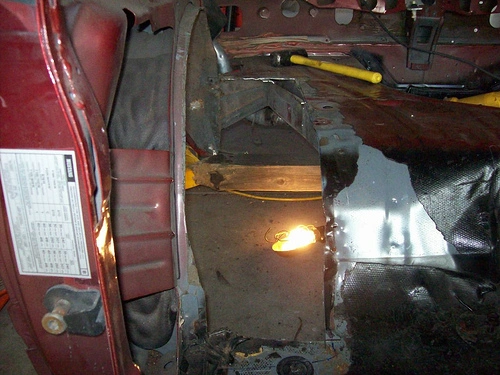

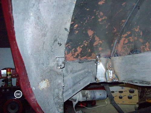

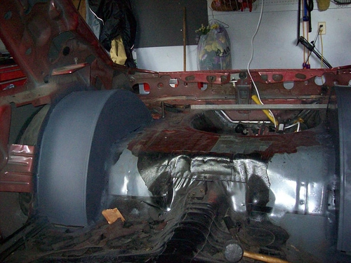

  12. done with the exception of welding completely but there in and partly welded in
  13. WOW, that is a lot of work, but fun to do and worth the effrot when it's done. You need to get pics up ASAP when you get the meats under there.
    You should get some 18X12's with a 345 when it's done just for chits and giggles. A low profile street tire for looks will be killer.:D

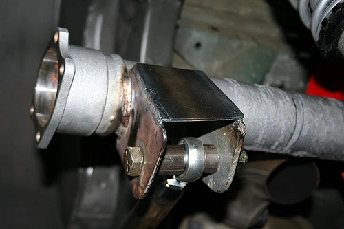

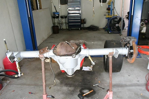

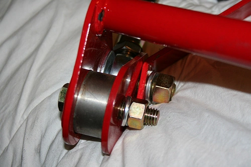

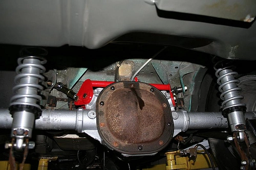

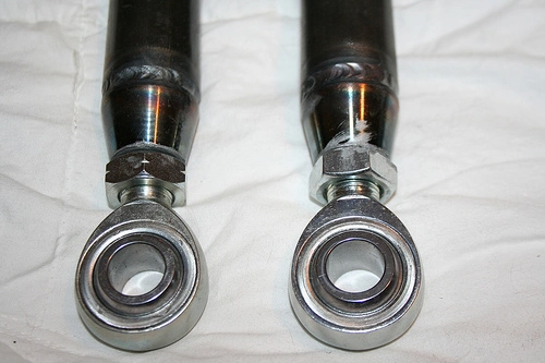

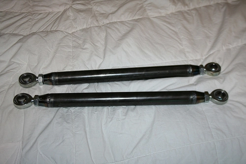

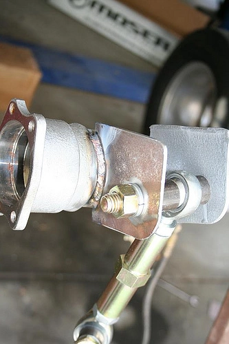

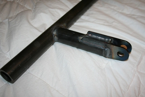

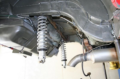

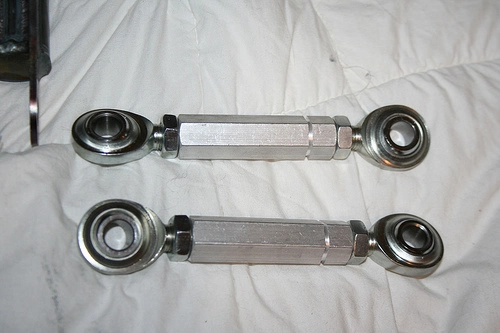

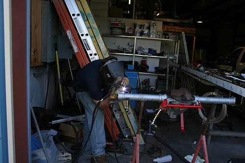

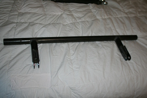

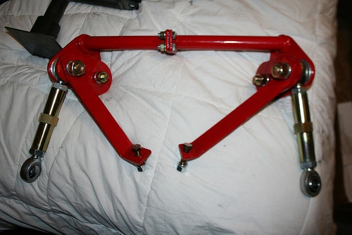

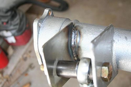

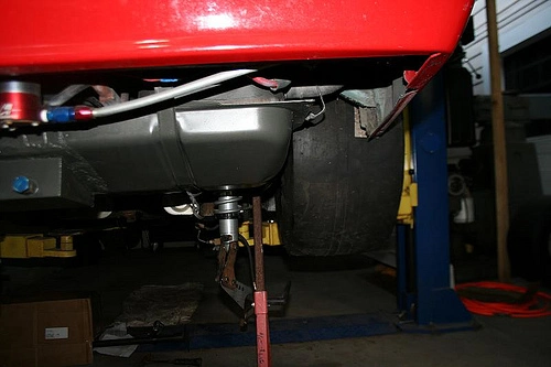

  16. New Rearend and Suspension Progress Thread

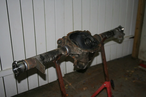

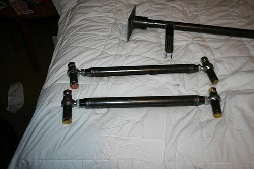

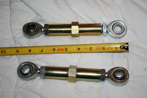

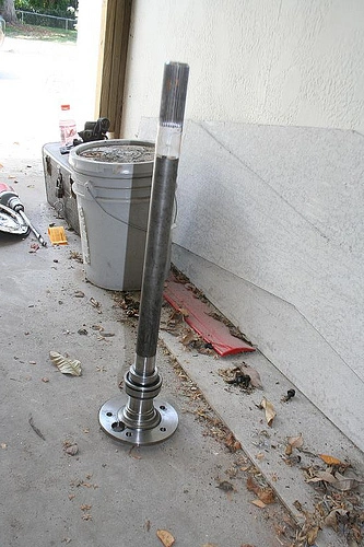

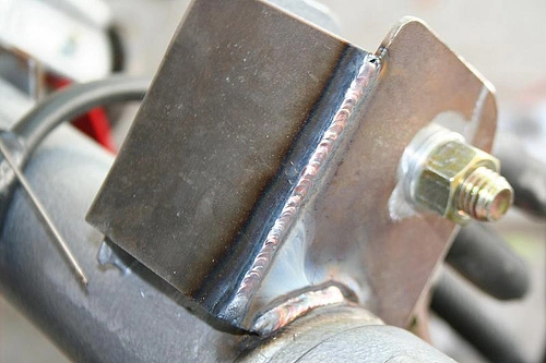

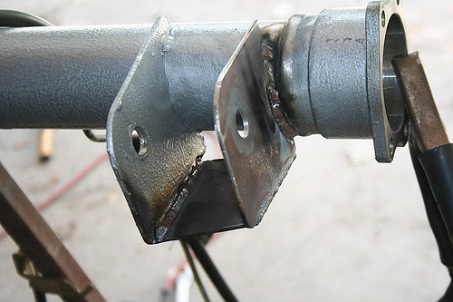

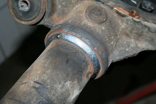

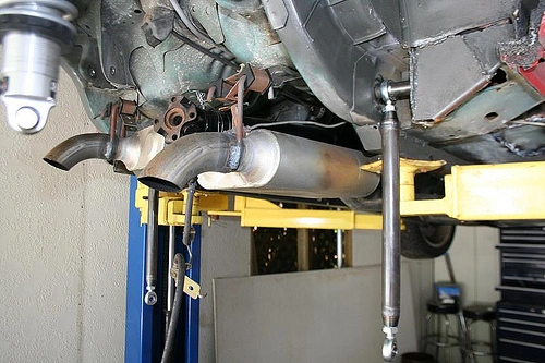

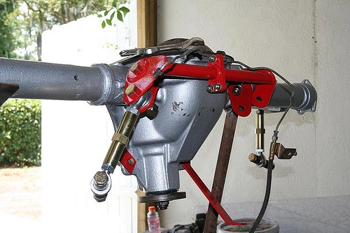

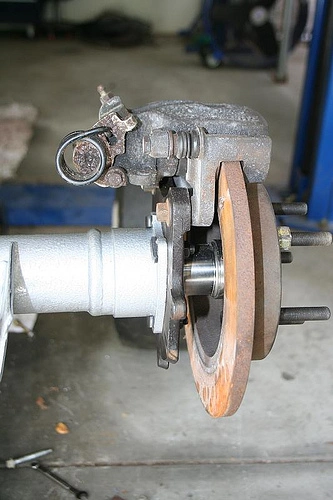

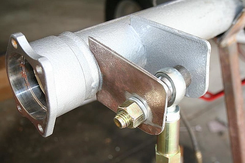

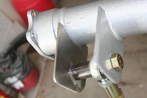

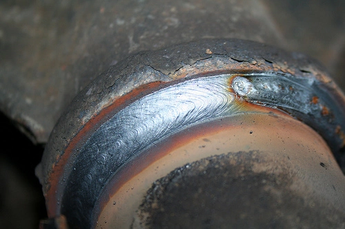

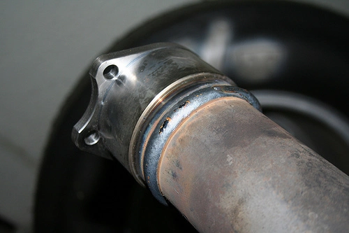

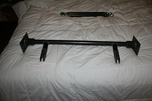

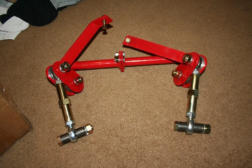

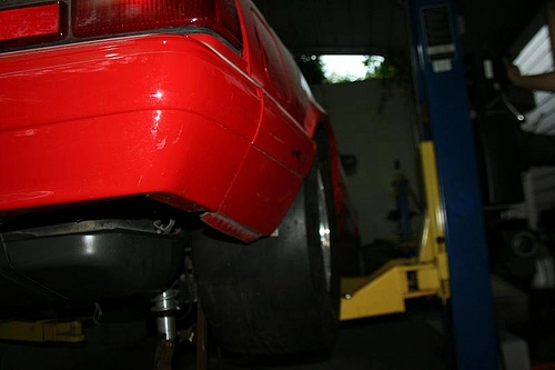

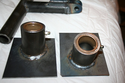

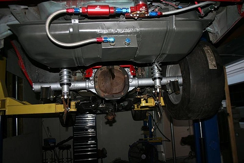

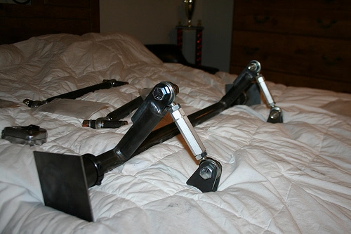

    Ok its been a while since iv been able to do much to the car since everyone takes so long to do my stuff. I got all my rear suspension parts which consist of : Offset Lower Control Arms, Relocated Uppers w/ Support System, Anti-Roll Bar (all 5/8" Hardware instead of the Stock 1/2"). For the new rear end its a 1990 5.0 Housing, shortened 5" total (2.5" per side) Moser 35 Full Spool, Moser 35 Spline 9" Custom Alloy Axles, Moser 9" Housing Ends. It took so long to get all this stuff done, either they told me it would be done at a certain time but it would take a week longer, or the would ship me the wrong stuff (Moser). The only good experience i had was with my Suspension company (Baseline Suspension - Awesome guy to deal with) their products are amazing, and the quality is the best iv seen. He has answered any question i had so far. Well enough talking here are the pictures. There is tons of them so be patient.
    DANG - took me 30 mins to post all these picture, lol.... Let me know what you guys think of all the progress. Thanks.
    -AJ
  17. Nice welds. Nice parts. Remind me to never try and race you!!:nice:
  18. HA.. Thanks man, just because i got all these parts doesn't mean I'm fast. My best is only 11.24 @ 121, but thats spinning all through 1-2 gear, worn down ET Streets and when the car transfered to the back it would bounce on the back tires. I'm hoping for 10.80-10.90 on motor and 9.XX's on juice!!!! If i can ever get all this stuff done. Still have to weld coil over brackets on and weld the Anti Roll bar on.
    -AJ
  19. Dang, nice set-up! Those welds are impressive for sure. Nice work.
