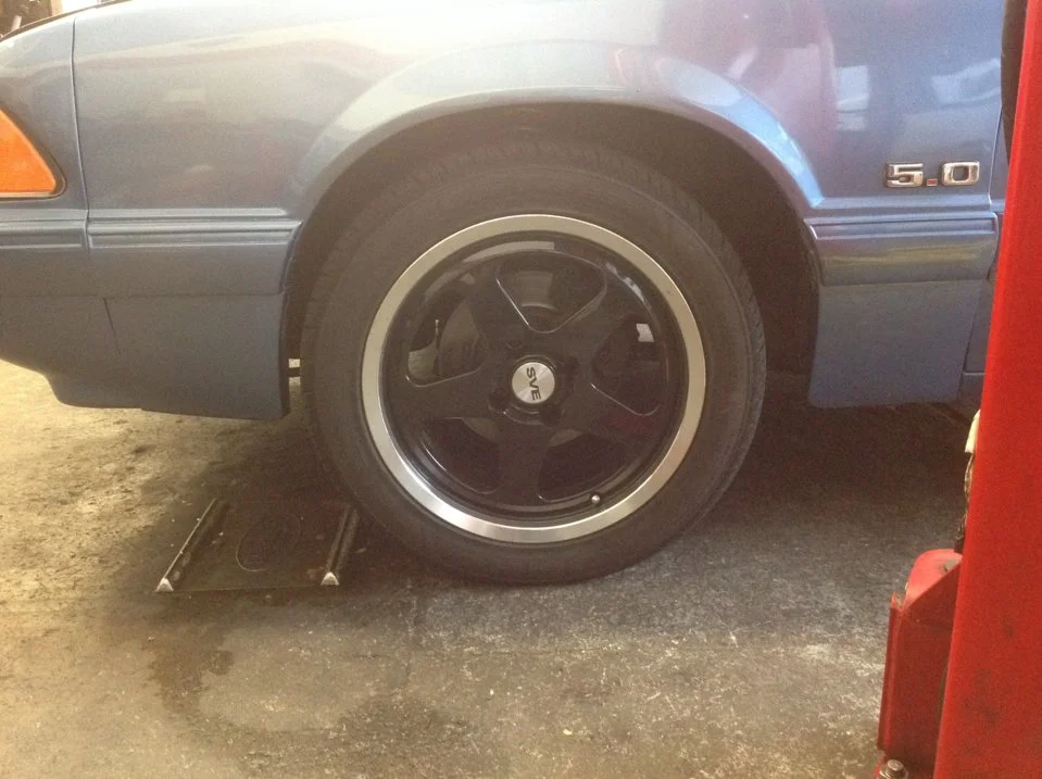

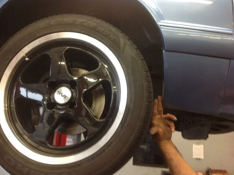

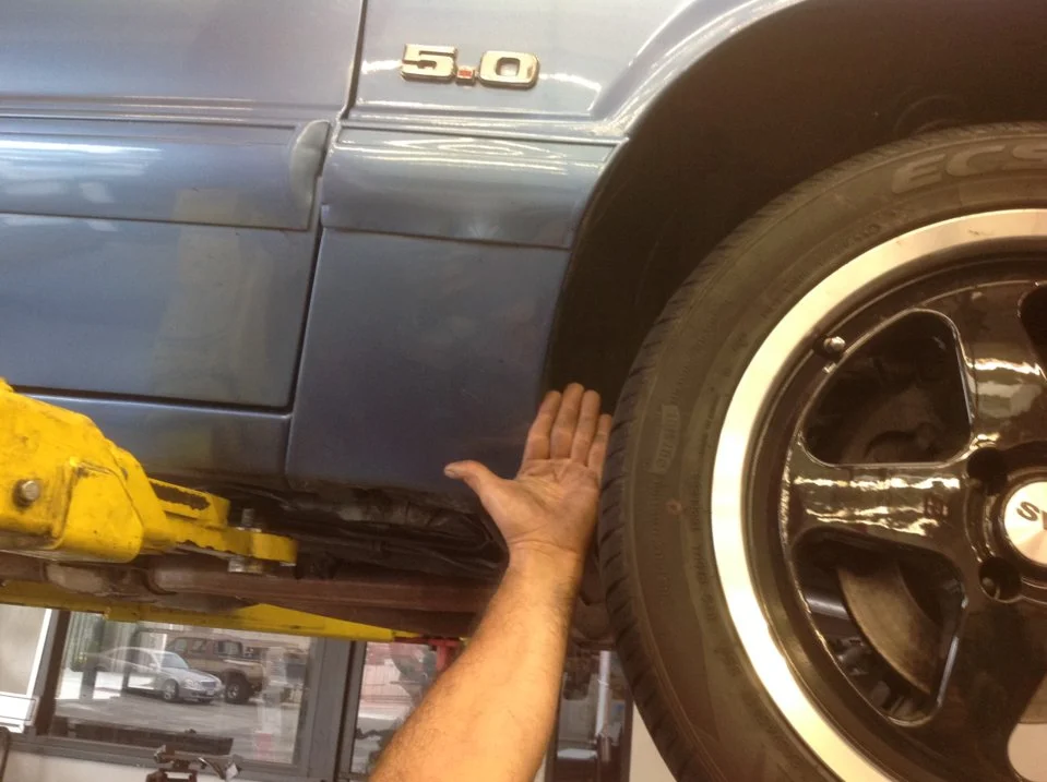

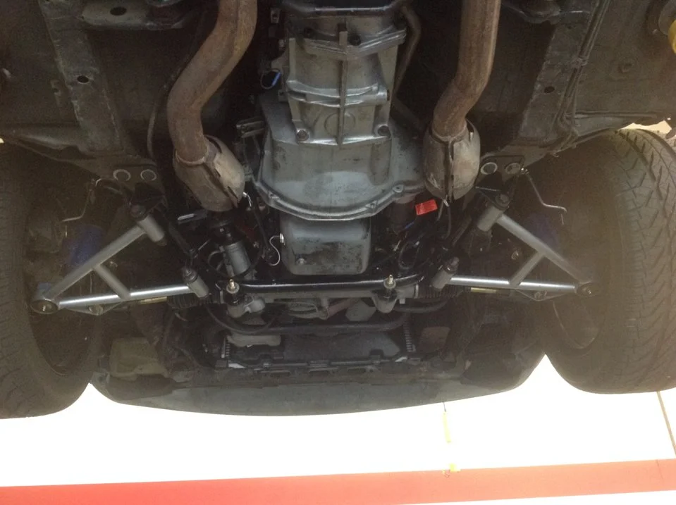

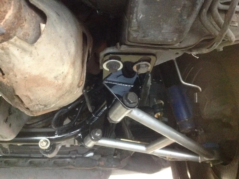

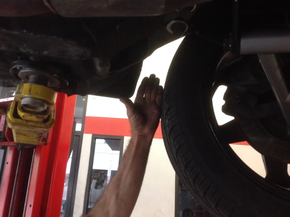

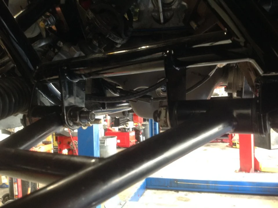

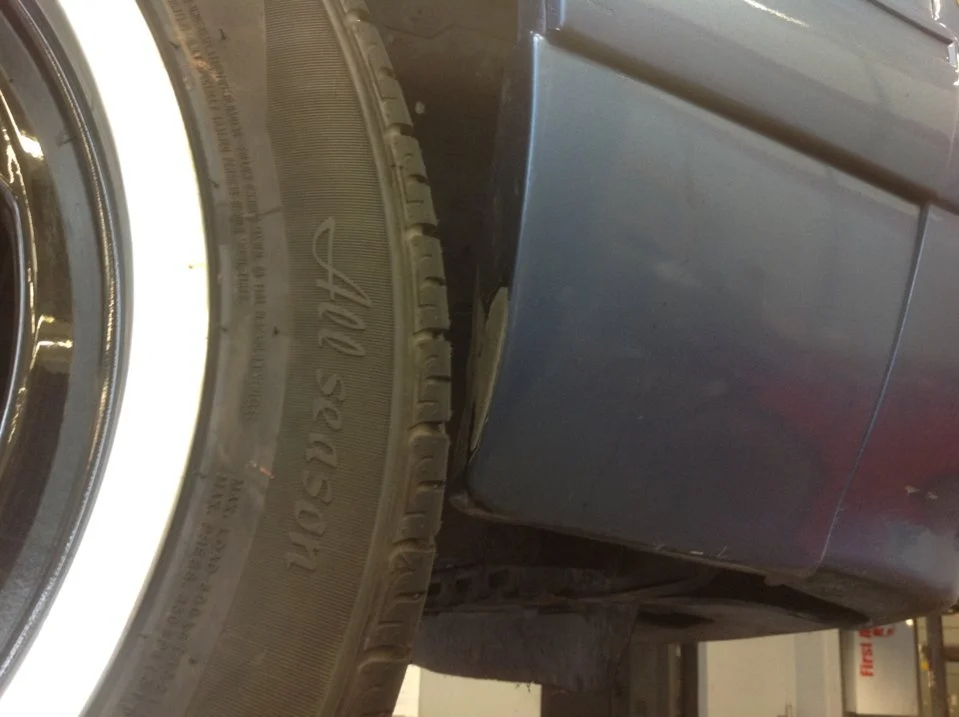

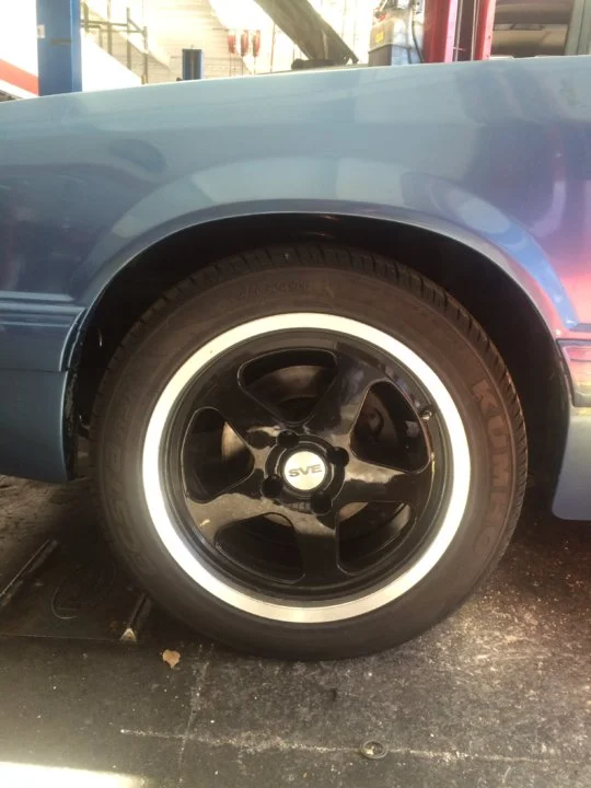

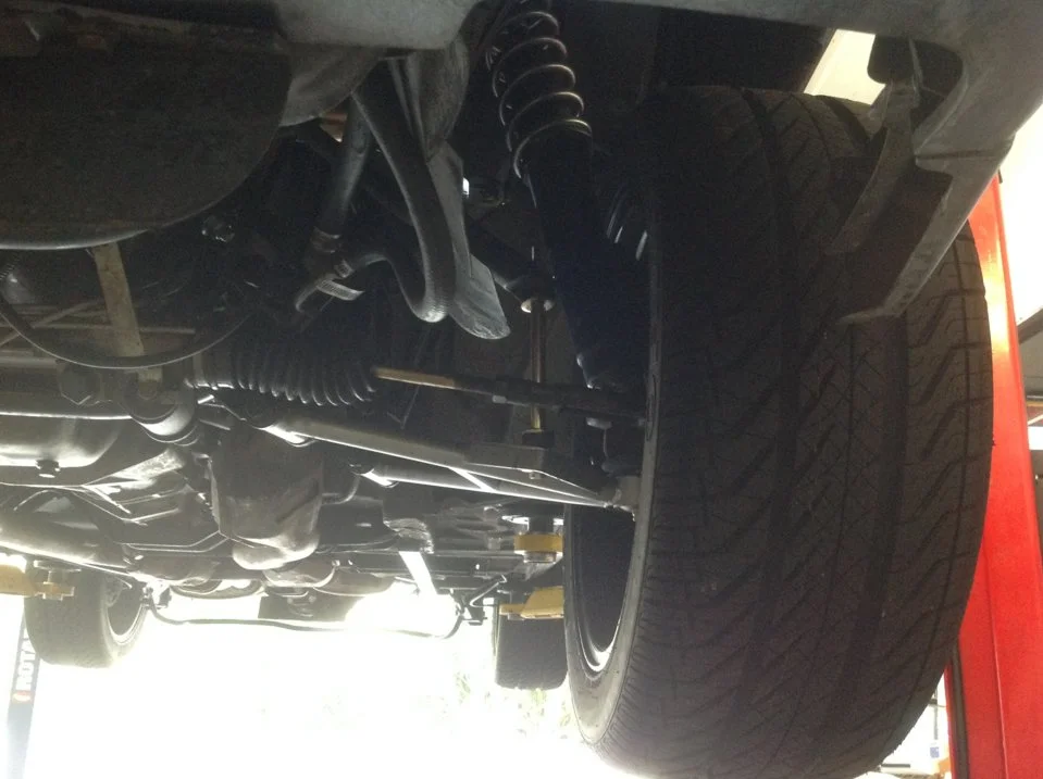

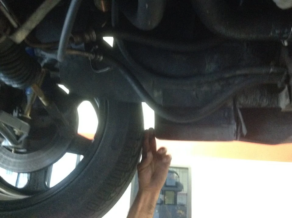

the problem here is that unless you cut/bend the fenders, the tire will rub (and usually more than just rub) the fenders. especially with a wider wheel, or anything that pushes the wheel out (sn95 spindles, lower backspace wheels, spacers to clear brakes or c/o's, etc).I'm late to the party here, @joetrainer31 . I understand not wanting tires to rub, but that aside, why the dislike for the forward shifted wheel centers? It's my understanding this is a very desirable suspension mod, (see: maximum motorsports k member) that actually improves handling on a fox. Heck, when I switch to a tubular k, it's going to be the MM unit just so I CAN improve handling. Wouldn't a minor fender modification have saved time and netted superior drivability? And at a much lower cost than a MM k member at that? Forgive me if I'm missing something obvious here, but I can't help but wonder..
I wanted the tire moved back to its stock position because it was doing more than rubbing. It was folding the fenders in when trying to turn. I didn't want to cut the fenders. My idea is that the parts need to fit as advertised.I'm late to the party here, @joetrainer31 . I understand not wanting tires to rub, but that aside, why the dislike for the forward shifted wheel centers? It's my understanding this is a very desirable suspension mod, (see: maximum motorsports k member) that actually improves handling on a fox. Heck, when I switch to a tubular k, it's going to be the MM unit just so I CAN improve handling. Wouldn't a minor fender modification have saved time and netted superior drivability? And at a much lower cost than a MM k member at that? Forgive me if I'm missing something obvious here, but I can't help but wonder..
