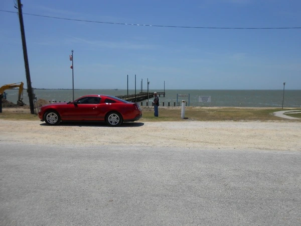

  7. Lower the pony and get better grip with brackets. Wider tires will help too. tn_DSCN0080.JPG
