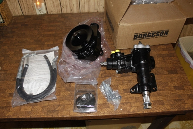

  7. if you are replacing a power steering system, you can buy just the borgeson steering box and piece together the rest of the system, mostly just the hoses and the rag joint. the install is fairly easy overall since oyu dont have to modify your steering column. as for where to buy the borgeson box, try borgeson themselves.

  9. the borgeson box is power . the hoses run directly into the box. the kit comes with the pump hoses and brackets. _MG_3317.JPG

    since you dont have power steering, you have a few options;
    1: you can search up the original power steering bracketry, either from a salvage yard or new or used parts source like npd or autokrafters.
    2: you can grab the power steering brackets from a later model engine of the same design, ie if you have a 289, grab some brackets from a later model 302, and use those with any needed modifications
    3: you can buy the complete power steering kit from borgeson which includes the power steering pump and brackets to mount it, as well as hoses and all the other little bits and pieces you need to install them on your car.
