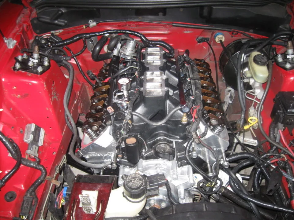

  8. There is a guy on here with a stock bottom 351 (Venom351). He has a very large set of heads and a cam from FTI. The problem he ran into is that the stock pistons in the 351 required a little bit of a unique setup with the cam and heads to clear the valves. I think he will still be around 450hp though.

    I can't remember- is he running stock rods/bolts? @Venom351R

  12. Yeah it's a stock bottom end of some sort. Some sort of Cobra R engine. I remember pictures of the short block, and they were definitely stock looking pistons. Notching pistons in the block isn't that popular anymore, but it's doable.

  17. Yes its the stock rods and I have ARP Studs not bolts. The heads are 234cc Custom CNC Ported High ports. The Dyno day was canclled this summer and I never got a chance to go back again with other stuff that was going on. I did trap 110MPH on a few runs and the tune was worked on more since then. Hopeufully will have solid numbers next spring. The Heads were also from FTI and yes the Pistons are stock.

  18. 110 to the 1/8th or 1/4?
  19. Quartet
    In the quarter
  20. No offense, something is not adding up here. 351, custom cam, 234cc cnc ported high ports and only 110 mph in the quarter? What kind of power do you expect this combo makes? What were you ets? regardless of 60' times mph tells all when it comes to hp and you seem to be way under what I would expect that combo to make. What kind of cam specs?
