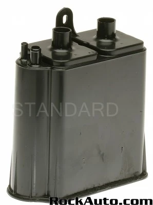

The carbon canister is normally mounted on the passenger side frame rail near the smog pump pulley.
Carbon Canister:
Carbon Canister:
