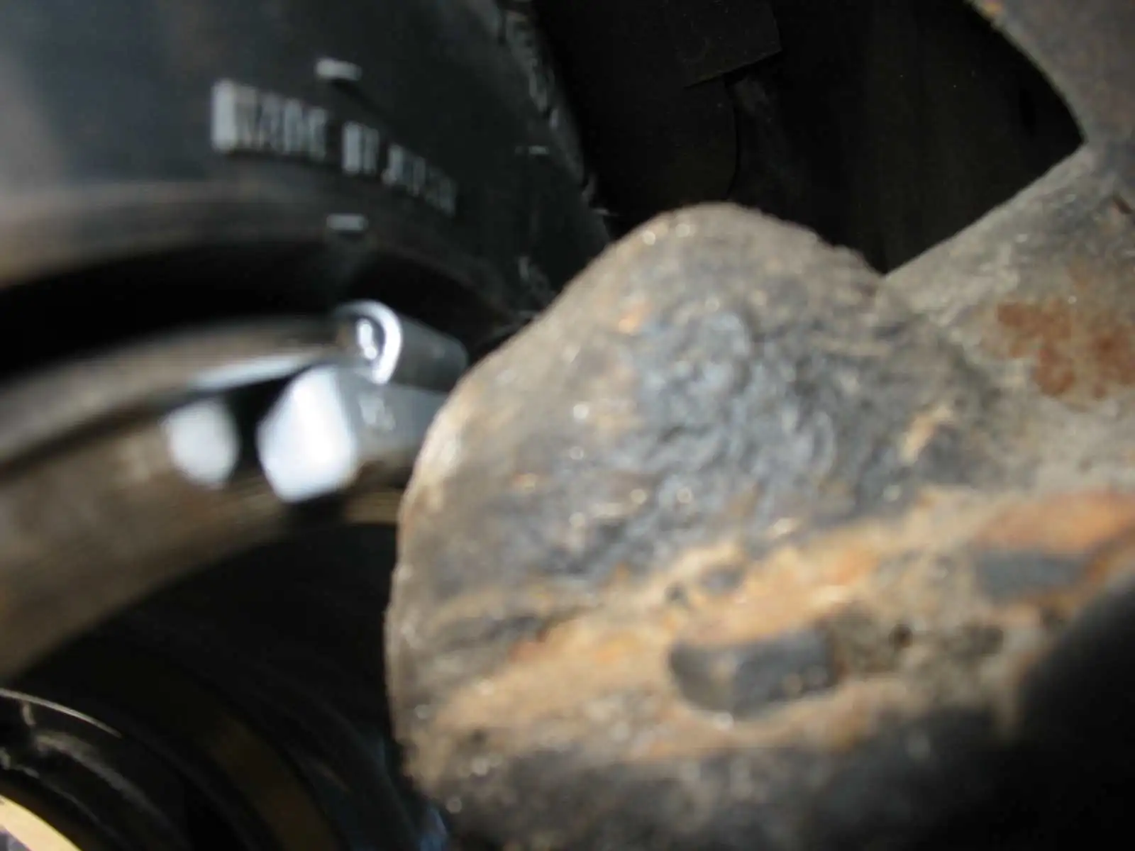

  5. Quote:
    <hr>
    Good pick. My impression has always been that using a rim with 4.75" backspacing would stuff the upper ball into the rim, creating the interference. Your pic obviously dispells this. Pics say a thousand words.
    Maybe someday I will get my stang put back together so I can research this stuff myself.
    <hr>
    Here is a picture of how a 17X8 4.75bs fits on my 67. The rim does not touch the upper ball joint but the wheel weight does.
    <img src="http://forums.stangnet.com/attachment.php?attachmentid=15105" border="0" alt="" />
