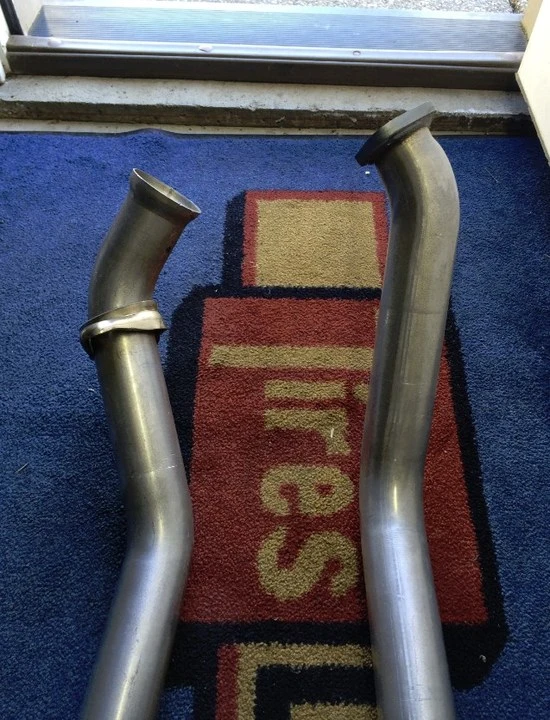

  9. Is this right?
    Where it goes to the manifold
  10. Yep
    Deek likes this.

  12. The gasket goes on the right (pic) or passenger side......
    Deek likes this.

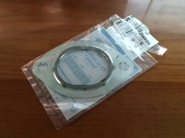

  16. Got the part at ford with my discount for 9 bucks they had to order it but came in the next morning
