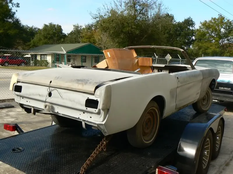

Even though I posted in your other thread here are my suggestions, and these are all from personal experience with my 65. BTW I can't find a pick of it completely torn down but here is one of it on the trailer heading from one shop to another to get the body work finished and then paint.
