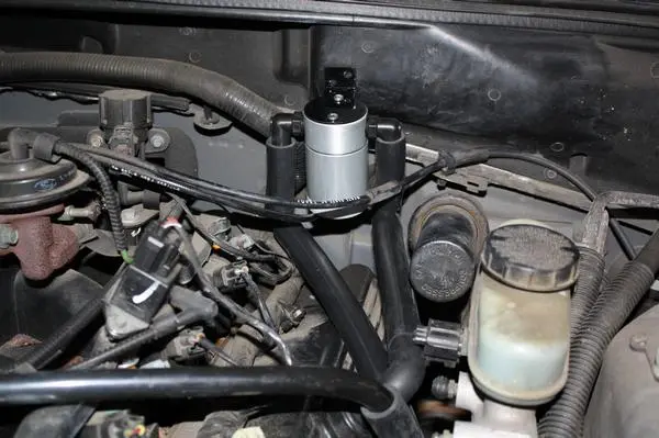

  3. That picture shows a 2v for sure. I wonder if I should run one on each side?
    I'm going to run my Moroso on the right side in between the PCV and Plenum connections. Perhaps an additional JLT or Steeda on the right if I do not get the desired effect.
    Or do you think I should hook up the Moroso on the right side?

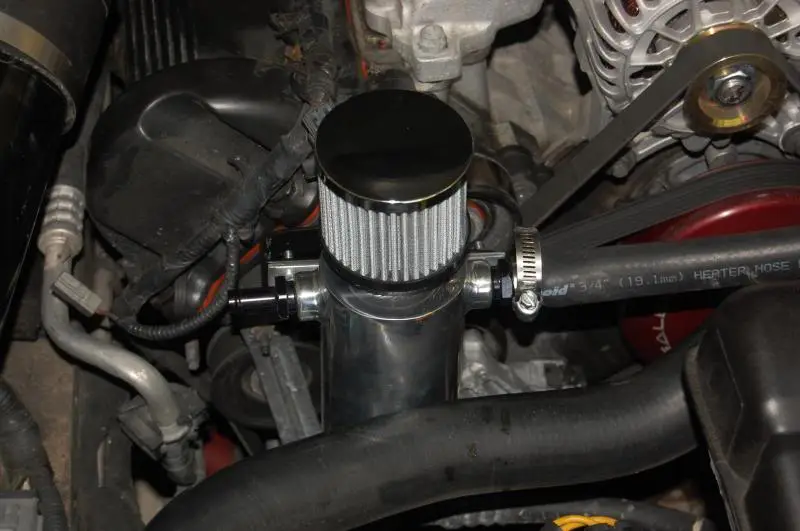

  10. Not to contradict what Burns said but I've seen blow-bye on my oil cap, it does makes it way through the drivers side. Make sure those hoses dont collasp under the vaccum pressure or else you will be changing a valve cover gasket, those are not fun....

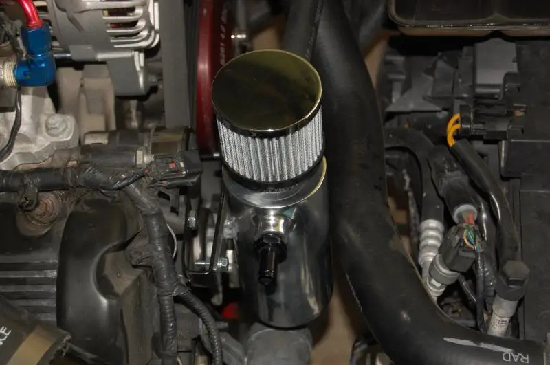

  11. Mine too, trombone. Lot's of oil on the driver's side. Not so much on the passenger side. Here is how I set mine up.
  12. Glad to hear I am not the only one with this issue.
