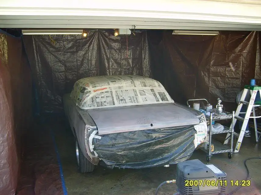

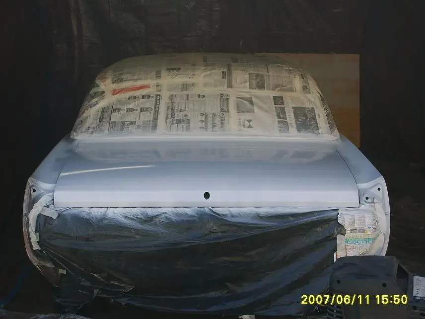

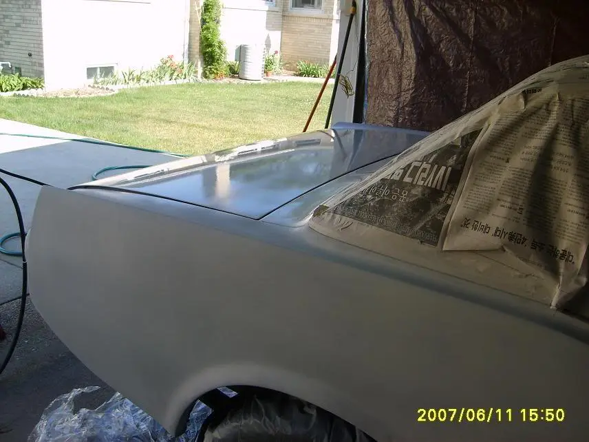

  1. Shots of the primer being put on, still using rustoleum white bare metal primer.
    Check out the hillbilly paint booth :D
    Picture of the primer drying, looks glossy but dries to a dull finish. I hope its a preview of what the red is going to look when when I spray it.
    Trunk looks awesome for just primer, a bit of sanding dust (the primer is dry btw)
    Going to go over a few more rough spots then start spraying red. I am pretty convinced this is going to turn out decent.
    Oh, and those pictures are only of the first coat of primer, and my first time using an HVLP spray gun.
    And the top is vinyl, in case you are wondering why its all covered up
