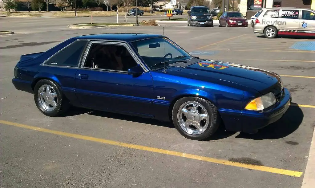

  3. I'm not 100% sure on color. I've got it down to three choices. A dark metallic blue. (Like the new stangs not sure on the name of color) "Grabber blue with black graphics to break up the blue or just a respray of the factory deep forrest green or a variation of that color. Maybe more flake in it.
    I've heard a lot about ppg. And also onow all about the prep work being flawless. I only have experience with napa auto primer both regular and high build. Now after priming I have to seal it before paint correct? And if I decide to go with the grabber blue it will be a single stage since there is no flake in the paint.

  5. PPG paint and Kona blue gets my vote
    ry94stang50 likes this.
  6. Vinyl wrap that sucker!! Done!! I'm a problem solver, what can I say...lol
    B-radster and madspeed like this.
  7. Kona Blue definitely
