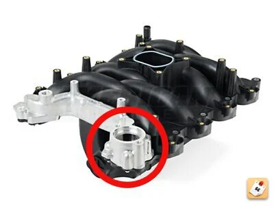

hawkfish78 Member Jun 13, 2011 37 0 7 Nov 2, 2013 #1 Nov 2, 2013 #1 What is the part that attaches to the circled area of the intake manifold. The radiator hose also attaches to this. Mine is cracked and I need to fix it, but can't find a name for the part. Thanks!
bhuff30 Founding Member Dec 11, 2001 6,037 35 129 Olathe KS Nov 2, 2013 #2 Nov 2, 2013 #2 The thermostat housing. Reactions: 1 user
wmburns SN Certified Technician Aug 14, 2009 5,892 521 204 Houston Texas Nov 4, 2013 #4 Nov 4, 2013 #4 Just wondering. You are aware that the T-stat housing is not a separately serviceable part of the intake manifold? The T-stat cover is serviceable as well as the T-stat itself. But the metal coolant crossover is part of the manifold on the 4.6 Mustang. Some other model years Ford trucks (for example the 2005 F-150) have a coolant crossover that is separate from the plastic manifold.
