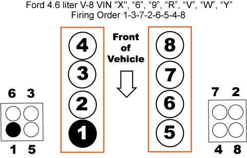

    Silly question: Are you sure you got the firing order correct when putting the wires back on?
  6. No I'm not sure about the firing order.... I looked at a bunch of stuff online and followed them but I could have swore my car was different than it is now when I took it apart. I'm not sure though and I don't know why it would different than any other car lol.
  7. Does this look familiar?
  8. Yes that's how it is right now and I just went out and looked to make sure. for some reason it doesn't seem right but I think I'm wrong on that lol. just curious,,, do you think the miss fire feeling could be because I'm running such a steep cam and no stall converter?
