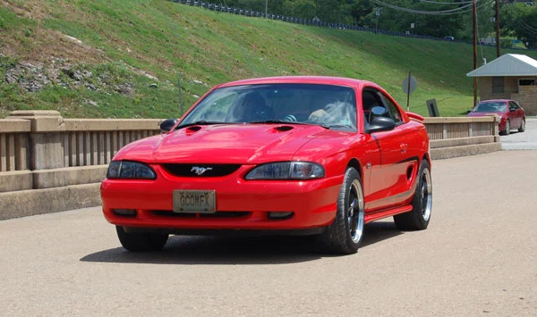

    With the 3/8" spacer it will clear the stock hood.
  20. gcomfx.com
    Joined:
    Oct 22, 2002
    Messages:
    3,710
    Likes Received:
    Trophy Points:
    56
    Location:
    Republic, MO
    I know a stock hood will fit. Now I also know a 96 Cobra hood will clear as well. :D
