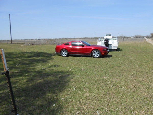

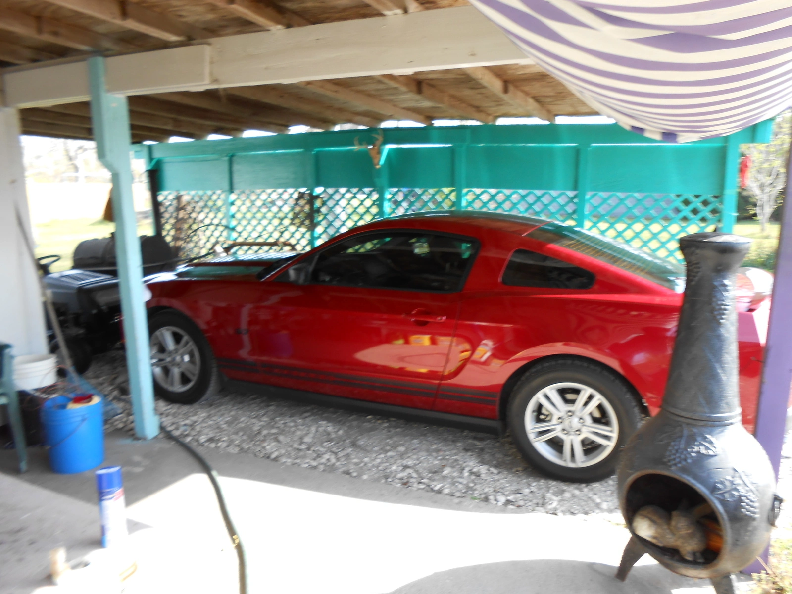

  4. tn_Dicky Ranch 006.JPG Nurse Cindy 026.JPG I just installed "Rear Only" Stack Racing springs, I get no vibration up to 90mph so I believe my pinion angle is fine.
    My pony is now level and handles great in the twisty's!
