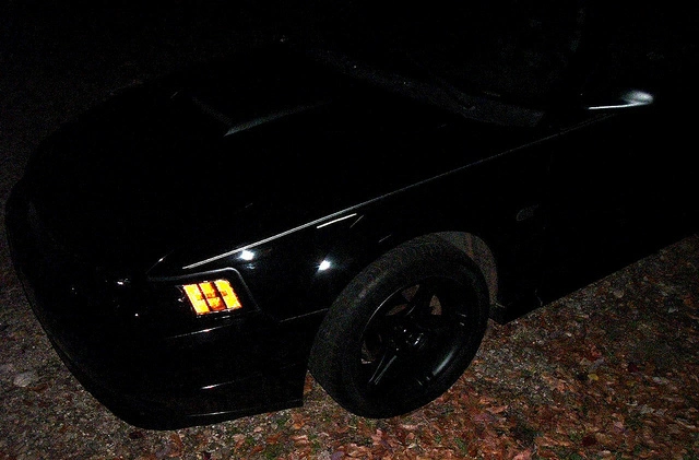

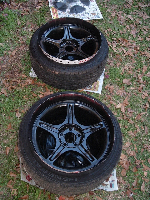

    Well.. I got my rims done. Used d98gt's card trick. :nice: I started around 1pm and finished around 6pm (after dark). Only because I decided to replace the rear wheel stud that was stripped about 2 years ago from some small town tire shop.
    The driver side looked ok, but not too sure what the passenger side will look like.
    I'll post the pictures up later tonight.

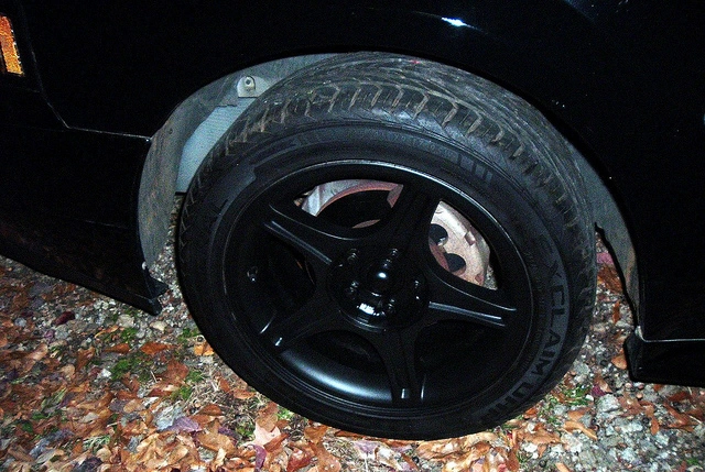

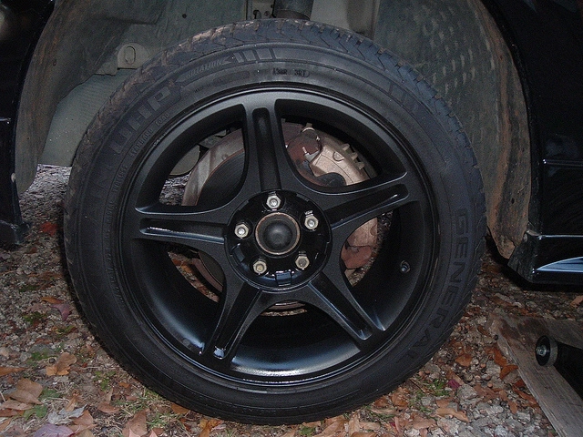

  15. Here we go.. I like it now, but will see tomorrow. I'm not putting the center caps back on.
  16. Thanks, yours look sweet.
    No clear. In the first two pictures, they're still wet. The second two are the flash.

    I wouldn't do what I did. lol. I did not wait long enough between coats. When I did the wing, hoodscoop, emblems, and horse, I waited 30 mins. between coats. This time it was maybe 10 mins. between coats. Daylight is my nemesis.
    Anyway, I did the driver side wheels first. I cleaned the wheels. Used the deck of cards. Did three coats to the back, flipped 'em, and did 4 coats on the front.
    I waited 30 mins. and mounted them. Again I waited a few hours the last time I did it.
    After mounting, tightening, lowering, and tightening again, I cut a circle in a sheet of newspaper and taped it to the tire. Then I sprayed the lugnuts, studs, and wheel center. :shrug: Next time I remove the wheels will be fun.
    If I were to do it right, I would wait longer in between coats and before final assembly. It comes out looking better in the end.
