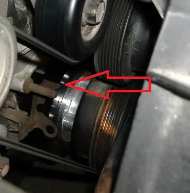

    No offense taken. Im looking at the timing pointer as shown in the photo below (not my engine).
    Shear key looked fine and new balancer went on smoothly with no force needed.

    Yep, you got the right mark so I think you have the timing set correctly. From what you’ve posted, I don’t think there’s much left to test on the ignition system side.

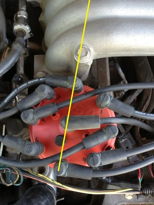

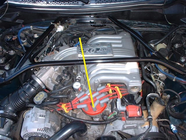

    I think I may have found something. I realized that this particular problem didnt start until after I installed the new distributor. So I pulled up a picture online.
    I have made a yellow line on the two pictures showing where the #1 plug wire is pointing on the engine. Mine and the other picture are drastically different! Please ignore the numbers written on my cap. I know they are wrong. The wires to go the right place!
    IS MY DISTRIBUTOR STABBED WRONG?
    Photo of an engine I found on google.
    Photo of my engine.

    Dude, looks like it's 180 off? My #1 is closer between the two bolts at the intake plenum... I'll have to check tomorrow morning, but I think it's stabbed wrong. Do yourself a favor and turn the crank to TDC and then take the distributor cap off and re-stab it. See where it lies.
    Everything is correct on this write-up minus the 10deg BTDC. Just mark it RIGHT AT TDC.
    http://forums.corral.net/forums/5-0-5-8-engine-tech/1291083-stabbing-distributor-101-a.html

    Don't go by other people's engines!
    You are probably on, don't worry if you are not in the same place as 1 on other cars.
    If you clock the wires, number 1 can be ANYWHERE on the distributor you like, and does not have to be one set spot!
    Stand down and look at this with a clear head.
    Check your placement of number 1 to confirm you are correct, before pulling the distributor.
    If you are on, no harm done, you have just taken the time to confirm.
    If you are off, then start from scratch and expend time on resetting the distributor.

    Oh, and if you do find that your rotor button is significantly off of the posititon of #1 wire, you can just move all your wires in the same direction to make a 'new' #1 position on your distributor cap that meets the rotor button on TDC. This is quicker than restabbing the distributor, and does the exact same thing.
    HOWEVER, I doubt you will find anything.
    The fact that your spark going to plug #1 mechanically lines up with the timing pointer means that this is almost impossible. You would have to be EXACTLY 180* out of time for this to happen, and you can bet a little detonation would be the least of your issues if that was the case.

    Are these 2 pics supposed to be showing us they are different, or the same???
    Are you saying there is a 3rd pic with the #1 wire in the yellow line position?
    I am having trouble following you.
    How about showing us a pic of YOUR distributor cap like it is now, with a yellow line added to show your current #1 spark plug wire in that picture?
    The bottom pic is yours, correct?
    Repost that same pic, with a mark showing us which wire is #1...

    Your pics have me confused as to the fact that the yellow line in both seems to point to #5 cylinder...
    You do know that #1 is the first cylinder on the passenger side of the car, correct?
    If you are timing #5 spark plug wire while looking at the timing marks on the balancer, you are going to have your timing advanced about 15* more than you think, which will cause detonation.
    Edit:
    That is with the 289 firing order... 15426378.
    The 351 order (5.0 HO), is different, and it would surely be more than 15*, so take this with a grain of salt.

    That can only be true if the crankshaft and camshaft are also correct with the piston at the top on the compression stroke with both valves closed. Since it came from the factory with the rotor pointing at about 1'oclock under these conditions the OP is best advised to maintain the same orientation.
