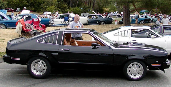

  8. a351Must2 Windsor II

  9. 1badII Member

    [IMG]
    That's the look I want! 16's it is! I think I'm just going to replace the front tires with some Pep Boys for now, trying to pay off a loan. But I'm going to go with some 16" Torq Thrust II's and powdercoat the inside black, and leave the outer lip polished, like the 93 Cobra R's. Maybe for Christmas.

    A351MustII...that black coupe really looks sharp. How much is it lowered, and by what means?
    1BadII...I think that a lot of the visual difference between the green hatch and the black coupe must be due to lowering. The wheel and tire package is fairly close between the 2.
    Now I just have to find a way to get the same look as the black coupe on the 15x7 wheels that I just bought! ;)

    The black '78 coupe with 16's is lowered with a set of front and rear springs from Racer Walsh, and 1" lowering blocks in the rear with a '65 Mustang rear-end housing. I believe it ends up lowered about 2". BTW, the wheels on there are 5-lug.
    The black '74 coupe with 15's is lowered about 3" with a different set of Racer Walsh springs that they don't carry anymore. Between the short springs and the 205/50-15 tires I could crush pop cans laying on their side under the crossmember. It cornered great, but you may notice all my current cars aren't lowered as far and run 26" tall tires instead of 22".
    The Green '77 is at stock height and I don't recommend using a 225/55-16...the front's fit a lot better with a 225/50-16 tire, or you can go to 225/45-16 for a stock height of tire.
