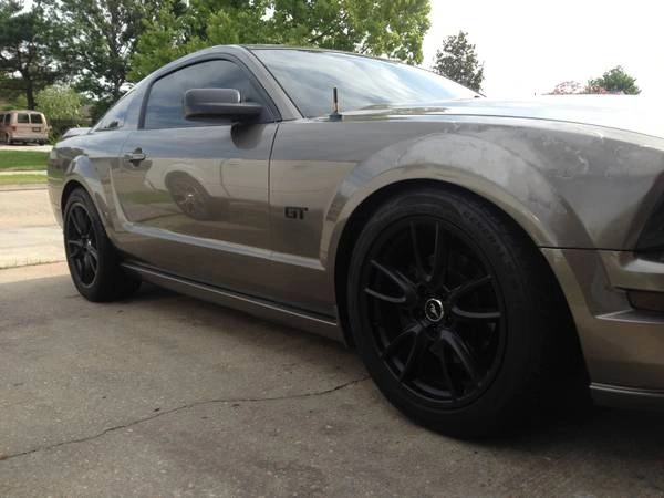

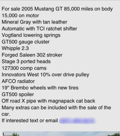

Looking at this mustang. Main question at the moment is, STOCK TRANS? This gt should be easily making 500+ and it is on a stock auto transmission. There will be hard launches every now and again and a level 10 (all I could find in my quick google search) is $3500!
Am I good or am I playing with fire (real world experience preferred)
Car is on 39# injectors that came with whipple kit but he has 47#. Is that a good size for the boost/motor? It also has dual gt500 fuel pumps.
