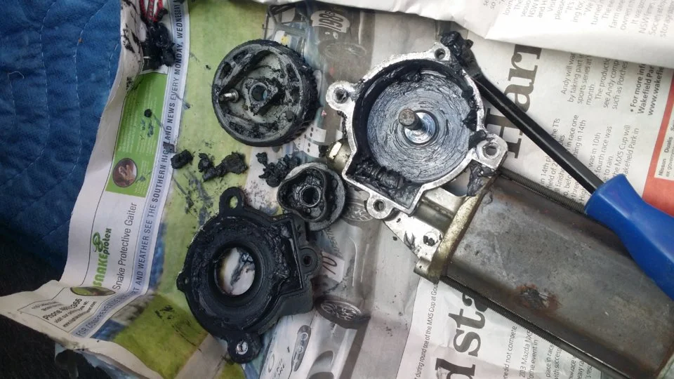

Here's some help, the most likely cause of you problem is the rollers inside the window motor.

Remove the door mounted speaker & the upholstery panel to gain access to the motor. There are 3 screws (5/16" hex head, I think) that secure the motor in place. Remove them and the motor comes out without any problems. Once you remove all the screws from the motor, and it falls away from the gear teeth on the arm for the glass, the glass will move up and down. You may need a helper to hold the glass once the motor screws are out, since the gear on the motor holds the glass from sliding up or down
Motor interchange
The motor is the same for left side or right side, only the gearboxes are different. If you can't find the complete assembly for the side you want, you can get either side and use the old gearbox on the new motor.
The window motor gearbox has 3 plastic rollers that are a safety clutch to prevent possible injury if the window is rolled up while something or someone is hanging out the window. The plastic rollers will often disintegrate into chunks of plastic and the window will no longer roll up or down. The motor runs, but the window does not move or only move a little.
