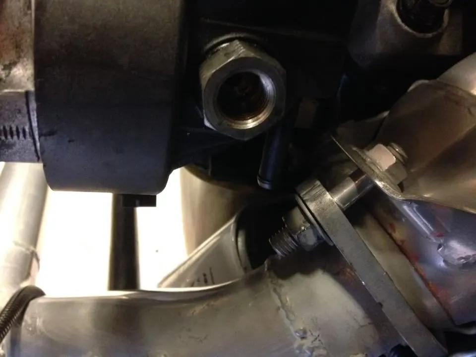

  4. more interneting tells me Edelmann 71116 will work, for $14.xx its worth a shot!

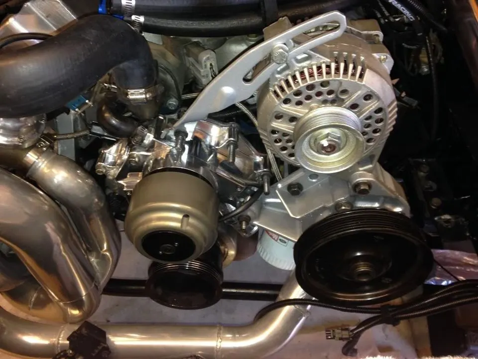

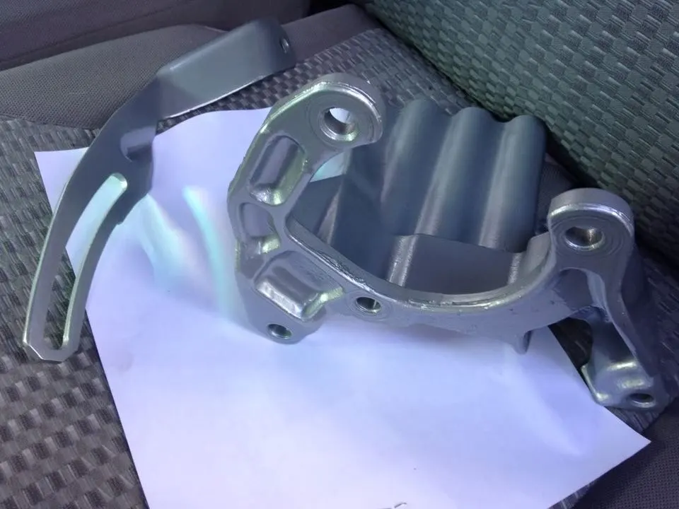

  6. I have done this rack install on the way cheap. I was able to reuse bumpsteer parts and all the high dollar parts I kept from a car that I had to part. So I have 43 bucks in lines, 40 for powdercoat and still need a cooler.
    Of course it has taken longer than it should but whatever.
    Maybe the manual rack and shaft will sell then, Ill be makin money! (lol)

  8. working from home is awesome.
    quick mock up
    Return is le close!
    TOOLOW91 likes this.

  10. Where did you get the alternator bracket from?
  11. 1990 Lincoln town car with a 5.0 in it. Simply modified it a bit and by modified I mean cut it down some
  12. What about the tensionr?
  13. Same towncar also just cut down some
  14. I googled it and I can't seem to find it
