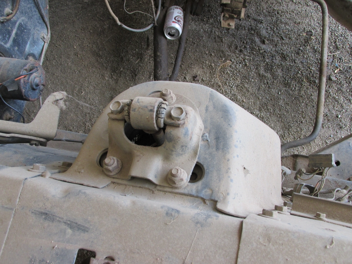

  4. This is what you should have for a shock mount 66-70 style

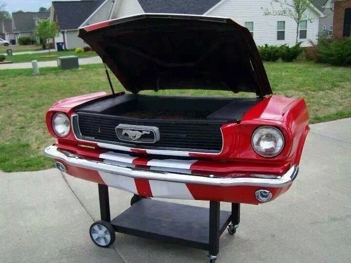

  12. Is that a BBQ grill? I will be right there .:nice:
  13. Yes it is! Lol I kept it b/c I'm thinking when I change out all my sheet metal out on the car was planning on cutting up my front end and making a wall mount for my garage like that
