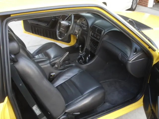

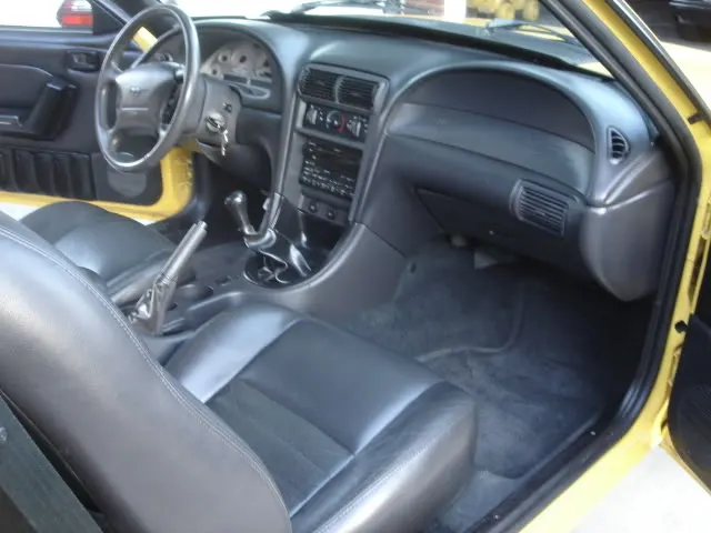

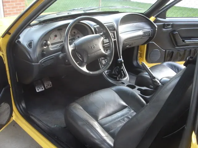

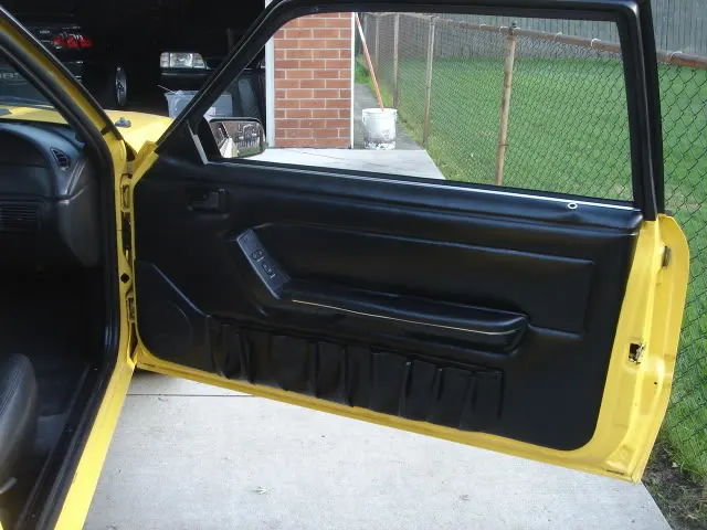

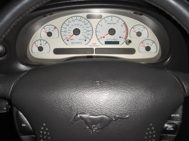

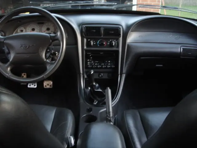

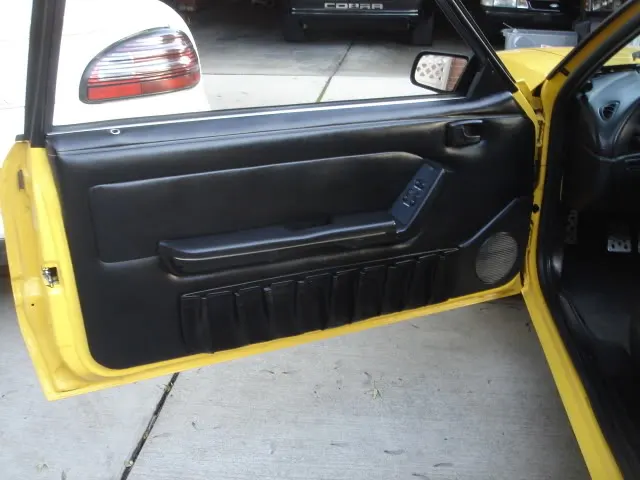

    In the last pic, notice I mounted the factory Fox Body hood release cable to the SN95 dash. I also placed the mirror switch in the speedo bezel. The door handles are in factory Fox location. I just nipped about 1/4" off of each handle to clear the SN95 dash. They open just fine. You can only get a finger or two in the fox handles anyways, and that's what you can get into these. If doesn't effect anything. The defrost works too!!
