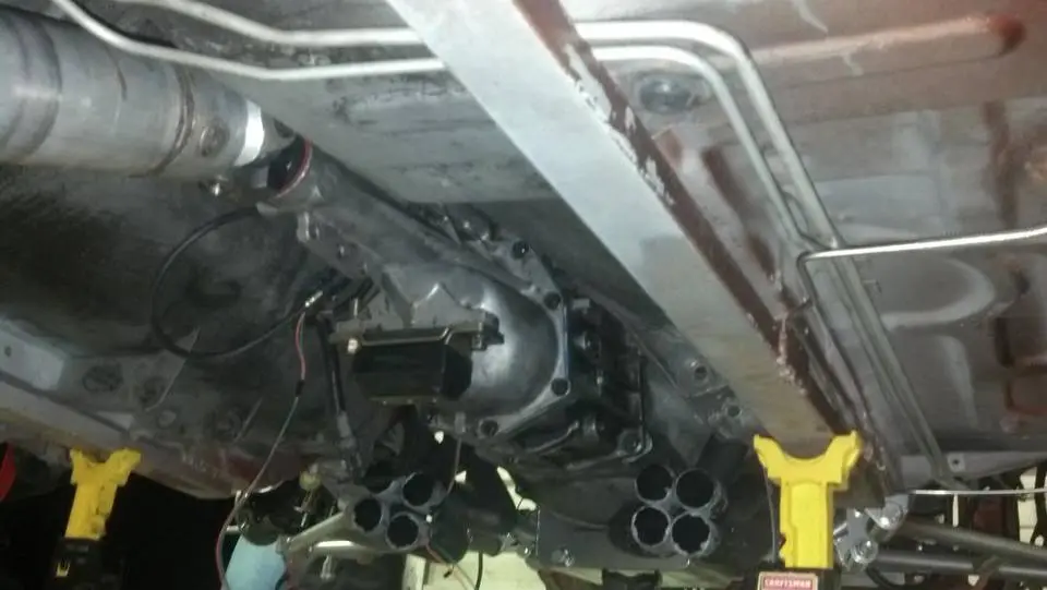

  3. OK so I got a few pics to put up I got the trans in last night at 1130 that was "FUN".
    Also in the pic you can see the new fuel lines I ran as well as the stainless brake line. I surprisingly enough had no problem with all my flares I needed to make which were 7. The hydraulic press was amazing made it to where a monkey could do it.

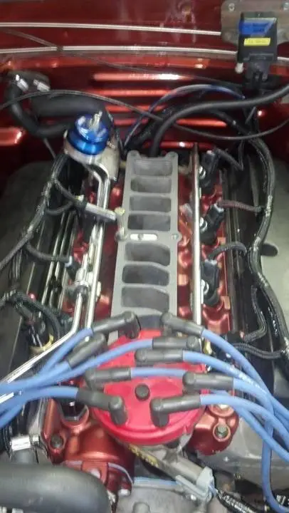

    I ordered some 42 lb injectors and a 90 km lightning maf I don't have a pic of the mad but here's one of the injectors and fuel rail installed.

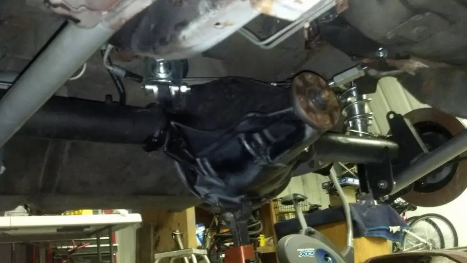

    Also for anyone who hasn't seen it here's my rear end. Again lol.

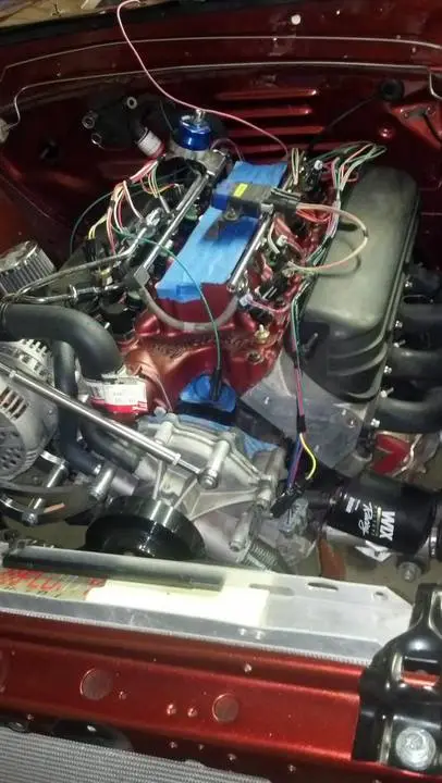

  5. Not much going on around here got my tires dismounted and sent out my injectors to get rebuilt and flow matched after I felt some of the pintle caps were pretty loose and filter were atrocious. Once I get my injectors back I'll be able to at least get some of this mess of a wiring system up.

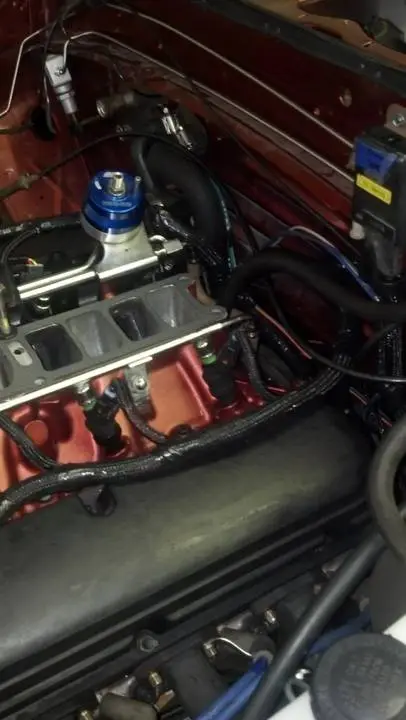

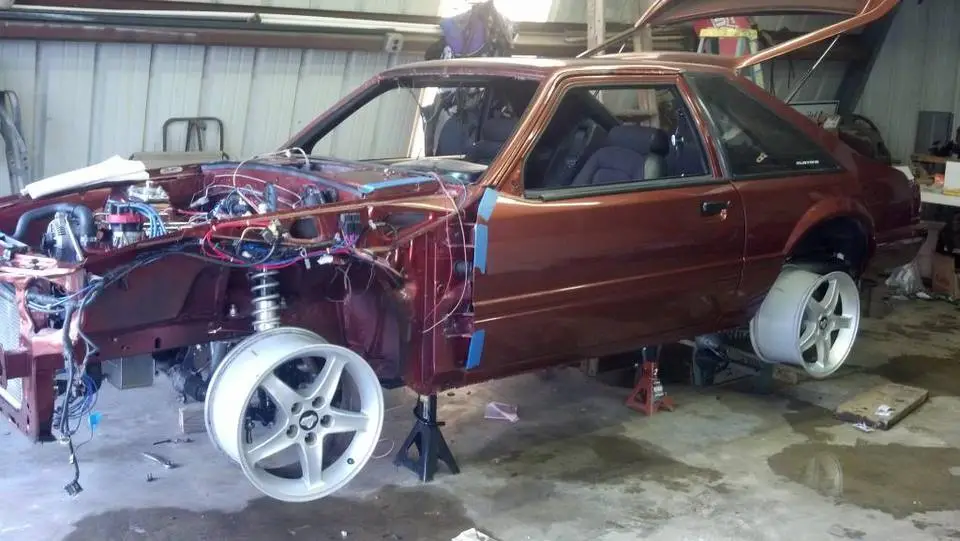

  9. So I got a little work done today was able to loom up the RJM injection tech harness with some painless wiring power braid this stuff looks great I'm very pleased with how it turned put
    Another view

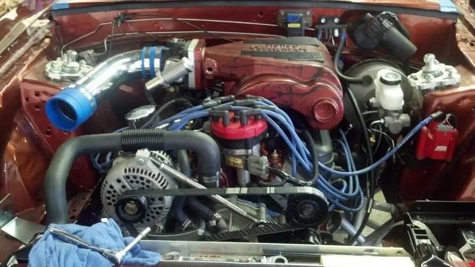

    The upper intake on just to take a pic patiently waiting for my pro m maf from rnh performance Rick 91GT

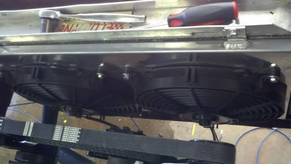

  10. Got a few more things done to the car. I received my radiator fans in from lmr which they look great love the aluminum case they have.

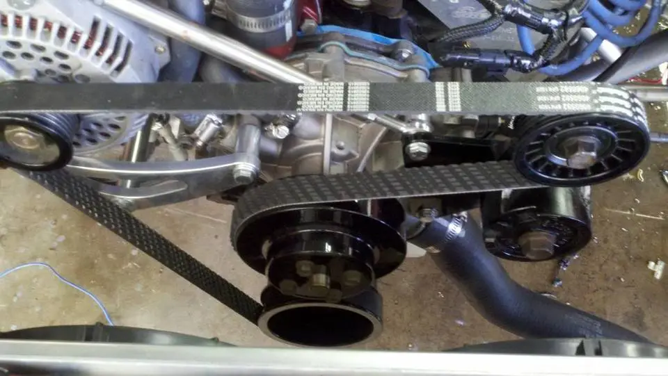

    Also here is a better pic of what my belt routing looks like and everything.

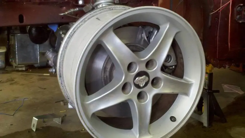

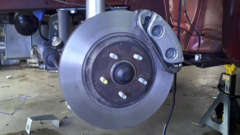

    Received a set of pbr brakes from mps auto salvage a nice 03/04 calipers and 13 inch rotors planning on powdercoating them later on down the road but for now I will be able to get them installed and start bleeding my brake lines.
    Heres a pic with my 95 cobra r's around the rotors these things are huge!

  17. So got a battery put in the car last night and started turning things on and off figure a lot of these things are related to the fact that i dont have my body grounded to my blok. I get a turn sognal to turn on but not flash i have no brake lights my third light wont come on i do have a radio blower wheel windows defrost so i got to get some more ground straos to ground everything right now i have the block to battery connection made

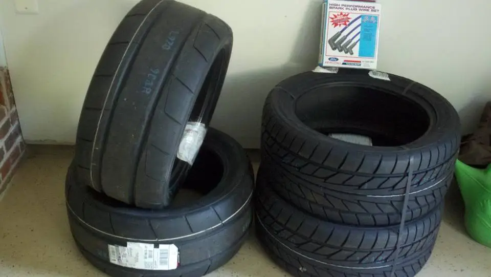

  19. Birthday came and went this past Wednesday and between my brother mom and girlfriend this is what I ended up with safe to say I got it pretty good from my family.
    Anybody wanna guess what tires these are?
