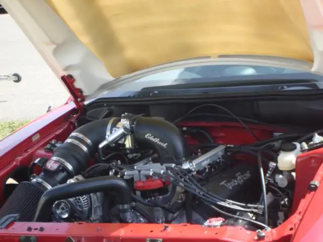

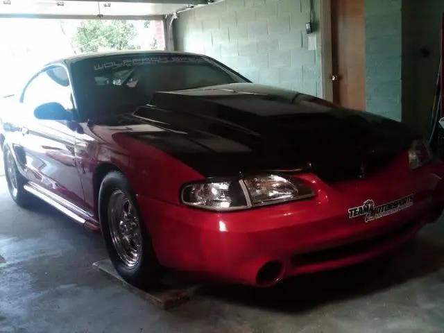

  10. Sorry all I have for now are these crappy cell phone pics while its sitting in the garage.......
