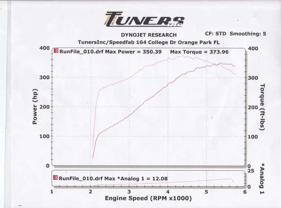

    Location:
    J-Ville, FL
    I wanted to update my thread here as I've added a Vortech SQ supercharger. It made 350 rwhp 373 tq @12 psi boost with completely stock longblock. The numbers were low for this much boost because the tuner had to pull some timing out due to the ACT sensor not being in the discharge tube. I will relocate it and go back for another round on the dyno and possibly a smaller pulley and meth injection.

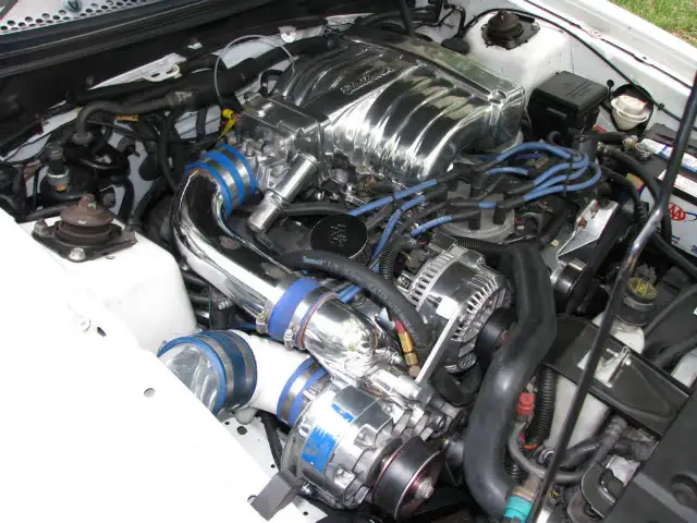

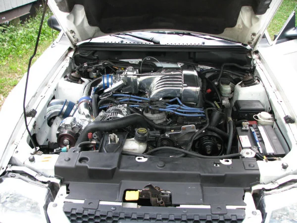

    Here's some pics of the setup:

    after I move my ACT to the discharge tube I'll go back to have a couple more degrees of timing added in which will probably put me up to around 380-390 rwhp. Then later on pulley swap and meth injection should really make a difference.

    Location:
    J-Ville, FL
    It's all good now, I had to buy a MAFia and install it right on the dyno. As far as a restriction trust me it's not. I made 12 psi with the stock 3.33 pulley and 6.87" crank pulley so I'd say my homemade power pipe and the MAF are flowing well. The tuner said I have plenty of room to grow with the MAFia on there since it's only set to "2". The bullet did run out of steam about about 4500 rpm and around 8 psi. The first full pull showed the A/F shoot up to 14:1 as he shut it down.
    The car really is a blast to drive thought and he said I could pretty much beat the crap out of it without incident because it's a very conservative tune with timing locked at only 18* total.

    Location:
    J-Ville, FL
    So I put on a smaller pulley and moved my ACT sensor to the correct place in the discharge tube and only picked up a few hp/tq. It is now up to 370 hp/ 400 tq to the tires at 15 psi! Timing was being pulled down to like 13-15 degrees due to the 200* plus ACT's. He said I now have enough boost to split the block in half but I need to cool it down. So when money allows I'll put a meth kit on and go have it retuned. At that point I should be seeing 425-450 rwhp. As it stands right now thought it's really fun to drive. The boost comes on much sooner with the smaller pulley.
