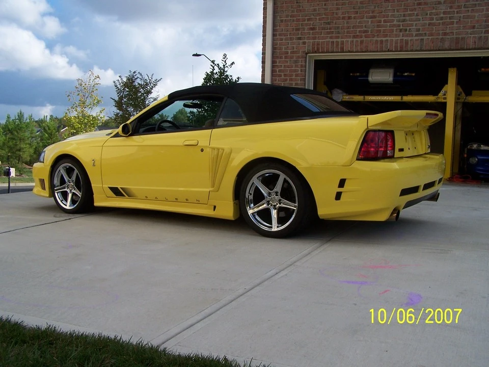

  3. Just an update, the car is about to go through a huge transformation. It'll be getting a full Saleen body kit and I'm painting the car GM Velocity Yellow. I thought about screaming yellow but I think the Vette yellow is brighter. Also I'm about to drop in a fully forged bottom end 347 stroker. Hoping for 500 rwhp with boost. Pics and posts in the weeks ahead when the wrenches start turning.
    The game plan is to pull the current engine out and paint the engine bay. I'm also going to spray the underside of the trunk/inside the trunk and the door jambs at the same time so they'll all be done. Then once the engine is back in I'll begin prepping the car for paint. When it goes in for paint I'll pull off the stock bumpers and side skirts to make way for the Saleen stuff. Should be sweet when I'm done. This is the look I'm going for here:

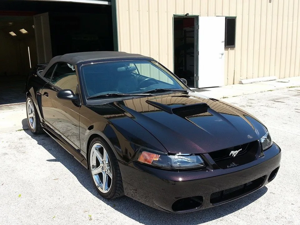

  13. Here's an update, I sold the car last year to a local guy and have kept in touch with him. I'm actually assisting him with a procharger install right now. He ended up getting it painted black with a purple pearl in it. Looks great! I regret selling it every time I see it.

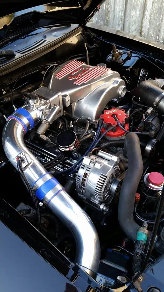

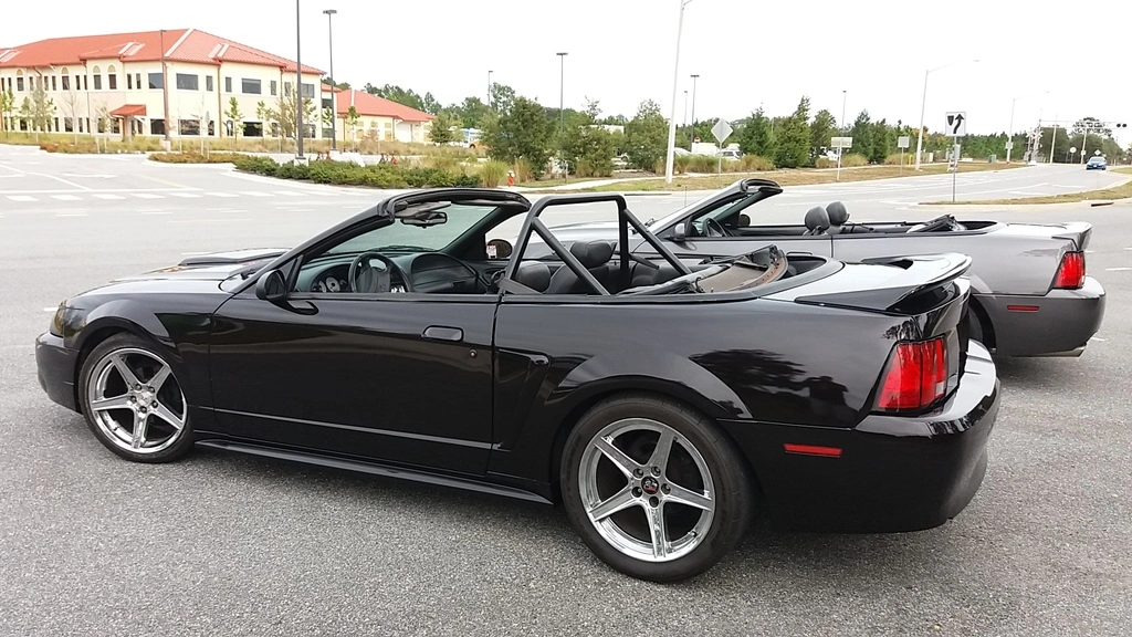

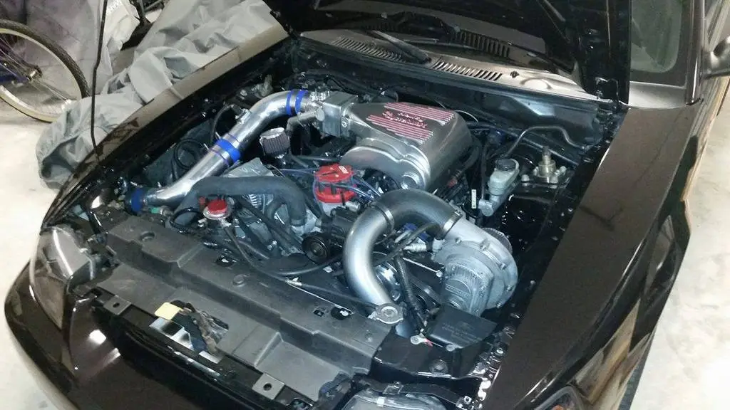

  15. And now even more updates to this 5 year old project. I just bought the car back to add back to my stable. It now lives next to my 03 Cobra! It now sports a H/C/I setup with an old P600B Procharger. Doing a turbo later in the new year.

  17. Glad you got it back! I always thought it was a bad ass creation. Why are you ditching the procharger for turbo?
  18. This little blower is out of steam at 10 psi. And the power comes on so lazy. The only option is to put a D1 head unit on and I can buy an entire On3 kit for that and make 100+ more HP. Plus I've always wanted a turbo 5.0. They've made some big improvements to their kits over the years so I'll take the gamble. I'll update this thread when I do the install.
  19. The car now sports a stock short block, GT40Y aluminum heads, F 303 intake and Systemax intake. My fuel system consists of a 340 Aeromotive pump, 42 lb injectors and a BA5000 slot MAF. I have everything I need to make good power, just need a better method of boost!
