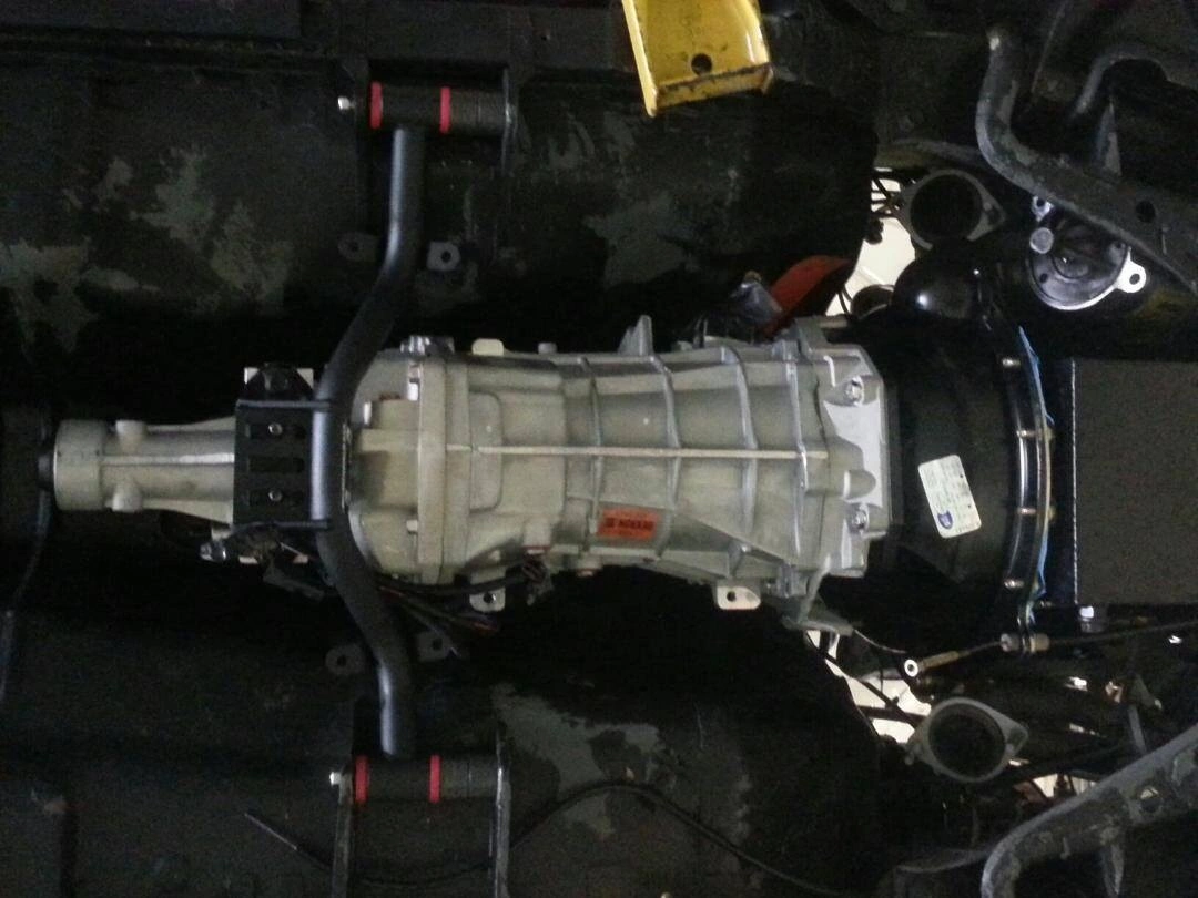

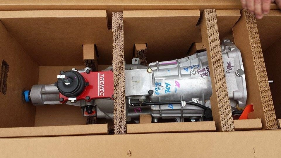

  1. T56 in. QuickTime bell housing, stiffer mount, spec clutch stage 3, and a custom driveshaft.
    Car shifts almost as buttery as my well worn t5. First gear is a 2.66. Car actually has a first gear now. I think I'm keeping my 3.73s. 6th is a tiny bit longer than the stock 5th. It turns 1400rpms @ about 50mph with a 275/40 rear. Once the trans breaks in I think it will but as smooth as the t5
    It was a lot of money, the swap wasn't bad other than some clearancing of the underbody for the trans. It was minor.
    The day after I finished the trans I popped the gasket on the water pump and had to be trailered home. I can't win. Hehehe. image.jpg image.jpg

  2. Was that a cobra t56? I am told the viper unit has a taller 6th overdrive that really drops rpms at higher speeds.
  3. It's a viper spec.

  11. How do you like the Stifflers stuff? I think thats their transmission crossmember?... I was looking at that and their spider brace setup for the K-member and sub-frame connectors.
  12. It was actually a pretty nice piece. Welds were decent, all the poly was pre-pressed. Fit very well. I can't figure out what the other two mounting points are on it though. Instructions didn't say. Maybe they sell some sort of driveshaft loop that bolts up to it? I don't know

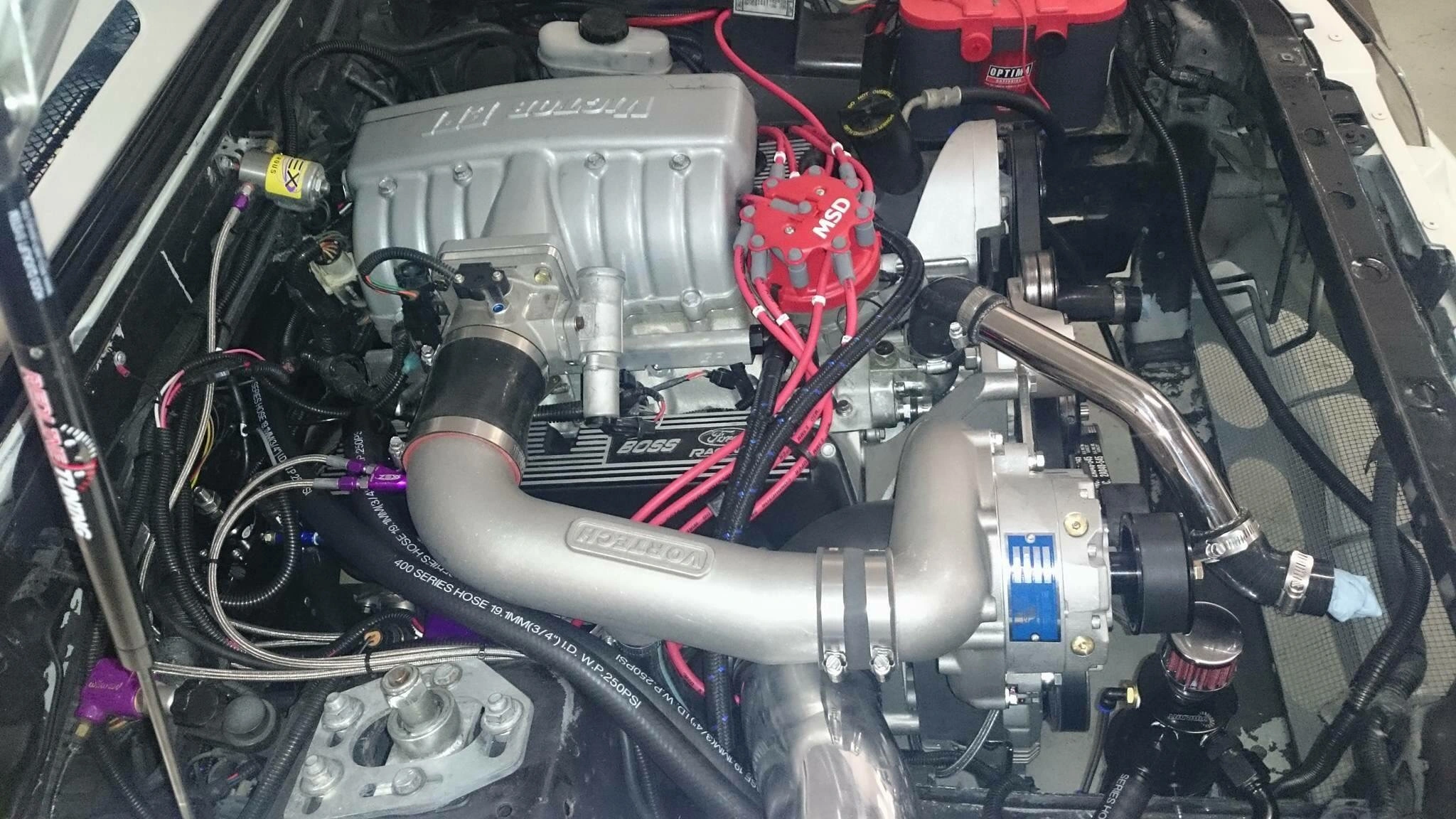

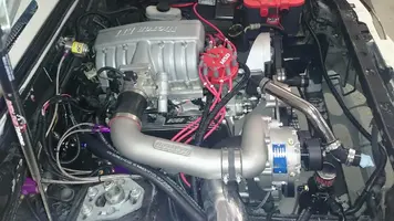

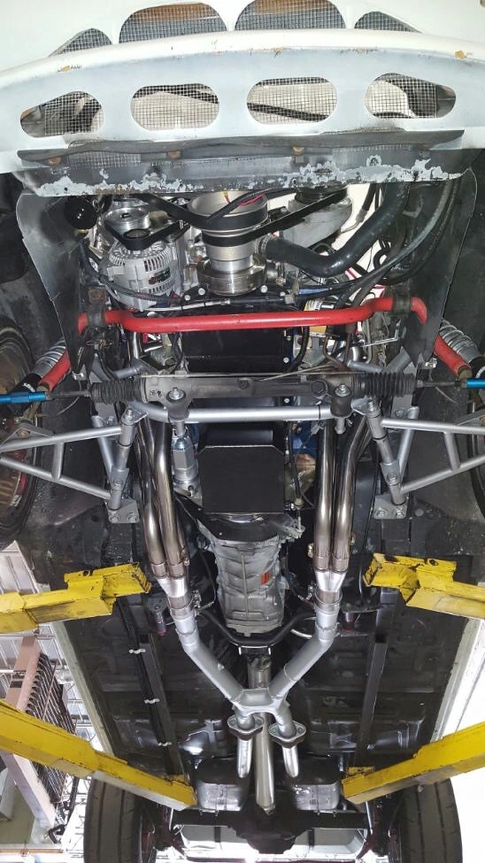

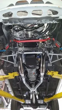

  17. So I added some stuff. Upr kmember. Kooks long tubes. Strange adjustable shocks. Rear and front coil overs, v3 si trim. Cobra tank. Twin 340lphs. 60lb injectors, larger fuel lines, regulator, catch can...some other stuff I can't recall.
