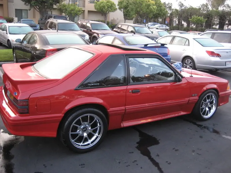

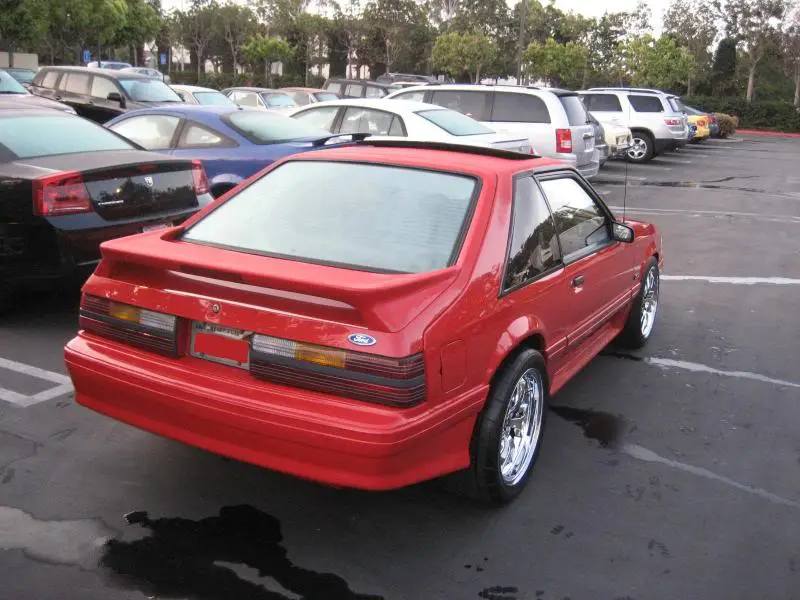

  17. I still have the quad shock on my car with 305/30/18s and it doesnt rub at all, no spacers
  18. no affence but those wheels and tires combo you have look way too big:notnice:, makes it look like a hot wheels car. The wheels look good on your car but they are just too wide, I would shoot for a set 1 inch less at least, car looks good just loks like you are going to ruin your paint and rub the wheel well like a motha.
