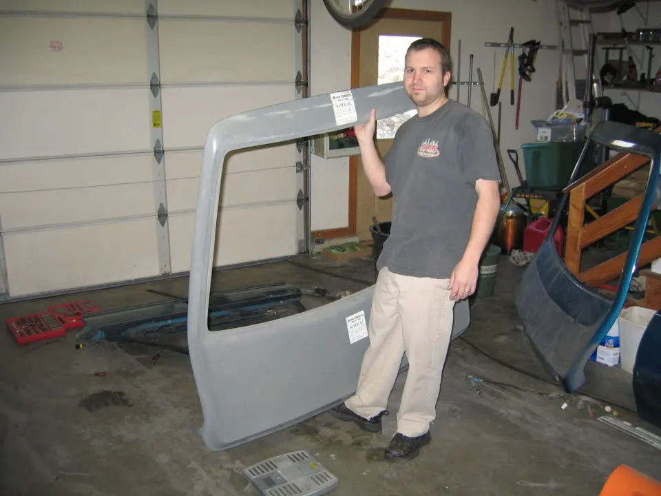

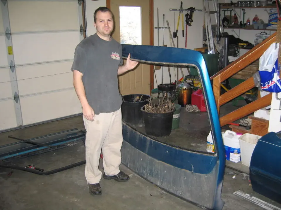

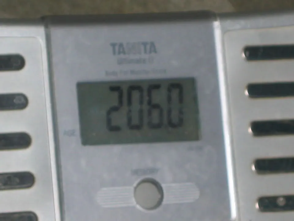

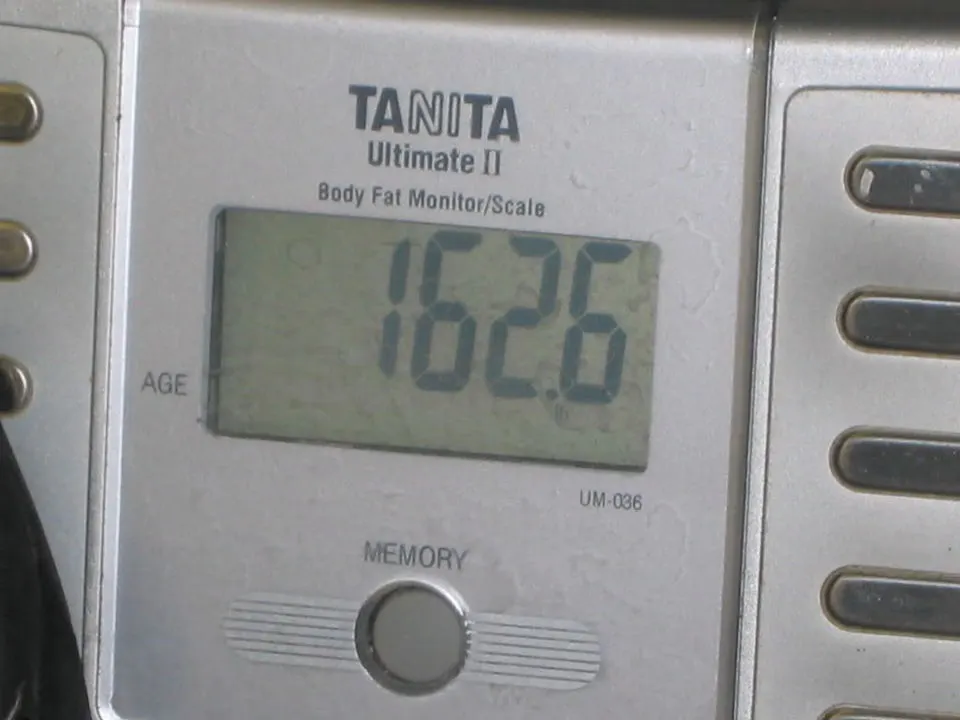

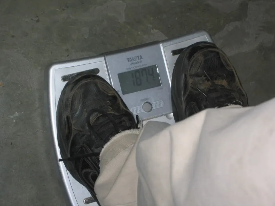

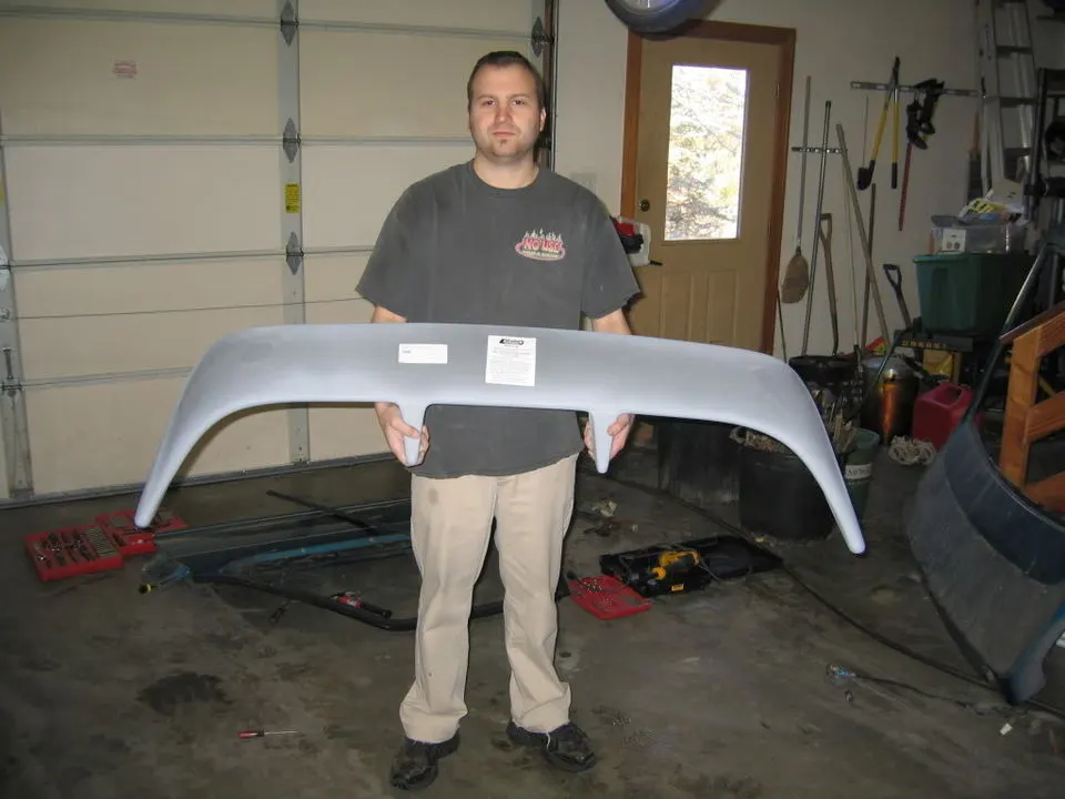

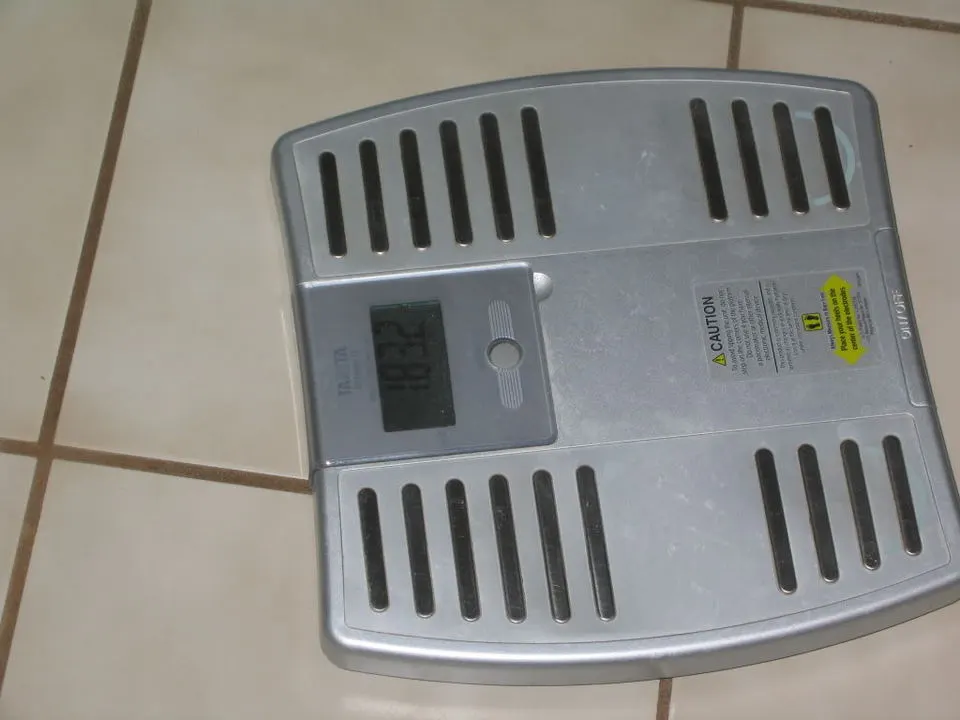

    There are certainly weight savings to be had with these parts, but it is fairly expensive for the amount of weight lost.
    From my build thread on corral...

    my hood was night and day in the lbs dept. Soooooo much lighter. Take your shocks off your hatch and you'll be shocked when you try to raise it.

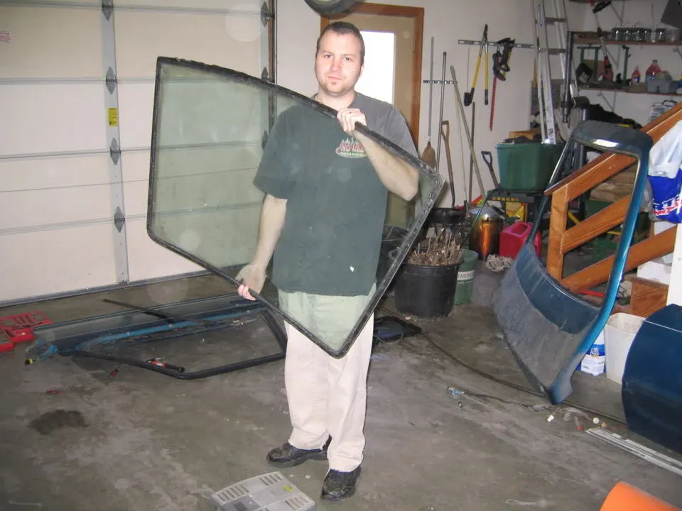

    As the owner of two of these with fiberglass hatches, I can tell you that it is still heavy as hell without shocks (which you can't have with fiberglass anyway) and I can't see any way to avoid that unless you did something about the glass weight (20 lbs.) and the spoiler being levered over the back side of the hatch.

    Fiberglass manufacturers don't recommend using any shocks due to the high load centered in a small area which can lead to cracking and failure. I don't really get into the hatch very often, but if I did I would setup a prop rod.
