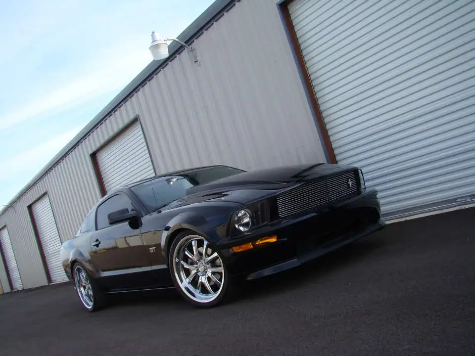

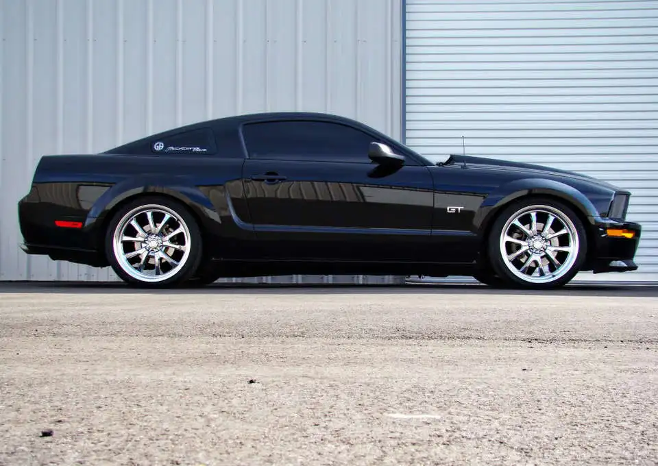

  2. You can cut a coil off the 05+ springs. It will be a pretty harsh ride with cut springs, and 20's. I did the same thing on my 2006. Couldn't stand the ride, so I spent the money and bought a set of springs. With the 20's, depending on what size tire you run, it will fill up some of that wheel gap.
    Here is a picture of my 06 with 20's. This is with the eibach sportlines.
  3. Jarrod,
    Thanks for the info and pictures. All I can say is WOW! Your car looks great! That is exactly how I want my wife's car to sit but I like them a little lower than she does. It may sit okay with the wheels, but I am running 255/35 on the front and 275/35 on the rear so they have a tiny side wall. The guy that I bought them from had them on a '12 CS with the FMS 1" drop springs on it and it was fine. How do your sportlines ride??? What size tires are you running?
    Bryan
  4. I had the 255/35's up front, and if I remember correctly, I had a 295 on the back. I haven't owned this car in 4 years. The sportlines rode like a wagon honestly. It was a little to ruff for my liking, but it was much better than riding on cut springs. If I were you, I would look into the FRPP P springs (1" drop) or the K springs (1.5 drop).
