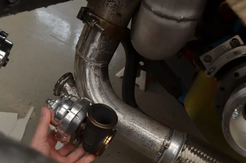

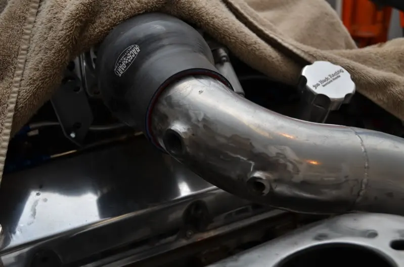

Not a whole lot of progress made this week, but I did get some stuff done. I fully welded up all the downpipe sections. I also welded a 3/8" bung for the ACT sensor and two 1/8" bungs for the methanol nozzles. You can't see the one nozzle bung in the picture.

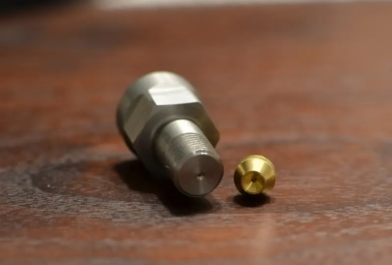

I also made the template to repair the gaping hole in the inner fender.

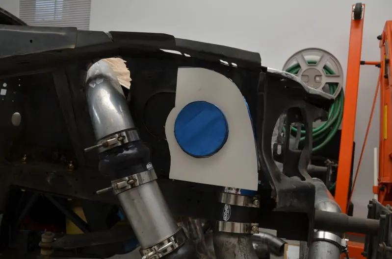

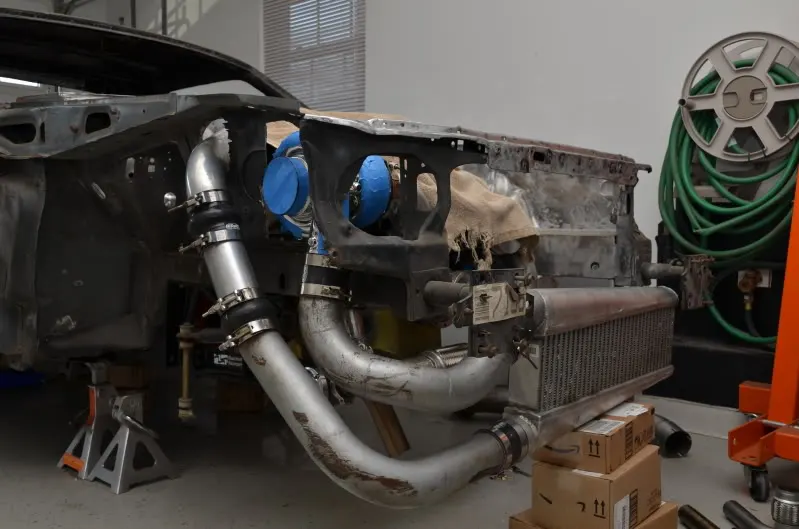

Mocked up the coldside. Everything fit together great. I'm going to have to get some tabs welded to the intercooler to have it supported from above.

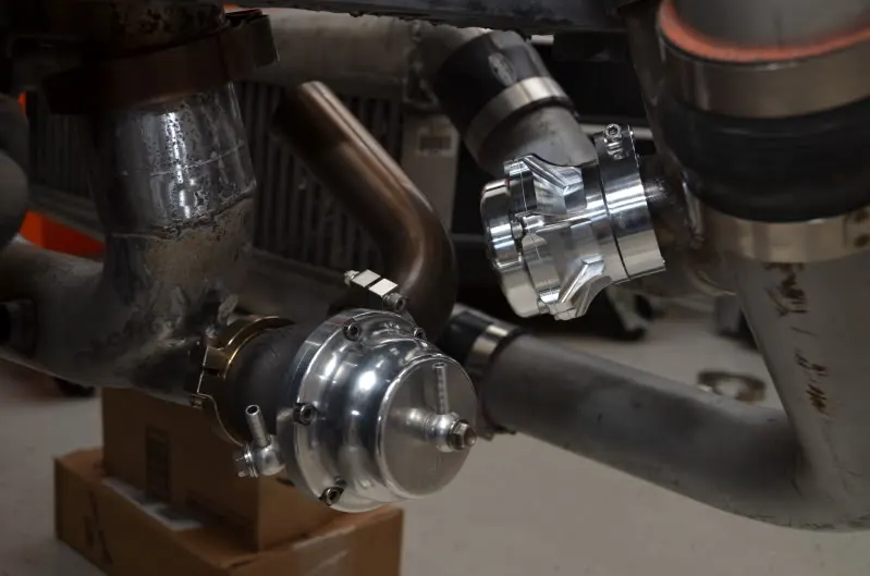

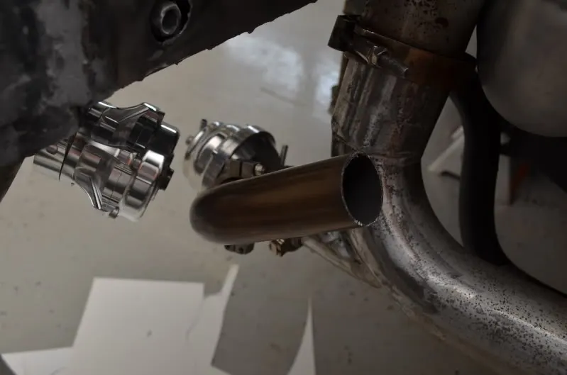

The only conflict that I ran into was between the blow off valve and the wastegate. Because I am recirculating the wastegate back into the downpipe, I need to install a 1-3/4" pipe from the discharge side of the gate to the downpipe. The HP kit was not designed to recirculate the gate, so my discharge pipe sits too close to the blow off valve for my liking.
I do not really have any other good location for the BOV, and I really don't feel like cutting off the flange, moving it, and repairing the pipe. Soooo, being that I'm not even really happy with the condition of the passenger side of the crossover pipe and I plan to replace it anyway, I'm going to relocate the wastegate closer towards the flex bellow.

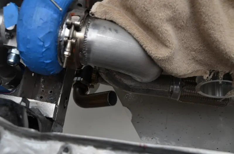

I'll install a 90 degree bend right off the crossover into the wastegate inlet. This will allow me to run a straight pipe (and flex bellow) directly up into the downpipe. I'm going to install a 90 degree bend off the downpipe facing down. This will ensure that the exhaust gas getting dumped into the downpipe is going the same direction as the exhaust gas coming out of the turbo.
The other option is to keep the wastegate inlet in the same place on the crossover, but instead of it coming straight out, I'll install a 90 degree elbow, which will provide enough clearance to the BOV. I'm just going to have to re-check the clearance to the radiator/fan shroud for that option. It may be close.
