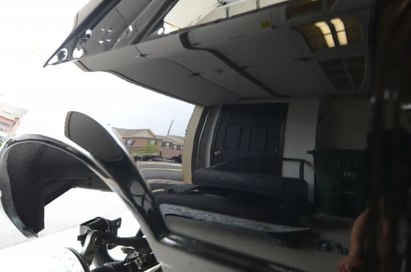

    Believe it or not, the car is finally home sweet home in my garage as of tonight. Here's a cell phone picture for now (for proof!). Real pictures to come tomorrow.
    [​IMG]
    and another cell picture to give you teaser of how great the paint finish came out
    [​IMG]
    Let the reconstruction begin...

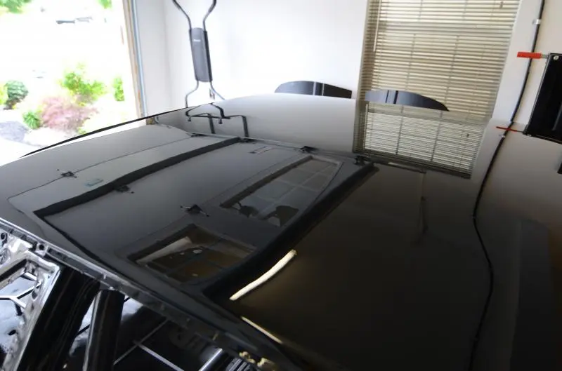

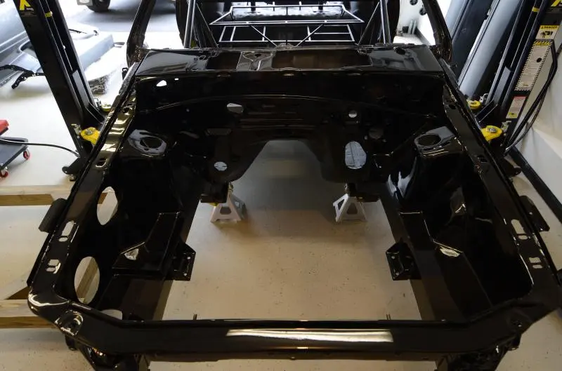

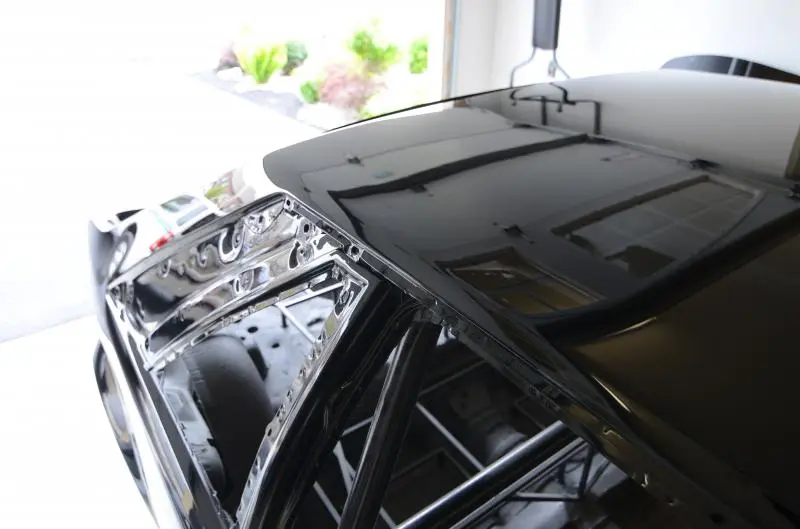

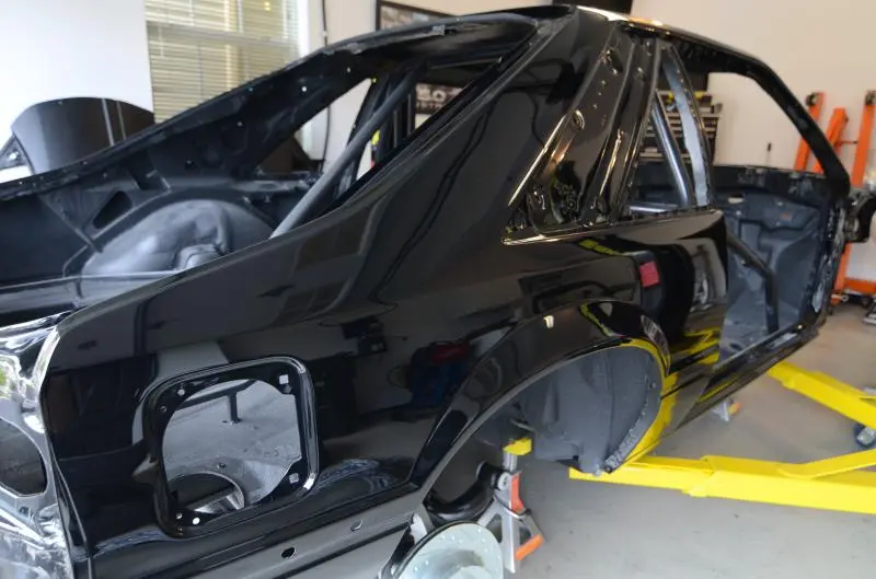

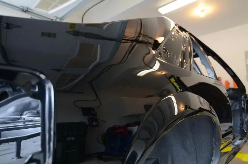

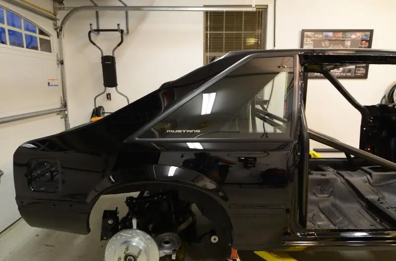

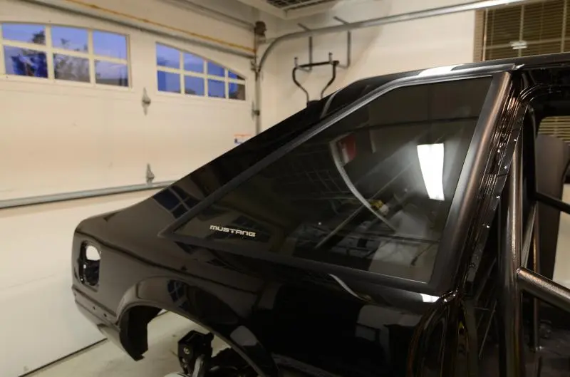

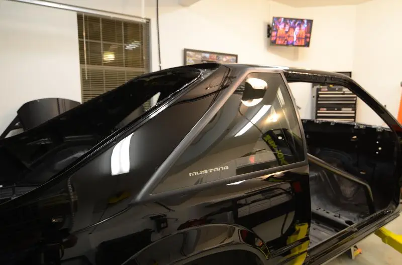

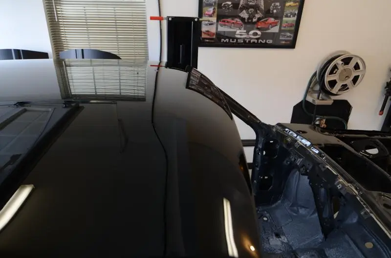

    Here's quick pictures I took at lunch. Cloudy day out, but whatever. I honestly couldn't be happier with the finish. Smooth as glass...
    [​IMG]
    [​IMG]
    [​IMG]
    [​IMG]
    [​IMG]
    [​IMG]
    [​IMG]
    For those that are curious, the paint is PPG Concept acrylic urethane. 3 coats with progressively more clear worked into each coat. Wetsanded and buffed with 3 stages of 3M rubbing compound and then glazed over once after that. The engine bay was not rubbed out. I've got $2,500 in the paint so far. Definitely looking forward to the rest of the parts getting done soon!

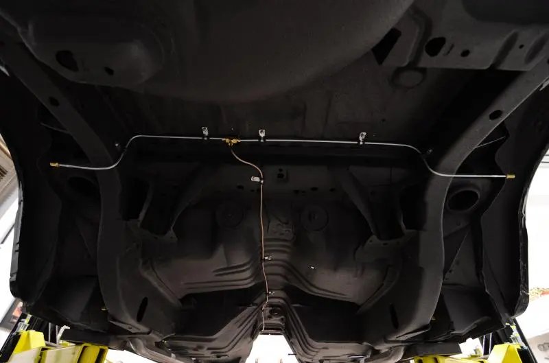

    I did manage to get most of the rear brake lines in tonight. The orange-ish line is a really cool nickel copper alloy line. Super easy to bend and manipulate into any position I need it to be in. The silver lines are pre-fabbed sections from Napa. A 20" and 30" section did the job fine and saved me from having to make 4 flares.
    [​IMG]
    I think next up will be getting the IRS installed. I want to get that in to see the best way to route the fuel lines. I may have to drop it out to actually mount the lines, but it's not a big deal to do if necessary.
