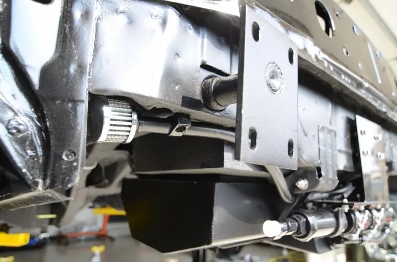

    I got a little more done on the car. Installed the tank breather line today.
    [​IMG]

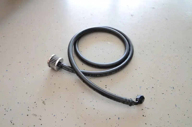

    The idea is that the long hose length will essentially eliminate any fuel vapor smell. Others have done it with success, so I figured I would do pretty much the same thing.
    [​IMG]

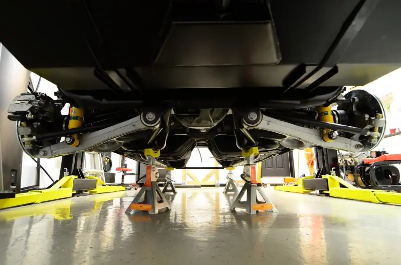

    Boom! IRS installed.
    [​IMG]
    I still have to set it all up for ride height, bumpsteer, camber, etc. That will happen later down the road. Nice to see it on the car though. The fuel lines are a little close to the control arms, so I'll need to simulate suspension travel and check the clearances to make sure nothing is rubbing. I'll also get the brakes all hooked up this weekend hopefully. The car is also terribly unbalanced now. So much to the point that it is nearly teetering on the lift. 3-4 bags of water softener salt on the lower radiator support will fix that.
    KDestroyer likes this.

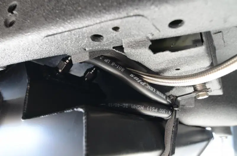

    Got the soft lines installed today. I realized that I forgot to pick up M10x1.0 to 3/8-24 adapters. The hard lines on the Cobras are bubble flares, so the adapter is necessary. I don't know why Ford couldn't just use inverted flares like they did all over the rest of the car. I also had to modify the mounting bracket because of the way I ran my hard lines.
    [​IMG]
    [​IMG]
    [​IMG]
