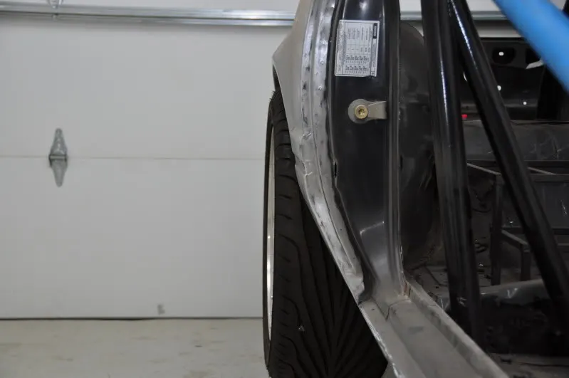

    Widening the wheels won't get you anything. It's back spacing you need. I was just curious if you had room underneath to get a deeper wheel under there that would allow more negative offset.

    Scott, great work....looks interesting.
    You could section the rear quarters and add metal to flarethem out if needed.....not really my cup of tea but Ive seen it in the past.

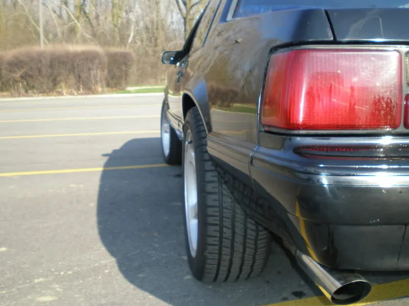

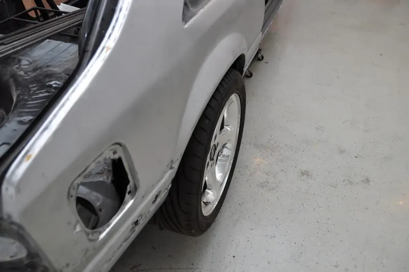

    I figured that if I could get the hubs milled down by a company that widens wheels, I might as well try to get more rubber under the rear while my wheels are at their shop and have them widen them at the same time.
    There is room inside the wheel well for wheels with more negative offset. I like my 01 Cobra's though :mad:. See this thread from Corral. Scroll down to the black coupe. Is it just me or do his wheels not stick out as far?
    http://forums.corral.net/forums/road-racing-auto-x/1042589-fox-irs-99-svt-cobra-wheels.html
  7. Noobz347
    Noobz347 Stangnet Facilities Maint Tech... Er... Janitor Admin Dude
    Joined:
    Jan 5, 1985
    Messages:
    18,311
    Likes Received:
    2,033
    Trophy Points:
    174
    Location:
    Box behind Walmart
    [​IMG]
    [​IMG]
    [​IMG]
    The angles of the pics aren't the same but what I'm seeing is slightly wider rubber and more balooning on our sidewall.
    You got weight on the wheels in any of your pics?
  8. RacEoHolic330
    RacEoHolic330 I like to dress like a pretty girl SN Certified Technician
    Joined:
    Mar 5, 2003
    Messages:
    3,346
    Likes Received:
    487
    Trophy Points:
    123
    Location:
    Allentown, PA
    Good point. These Eagle F1's are pretty meaty for 245/45's. They also have the curb rash guard which may make the sidewalls stick out a little further.
    No load on wheels. The control arms aren't even tightened completely and there is some slop in them. I may need to wait and see what everything looks like on the ground. Having the side skirts and bumper mounted should also help the look.
    I think I'm going to vacate the idea of modifying the fenders. I'll make these wheels work one way or another.

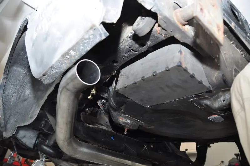

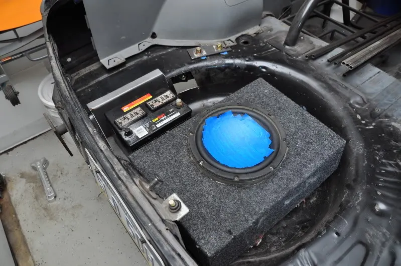

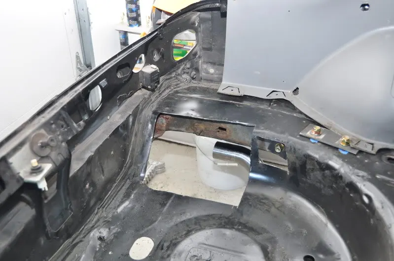

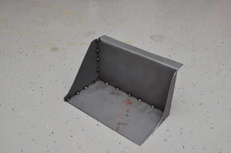

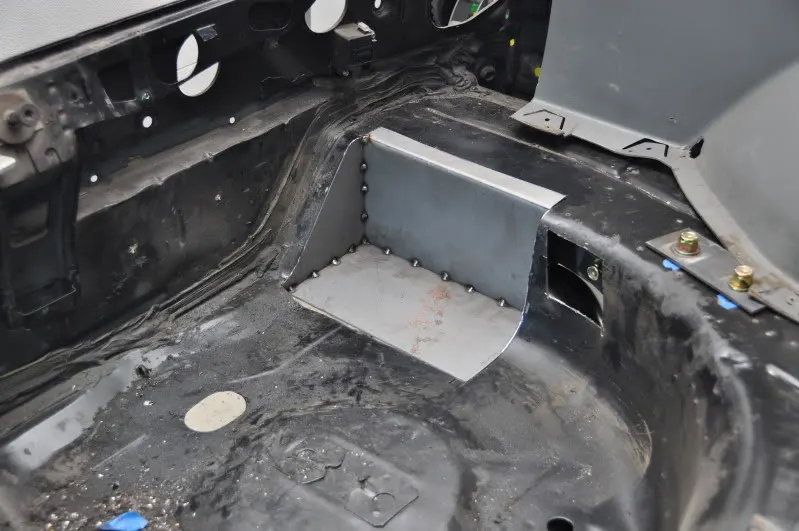

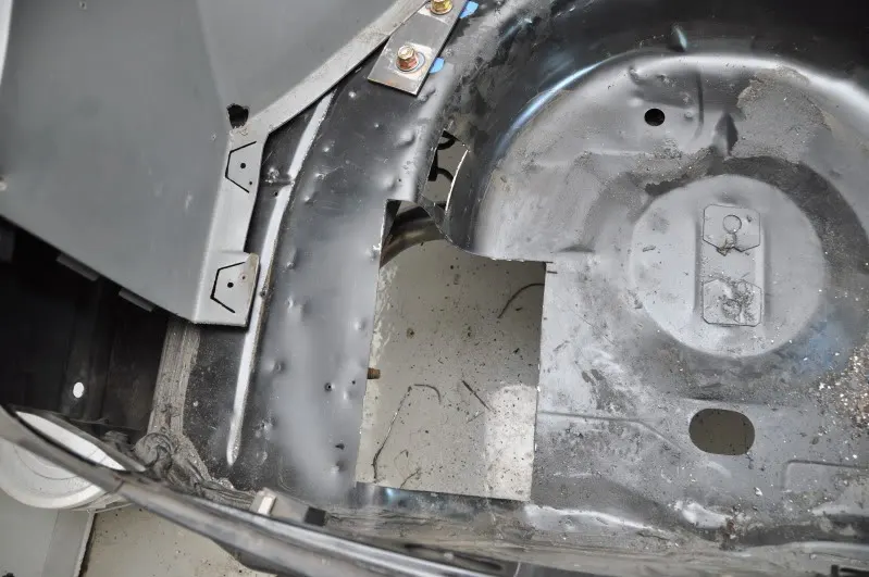

    I figured I'd try to at least get a little bit more work done while I wait for the turbo to show up.
    I wanted to mount the battery in the rear to keep the engine bay clean, but I didn't want it in a huge battery box sitting in the corner of the hatch. Because of my desire to have a subwoofer in the spare tire well, there really isn't enough room to squeeze a battery in there too. While pondering solutions to my dilema, I discovered a void between the driver side spare tire well and the framerail. I've been on a cutting and welding kick lately, so naturally, I did some more cutting and welding...
    Cut the spare tire well to the general width of a car battery:
    [​IMG]
    [​IMG]
    I needed to fabricate a box that would let me cheat the battery closer to the framerail. Here is what I came up with:
    [​IMG]
    Mocked up:
    [​IMG]
    [​IMG]

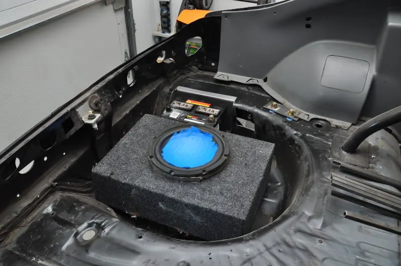

    Here is why I needed to push the battery as far over as I could:
    [​IMG]
    [​IMG]
    I decided that I am NOT going to use that subwoofer/enclosure. It sits too high for my liking. I will have to frame the false floor up very high to hide the speaker and I think doing that will look strange. I'm going to shop around for a shallow-type subwoofer and enclosure that won't sit so high above the floor level in the hatch.
    Any audio guys know of a decent shallow subwoofer and enclosure setup? I still want to drive it with my amplifier. I don't need anything with earth shattering base, just something that will pick up the lows nicely.
    I also need to come up with some way to secure the battery to the floor.

    I really like to look at your work Scott. I know that the end result w/ be very cool. To address your question: I was looking into the very same thing on friday. I can't testify as to how it sounds, but I did work as a rep for the company, and I believe their products to be decent enough to refer. The woofer only needs 2" depth to mount it in.
    [​IMG]

    This thing is exactly the same thing, and can come in a loaded enclosure as well. I just figured that since you are trying to fit it into a round hole, the "square peg" might be a problem. I'd try my hand at building a custom box to fit the well instead.
    Funny that you're moving the battery back, I just moved mine forward. All because the conventional sub/amp enclosure I have behind the seat will have to go when I start putting the rear mount A/C system back there. AND like you, I've become so accustomed to having the bass now, I don't want to lose it.
