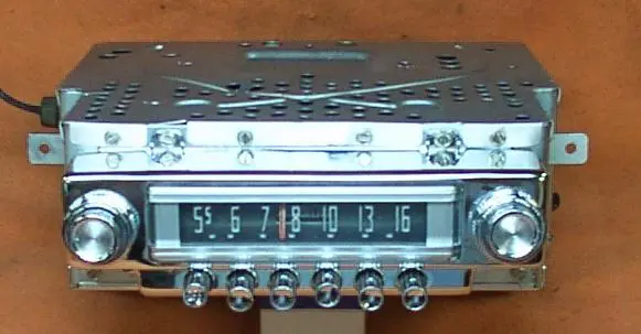

    No radios with digital read-outs, huh? Is this the head unit you have in your car? :eek:

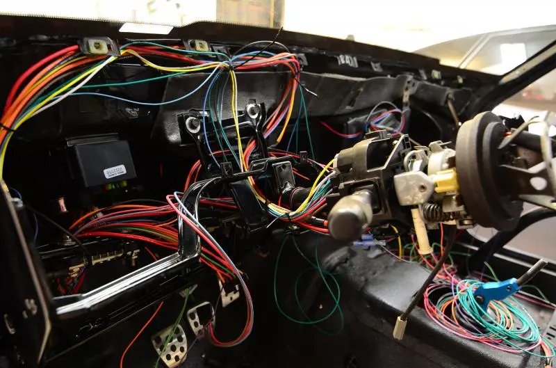

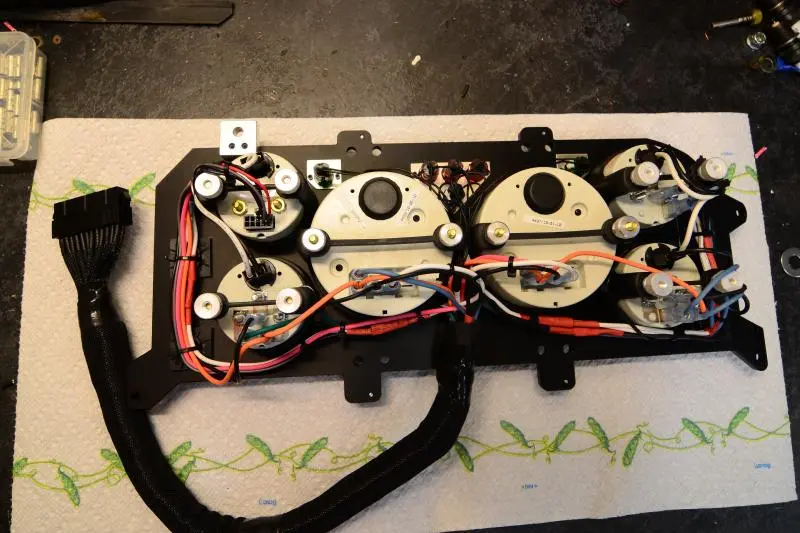

    More wiring progress.

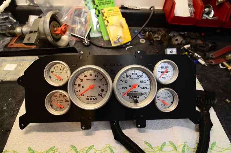

    I built this gauge setup a good 2 years ago when I was preparing to revamp the electrical system on the car. I recently swapped out an oil pressure gauge for a fuel pressure gauge, so I had to make a few changes. It's all done now. The plate is made by MC Machine. I had to search high and low for the 24 pin connector. A quick disconnect was a must. No way would I want to pull apart 20 wires to take the dash out. The other end of the connector is partially wired into the dash harness. I have all the wires labeled on that end.
    [​IMG]
    [​IMG]

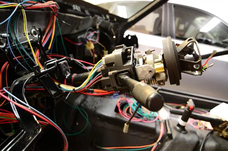

    Got some of the wiring done on the turn signal stalk. I recently decided I will not be running wipers. That will eliminate a good bit of wiring. I can always add the circuit in later if I want to. Oh, the horn works. Woohoo.
    [​IMG]
    [​IMG]

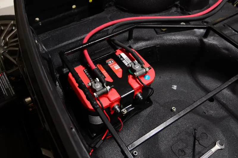

    Here is the battery mounted in the spare tire well. I found an battery tray specific to the Optima battery on a 4x4 off road site. It's bolted to the side and bottom of the spare tire well with a total of 6 bolts, so it's not going anywhere.
    [​IMG]

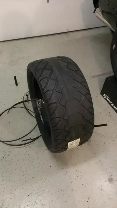

    The new shoes for the rear showed up today. These 275's barely fit in the wheel well thanks to the IRS subframe mount.
    [​IMG]
