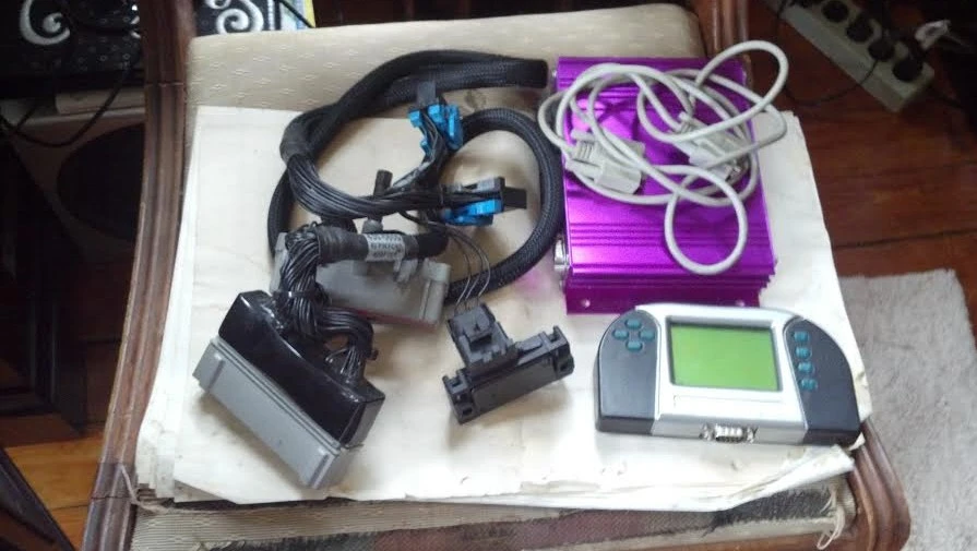

  13. Noobz347
    Noobz347 Stangnet Facilities Maint Tech... Er... Janitor Admin Dude
    Joined:
    Jan 5, 1985
    Messages:
    19,522
    Showcase:
    58
    Albums:
    Likes Received:
    2,372
    Trophy Points:
    174
    @RacEoHolic330
    This is the one I have:
    I don't recall if the Baro was 2 bar or 3 bar. Part number is: 12223861

  15. Noobz347
    Joined:
    Jan 5, 1985
    Messages:
    19,522
    Showcase:
    58
    Albums:
    Likes Received:
    2,372
    Trophy Points:
    174
    Yeah, I get that you didn't ask about the MAP but aren't the injector drivers integrated into the version of the PMS that I have or is it separate altogether?
  16. RacEoHolic330
    RacEoHolic330 I like to dress like a pretty girl SN Certified Technician
    Joined:
    Mar 5, 2003
    Messages:
    3,360
    Likes Received:
    595
    Trophy Points:
    153
    No. They are separate. There is a plug on the side of the PMS that they plug into.
