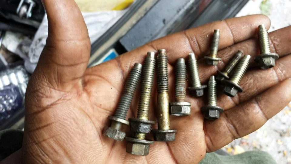

    I looked and can not confirm
    Can I use my stock HO bolts for use with the explorers intake lower?
    I apparently didn't have enough explorer bolts when I went to install it.
    And the studs go into the throttle body right
    Sent from my SPH-L720 using Tapatalk 4
  2. mikestang63
    mikestang63 Mustang Master
    Joined:
    Aug 27, 2012
    Messages:
    4,166
    Likes Received:
    1,213
    Trophy Points:
    154
    Location:
    In the garage
    You'll be fine. We are talking 18-22 ft lbs not head bolts.

  6. Mustang5L5
    Mustang5L5 Car used in adult film "Highway Gangbang-InDaButt"
    SN Certified Technician Founding Member
    Joined:
    Feb 18, 2001
    Messages:
    21,231
    Likes Received:
    386
    Trophy Points:
    124
    Location:
    Massachusetts

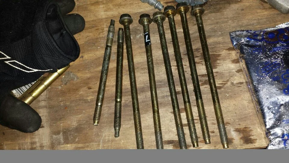

    The upper to lower bolts won't work. You'll need explorer specific bolts for that.
    But you can use your stock lower to block bolts.
  7. 5point0stang88
    5point0stang88 Active Member
    Joined:
    Sep 9, 2011
    Messages:
    194
    Likes Received:
    Trophy Points:
    29
    Thank you I was thinking that too. I have the 6 long ones for that

  9. Mustang5L5
    Joined:
    Feb 18, 2001
    Messages:
    21,231
    Likes Received:
    386
    Trophy Points:
    124
    Location:
    Massachusetts
    Correct. but he showed pics of the upper bolts as well, so wasn't sure if he was including those in his question as well

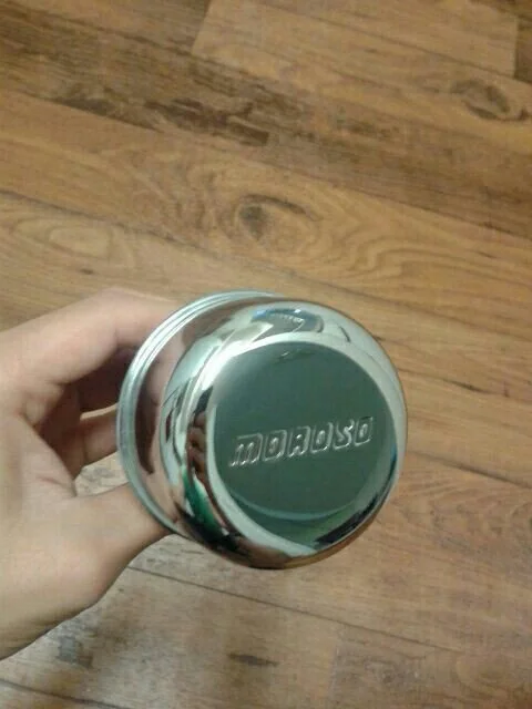

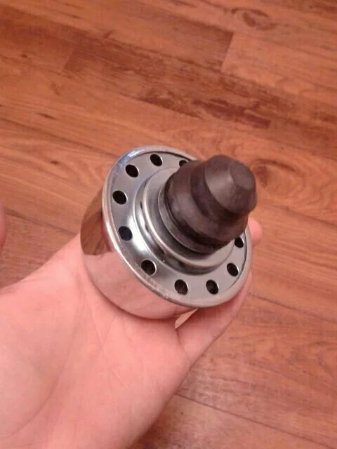

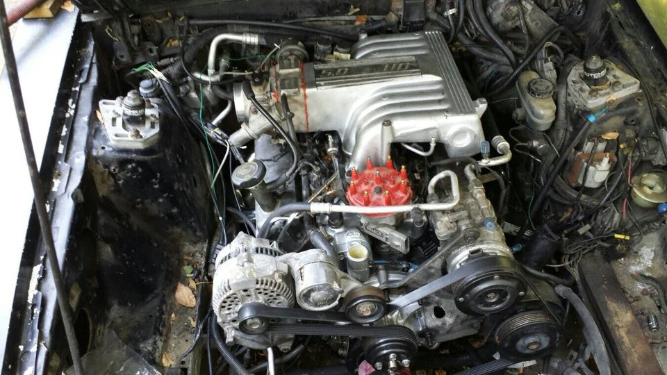

  11. 5point0stang88
    Joined:
    Sep 9, 2011
    Messages:
    194
    Likes Received:
    Trophy Points:
    29

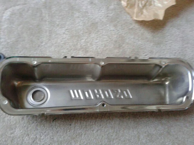

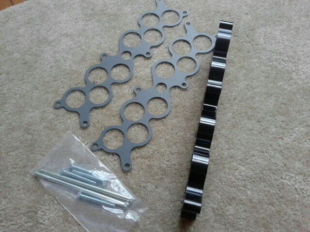

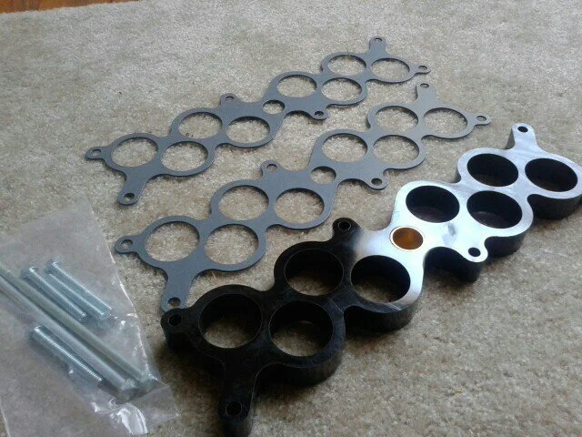

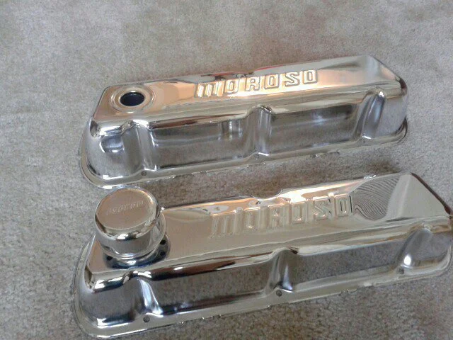

    I'm picking up these. So a spacer will add hp too?
    I doubt these the bolts with that kit will work but I'm guessing it does
    These valve covers look like for efi right? And how would I install a filler neck to it? Thanks guys
    Also I haven't put a bolt in it. But without. The intake barely clears the hood it seems. So now I need a cowl hood
    meby6ere.jpg 8uvebasa.jpg ahe2e6u3.jpg dataqy3a.jpg y7eta4e8.jpg yta7are8.jpg
  12. mikestang63
    Joined:
    Aug 27, 2012
    Messages:
    4,166
    Likes Received:
    1,213
    Trophy Points:
    154
    Location:
    In the garage
    LOL,, looks like you already have a 1" spacer... hence the hood clearance issue. Those VC look like carb ones. No Baffle plate and no provision for the tube to the throtthle body.
  13. 5point0stang88
    Joined:
    Sep 9, 2011
    Messages:
    194
    Likes Received:
    Trophy Points:
    29
    Lol right it's ridiculous the clearance and that's with no gasket . I was thinking those are carb thank you

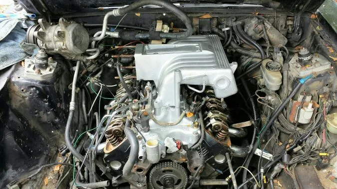

    I got the stock ones to clear. Just beat down the baffle
    Gonna crank tomorrow
