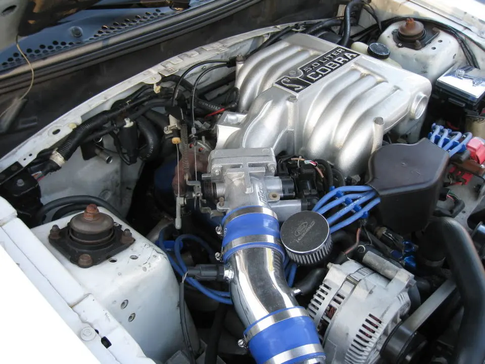

  3. That's a nice, clean engine bay but how do you cope on those hot, humid Florida summer days? I live in a desert climate where it gets up to 120*F in the summer so I'd die without the AC. :lol:
