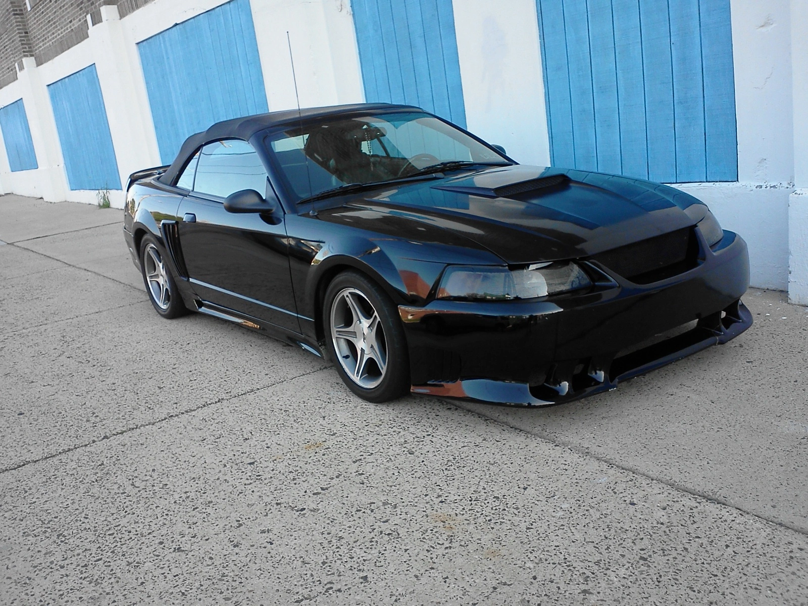

  16. This is my stang

  17. very nice, take care of it it will take care of you. mine is a 96 & has 1/4 million miles and runs excellent. but i dont go fast all the time, only about half the time i drive it. lol
