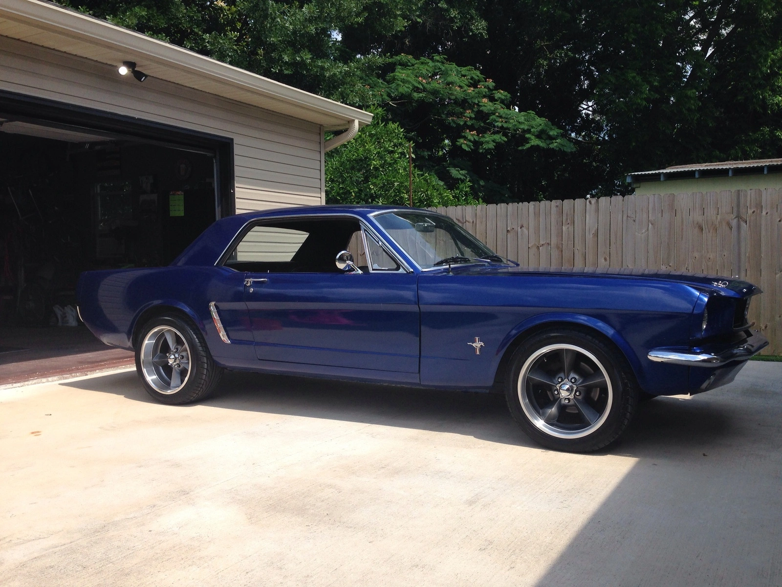

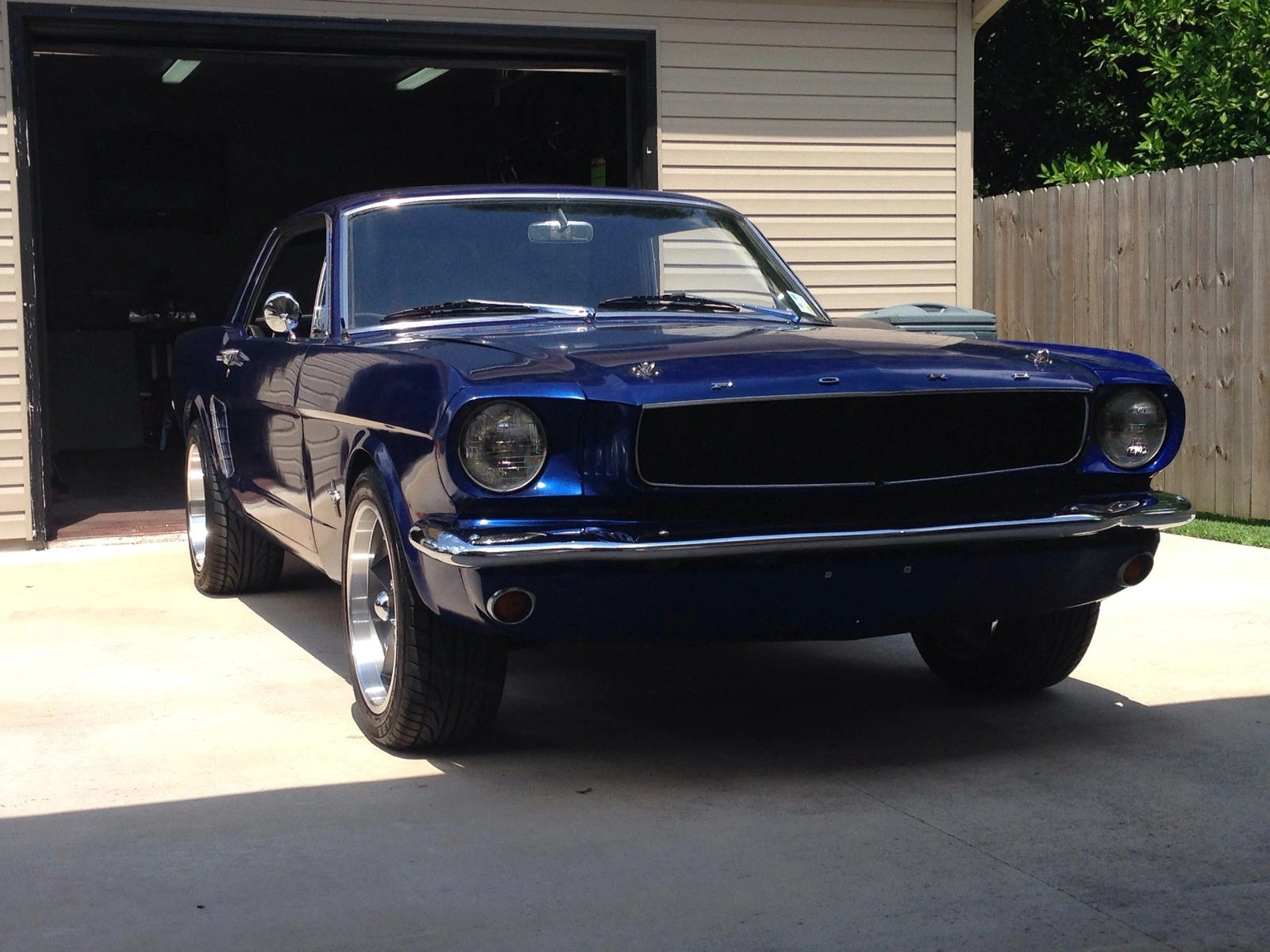

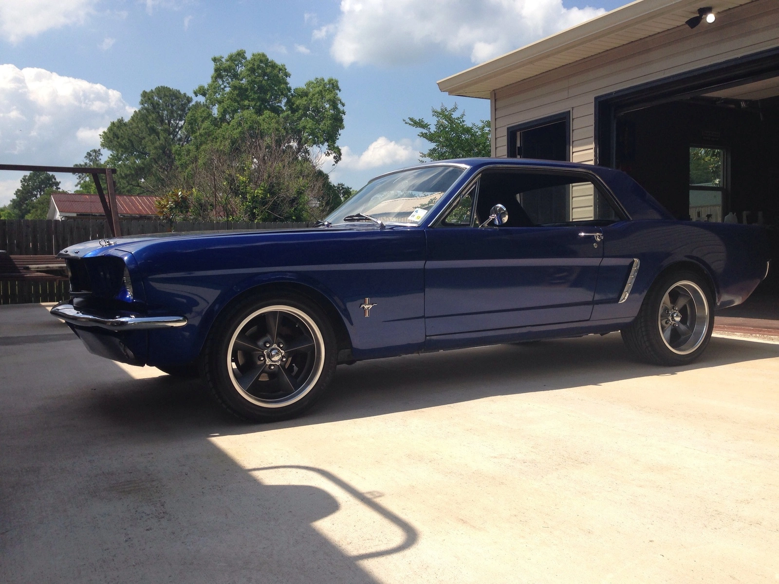

  7. ok so i installed the grab a trak kit and the car sits pretty good in my opionion but the passenger side of the car sits between 3/8" - 1/2" higher than the other side does, what should i do to remedy this?
  8. Twist spring around to diff position. I have to do that on my 68 C-10. It leveled it out one I hit the sweet spot.
  9. Any pictures? I have the 4.5 mid eyes from GAT and 620 coils plus the shelby drop. No motor in yet but I'm curious to how it will sit when done. Like to see yours.
  10. I'm changing the water pump right now but I'll take a pic once I get it on the ground in a few

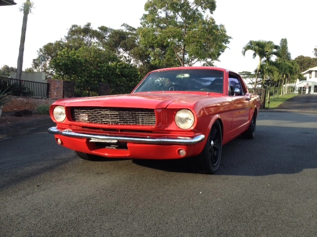

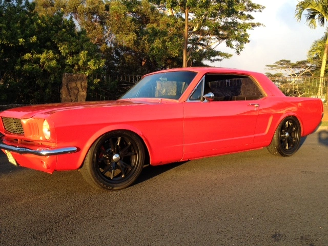

    Car sits 4" lowered All-around with cut Front Coils and de-arched Maier Leaf Springs with 1" lowering blocks and Koni Shocks ---- No Fender Rub...
  12. What size rimes are you running? And back space on them
  13. 17" x 7" American Racing "Daytona" with standard backset... I plan to order "Wider" rims for the rear because I have a good 3 1/2" clearance .
