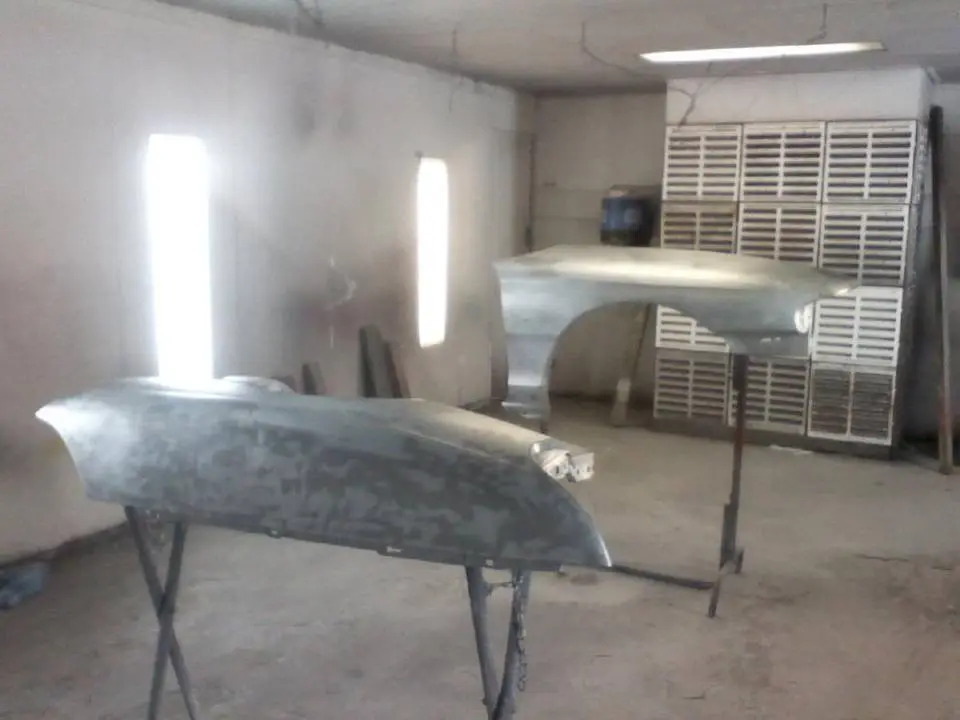

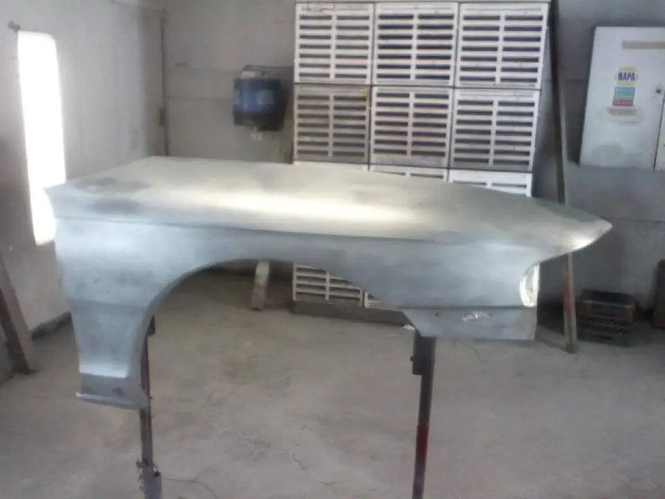

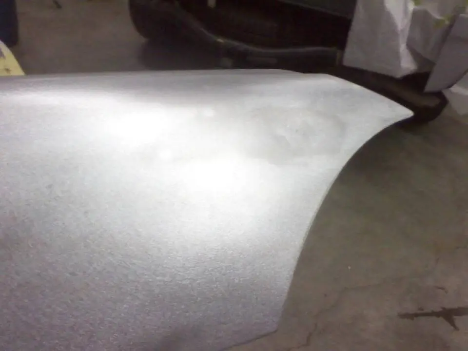

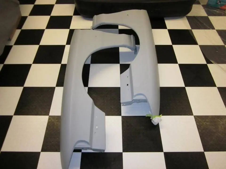

    Next up getting the front fenders squared away first. Stripped down to metal with the DA. Antenna hole welded up. Cleaned with prep sol and scuff pads, ready to put some material on.
    Then two coats of SPI Epoxy Primer. IMHO this is the best stuff on the market for sealing bare metal.

    Southern Polyurethanes Inc.
    This is the best DTM primer I have found. Will also be using their high build primer.

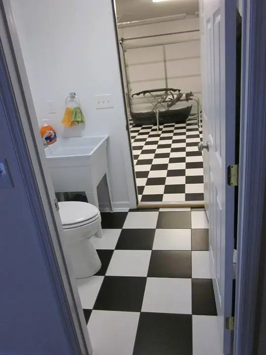

  5. I do the same thing with my floor jack. I love all the different designs they offer. Do you have a picture of your floor?
    I went with the white and black because I wanted to match the mud room entrance tile to the garage floor.

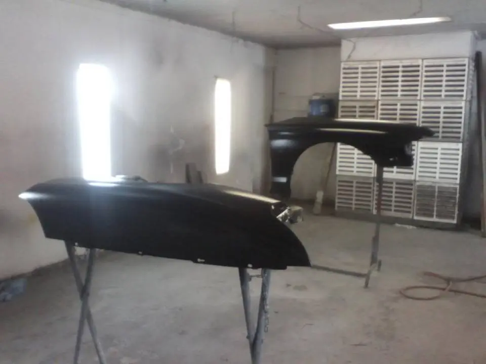

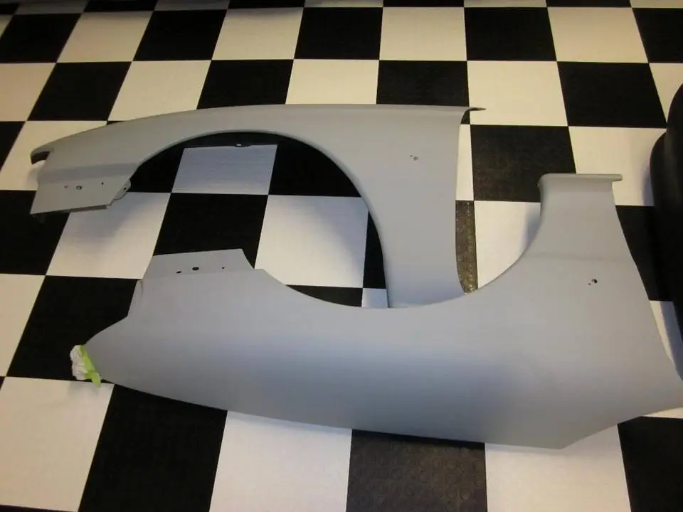

    Here are the fenders after blocking and priming with the high build, one more round of blocking and their ready to spray.

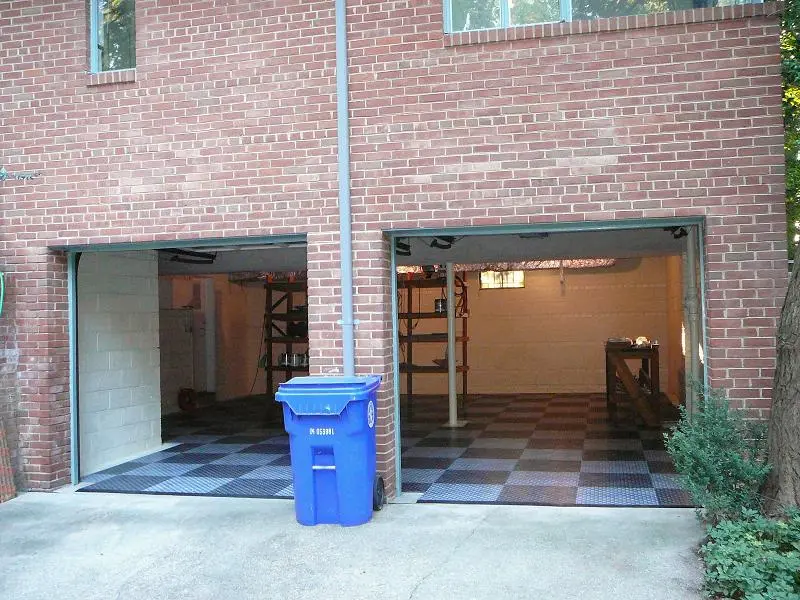

    here is one from before we moved in ... looking at it again, it is more like charcoal and silver.
    it's kinda boring ... 4x4 squares. i could have gotten creative and done a design, but we just wanted to get it down and move in. but that's the cool thing about the tiles, you can re-arrange them whenever you feel like it.
    when we moved in, we downsized, so a whole lot of stuff ended up in there. we got rid of alot of it, and i have the rest over on one side now so at least i can get the fairlane in and have started carving out a space for my work area. i am hoping to clear out as much as possible and actually be organized. it's alot of work! no pics of it now because it is too embarassing :nonono:
  9. Garage floor looks great! I like the charcoal look. The great thing about Racedeck is how easy it is to take apart and put back together. No body believes me when I tell them that my 7 year old put down most of my floor.:shrug:

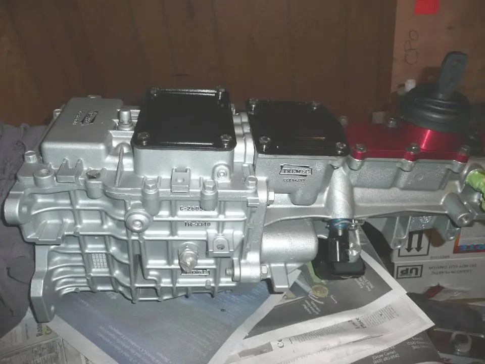

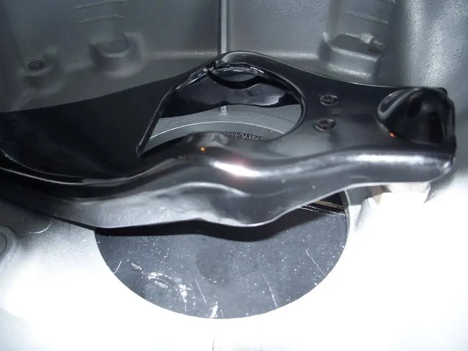

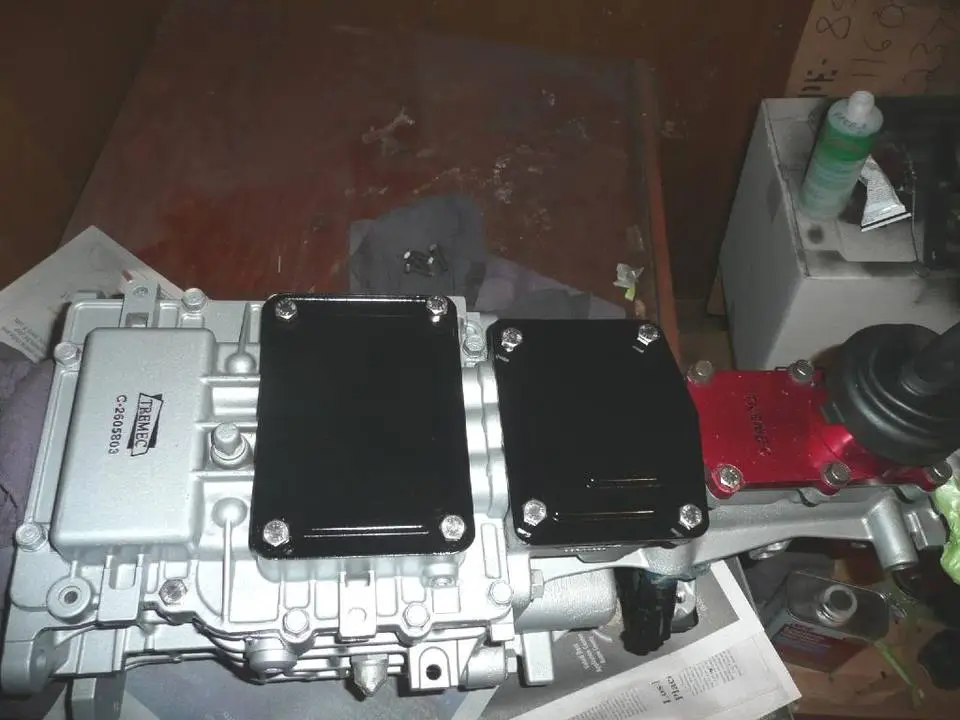

    This is the Tremec TKO500 out of my old car, a lot of elbow grease and time.
    Notice the boot on the trans did not even get touched by the fire or heat.

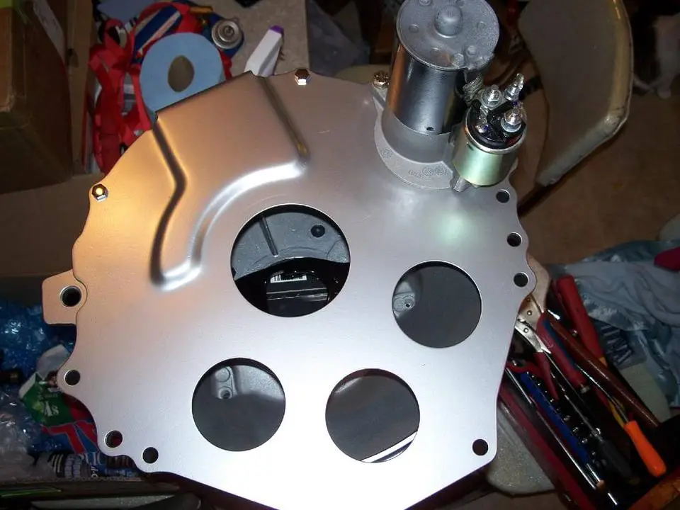

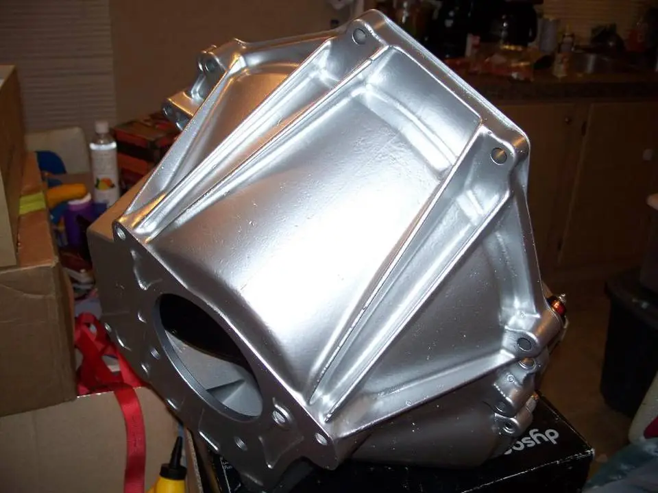

    Blasted and powdered the old bellhousing, block plate, clutch fork at the same time. All these parts turned out better the second time around.
