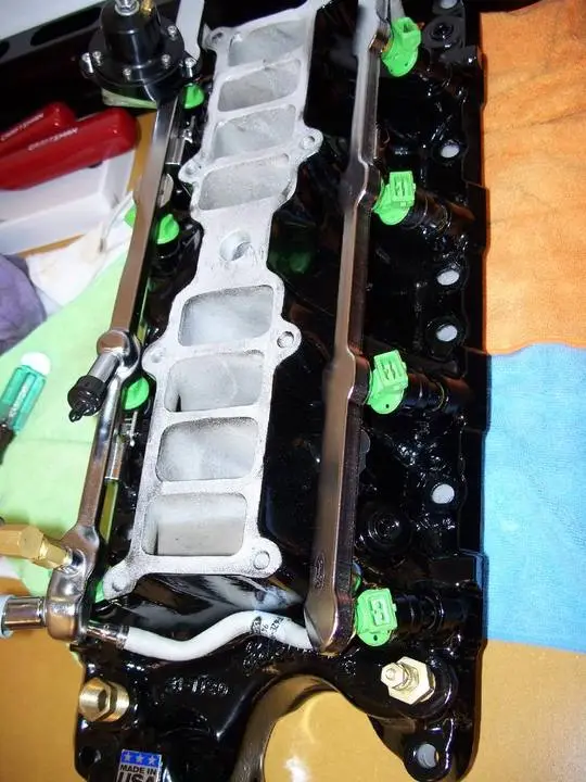

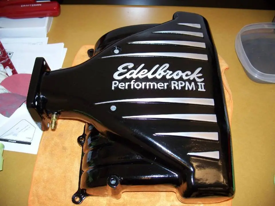

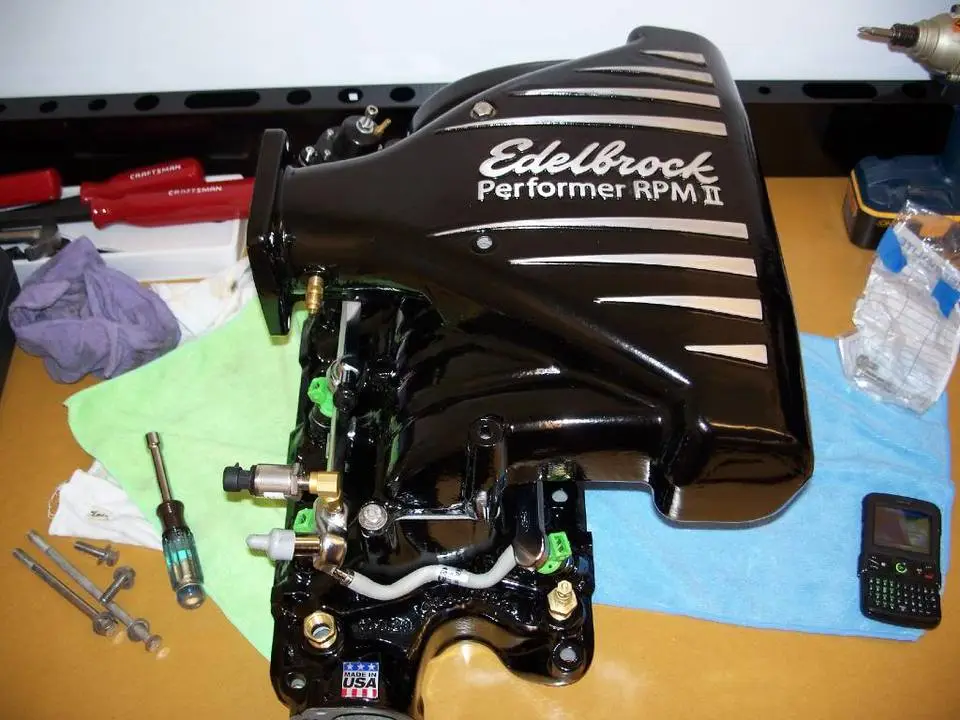

  5. Moving to January. I am going to be using Edelbrock Victor Jr. aluminum heads that have been well worked for this engine. I was able to trade for Performer II intake. Here are the finished pics after powdercoating it gloss black, and then hand polishing the letters and fins to give it a machined look. I like it much better than the old one.
    I also smoothed the casting out with a grinder prior to coating to give it a little slicker look

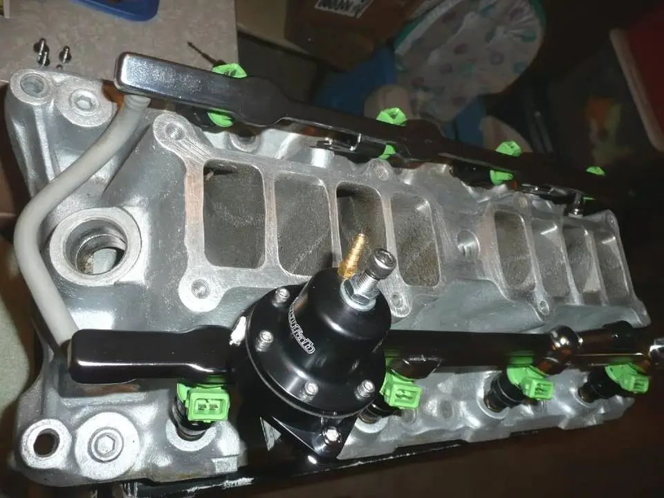

    Put together

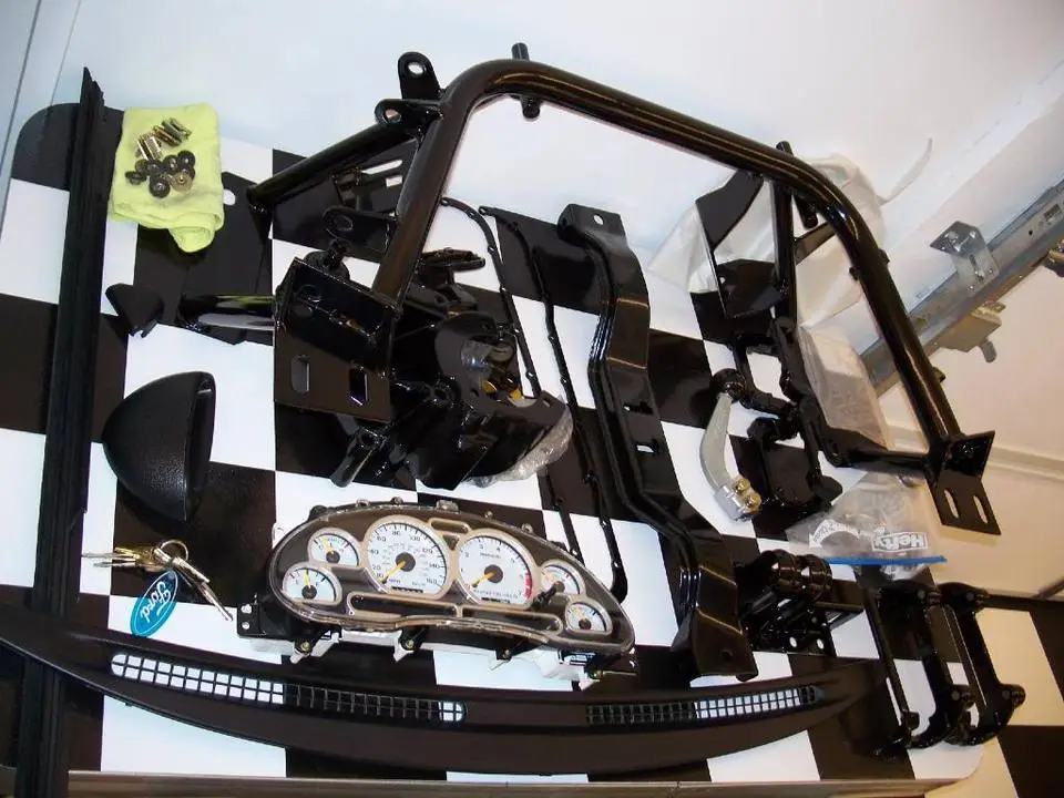

  6. Next up was more parts off my old car.
    Everything except of course the interior parts, they were just laying on the table. Everything else was powdercoated.

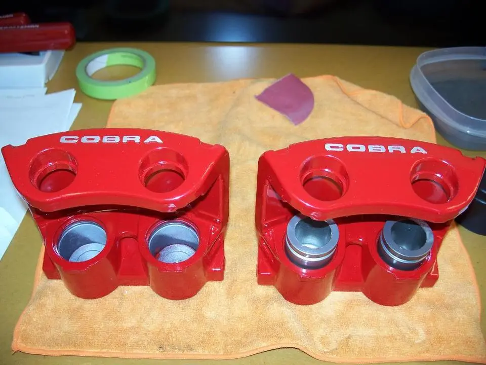

    Then I disassembled the old brake calipers and tried out the red high temp powder.

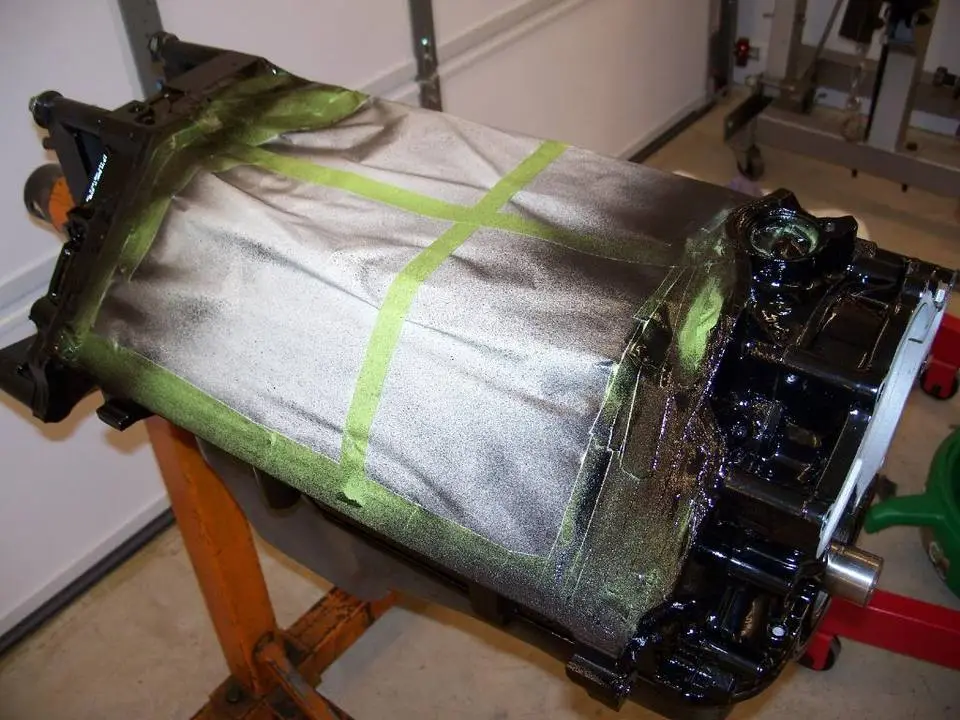

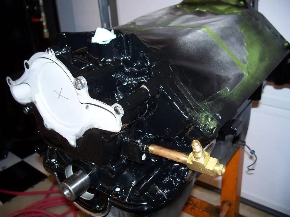

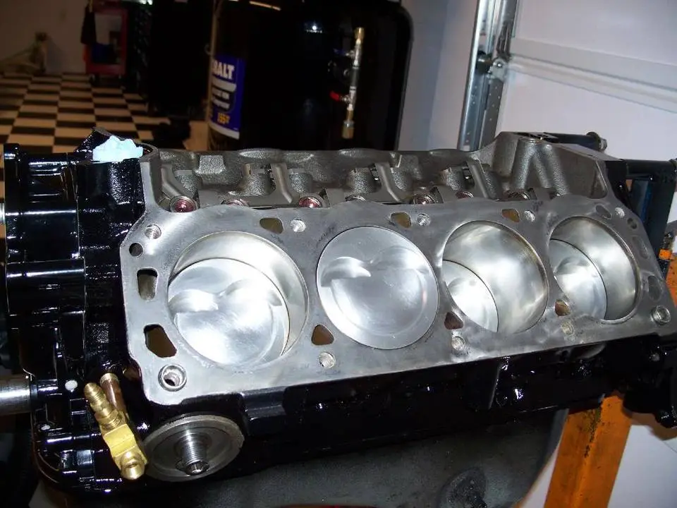

  11. Well here is the 331 forged stroker engine that's going into the 94 Cobra. This is after stripping, wire brushing, sanding, cleaning, and spraying base/clear.
    I am using a Comp Cams Nitrous HP Camshafts Part# 35-556-8 along with Edelbrock aluminum victor Jr. Heads.

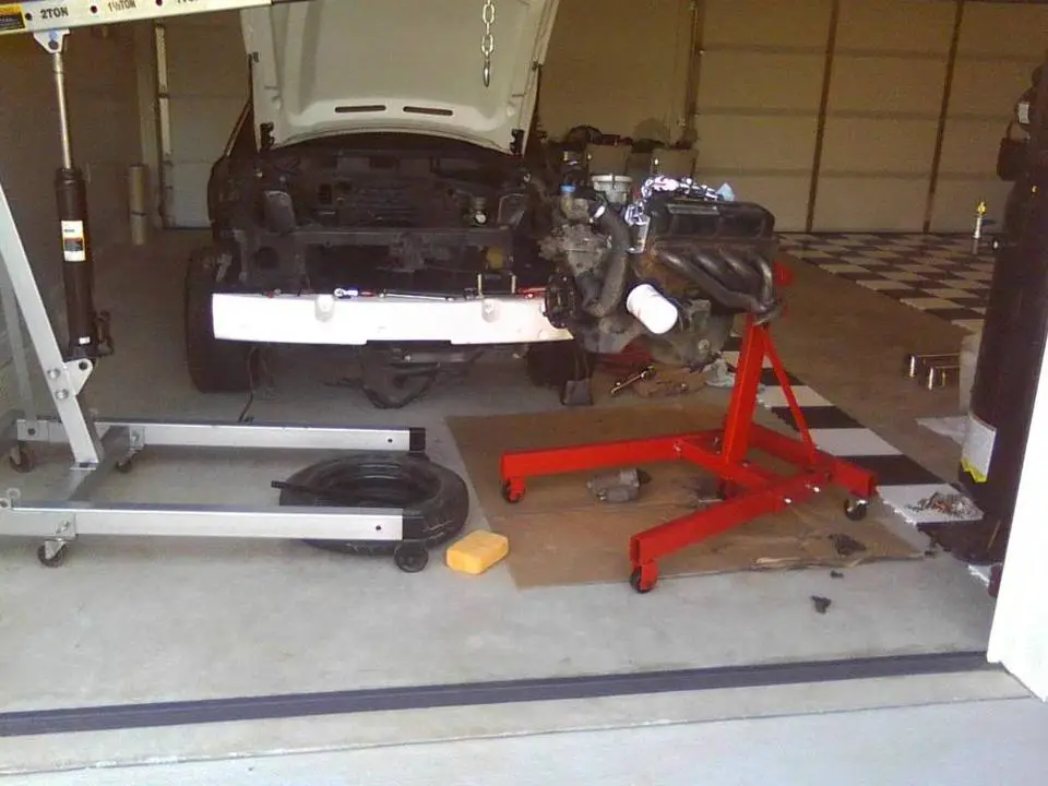

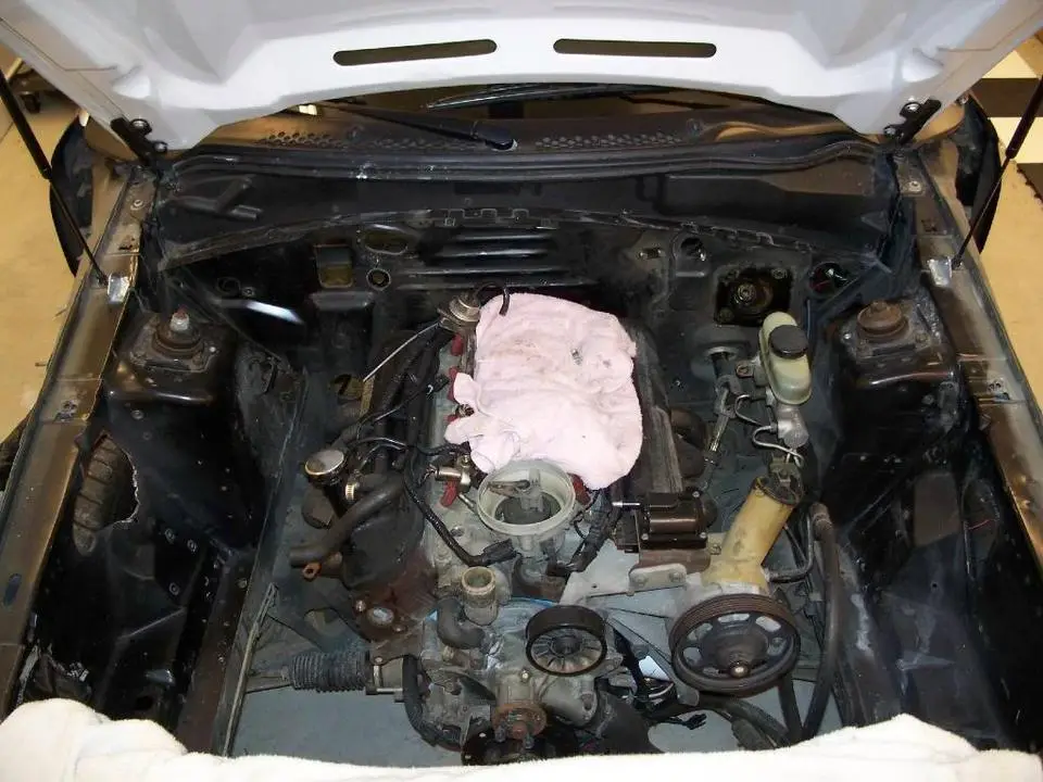

    Next up it was time to pull out the stock cobra motor and 5 speed.

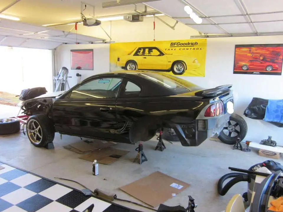

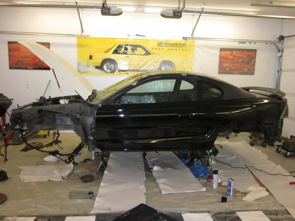

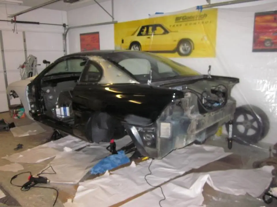

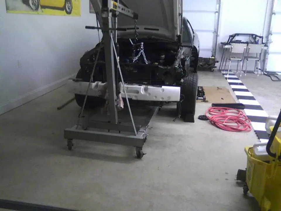

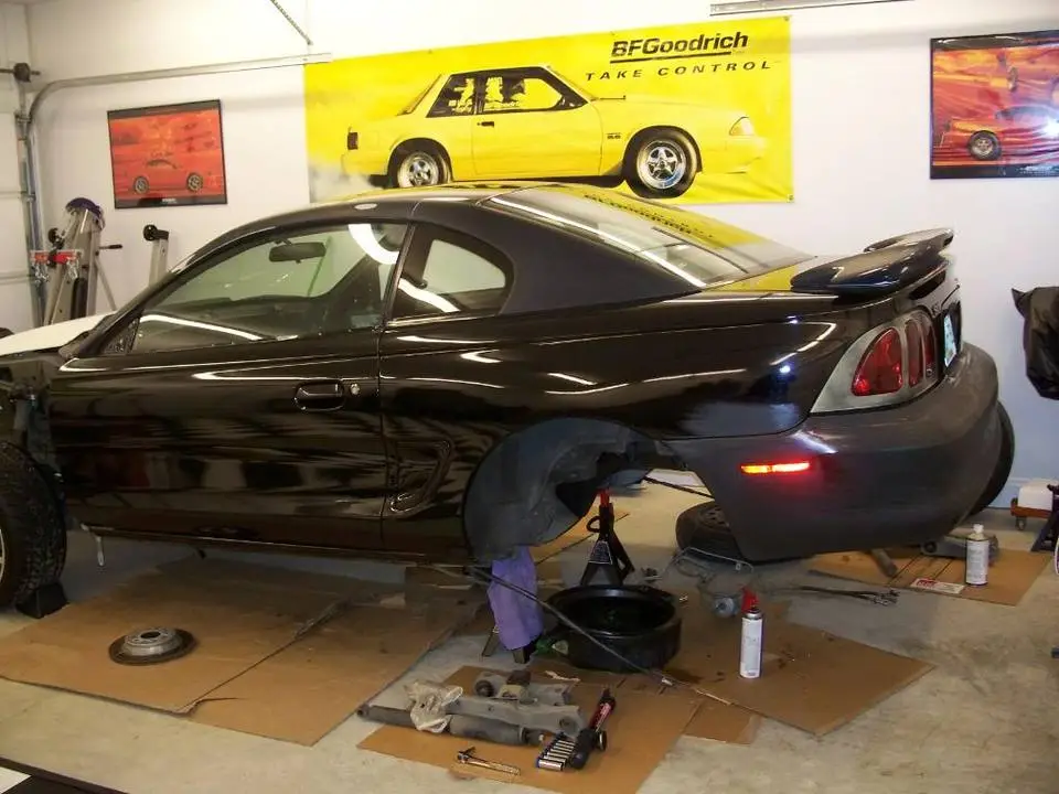

  20. Next up on the project, it was time to go ahead and get this car striped down.
    Rear end out
    Rear bumper off
    Front suspension removed
    Trunk lid, tail lights bumper bar and Driver door off.

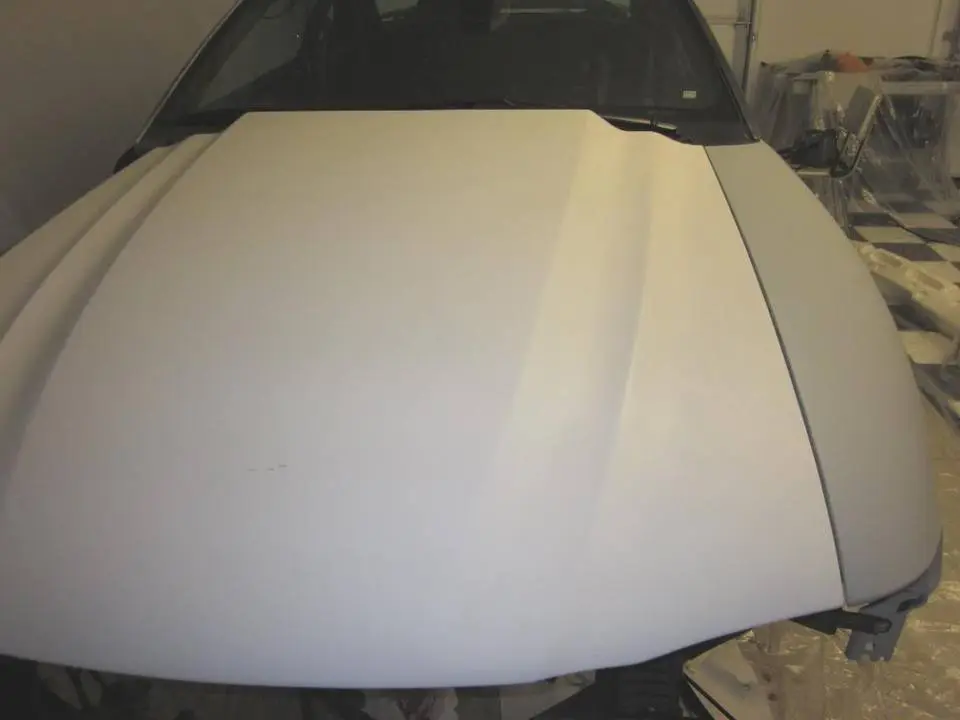

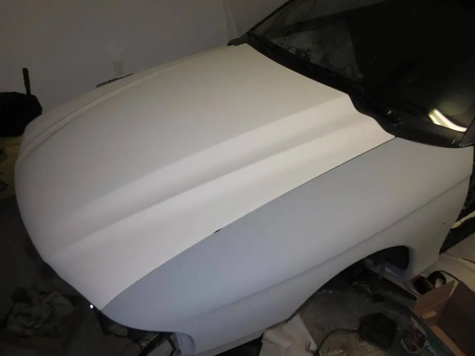

    With all that taking apart, I had to put something back on. Quick fender hood gap check.
