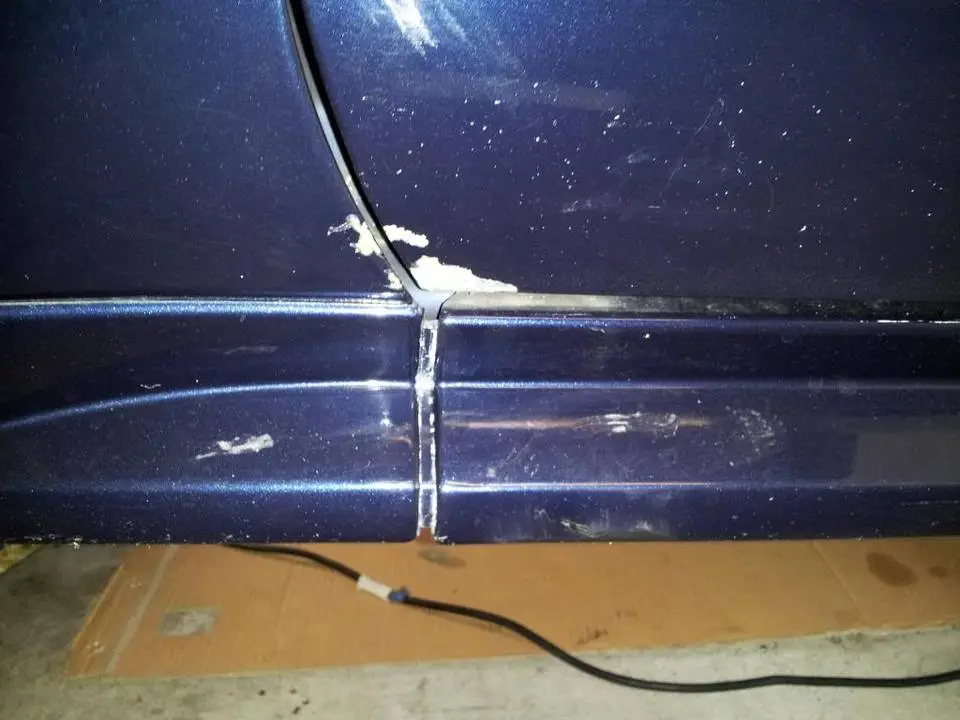

    Ok I ordered a new cable and quadrant for my car today. After taking it to my friends he felt it was the culprit like yall did. Sorry I was hesitant to follow yalls advice earlier but im just trying to get this right. Also on another note the car recieved some damage from the dealership I took it too. Ill post a picture later I doubt they will do anything about it. Super ****ed

    Well I am happy to report that my car works now, thanks for the help everybody! I called the dealership and spoke to the service manager and told him that I fixed it and that he needs to get his crew to actually check cars out instead of trying to scam people for bogus repairs and that they need to handle cars a lot better. The jerkoff said that the car will be out of spec and unable to drive again in a month. After he said that I was floored and called the manager of the dealership and chewed them out for having someone talk to a customer like that and not properly asses what was wrong with the car. Im not sure what to do at this point, the manager is supposed to call me back. I know I am going to ask for a refund for the diagnosis but I really want the dip****s to pay for the damages on my car. A local paint and body shop qouted me 250 dollars to fix it.
